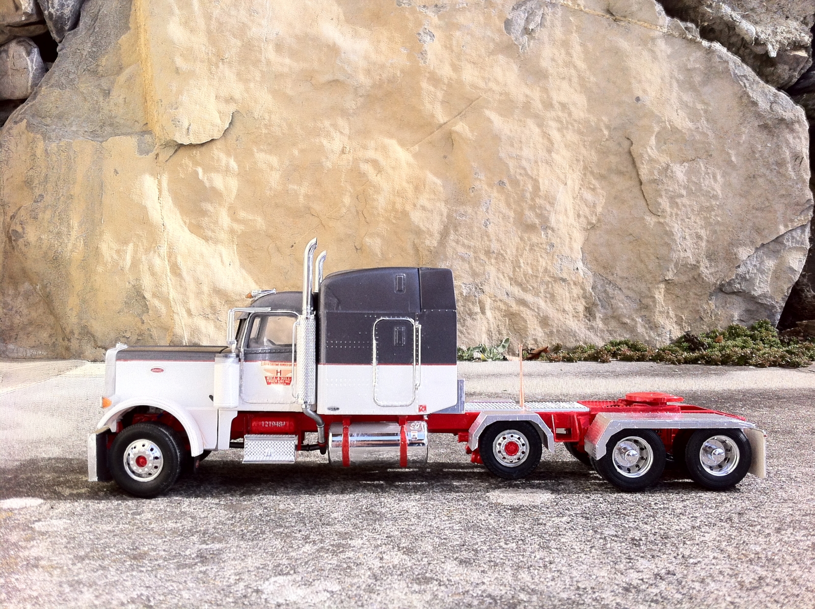

On request: building a Peterbilt 379
And here's the finished result of my work. With the license plate and IFTA decals on, and outside pictures in decent weather, I think I can call this truck done. All that's left is the Build-Off judging itself...
The Beast is done! In the last week I finished up on the big Peterbilt, scratchbuilding a deep bumper and adapting the rear fenders. If you look closely, you can recognise the fenders from the Revell of Germany "Canadian Hauler" kit in them. Also the mirrors are one, as well as the license plates. IFTA decals on as well. Now only I have to wait for decent weather to make outside pics; at the moment nature's not really cooperating...
