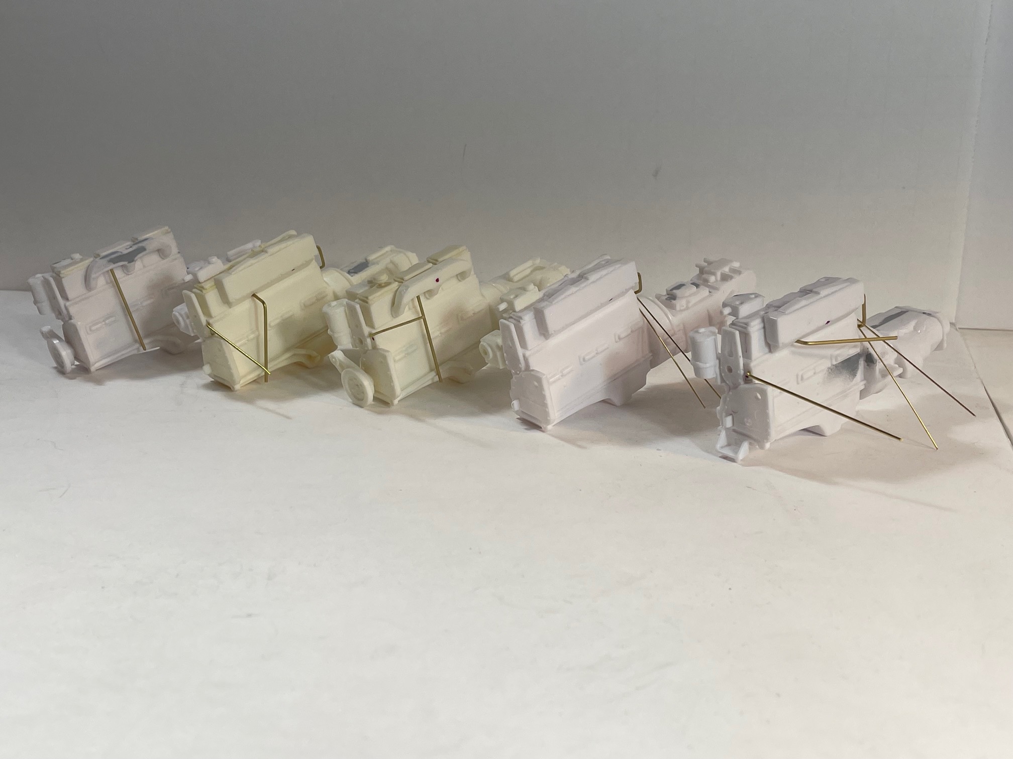

This will be an experiment.  5 kits will be built.  Some of the mundane assembly and painting will be "production-lined" to save time with set-up and clean-up.
I will try new things and test the limit of my skills.  Failure is learning.  One (or more) of the kits will probably be sacrificed and end up in the junkyard.
I will try different paint schemes.   It will also allow me to choose the "best of _____ part" for a showroom build.

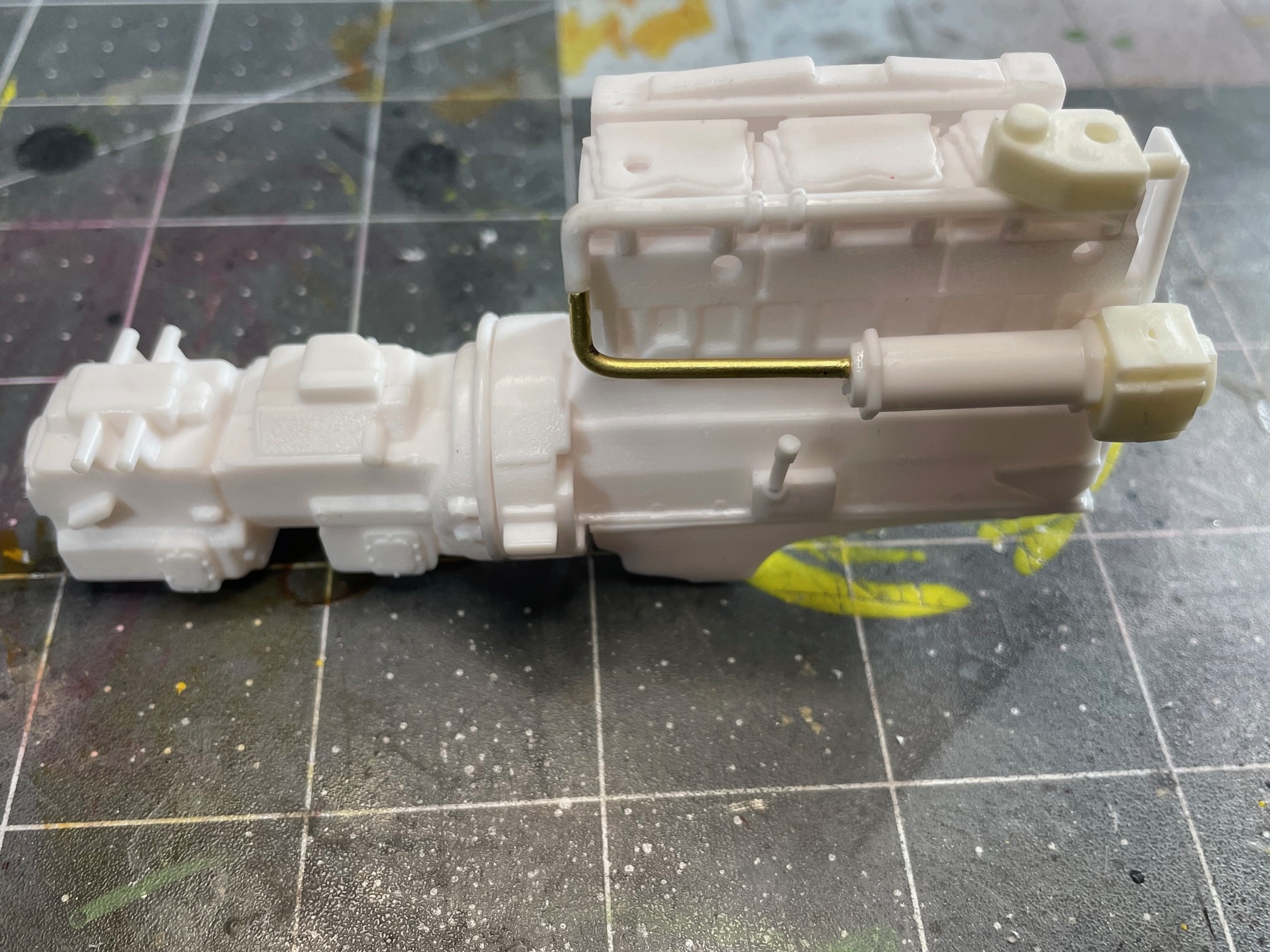

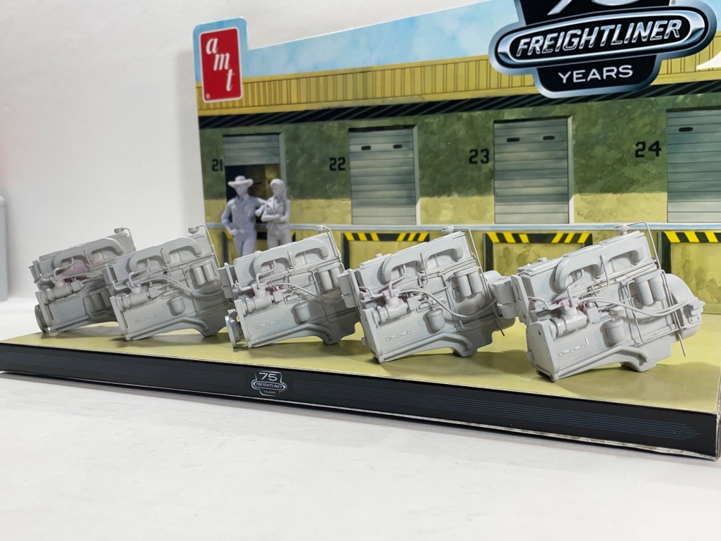

At the Cummins factory, holes are drilled for brass rod.
 It will be nice to not have to relearn every step.IMG_2844.thumb.jpg.e6a5566a008b4d6556940809b4966873.jpg

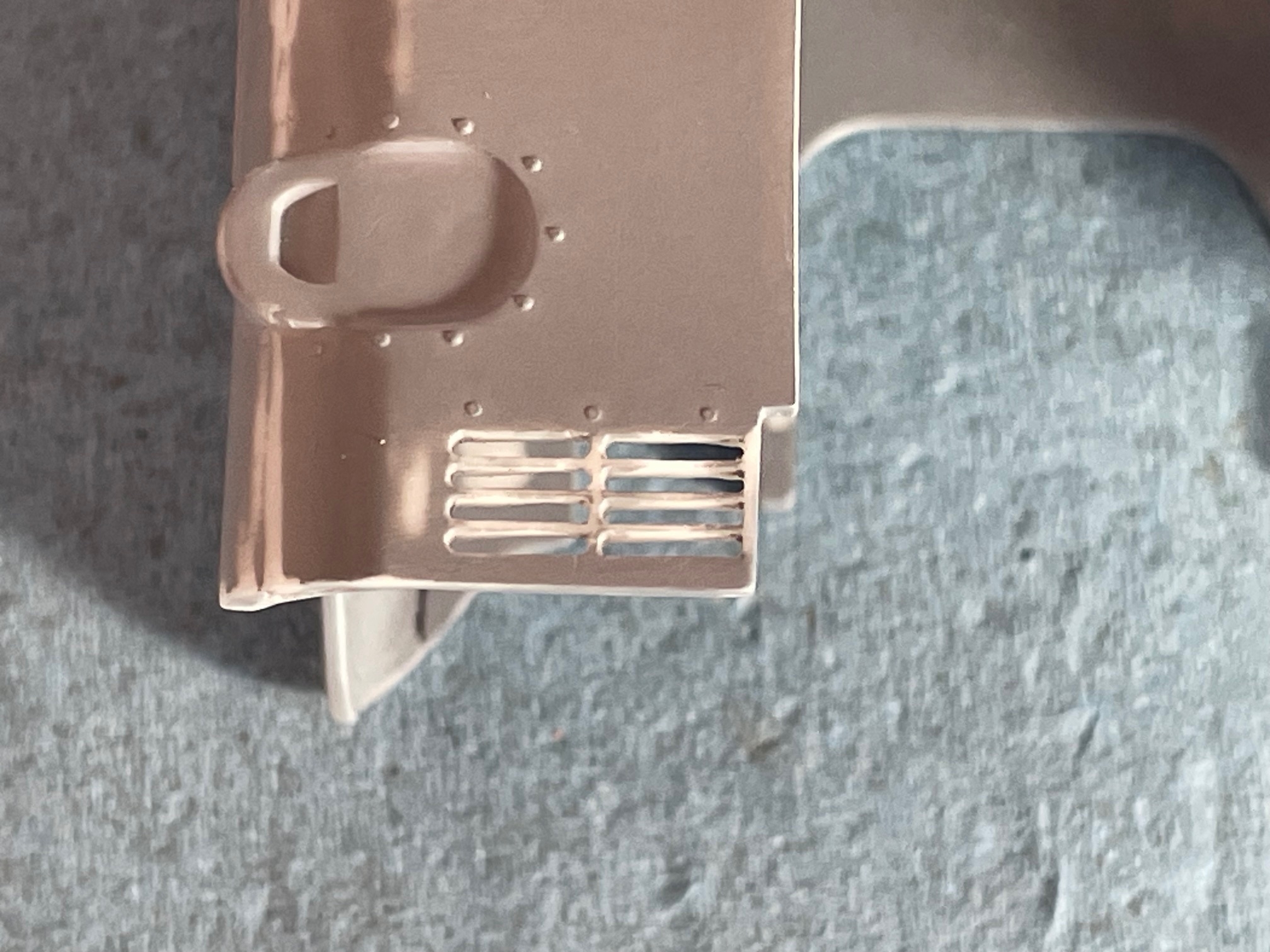

"The Seem"

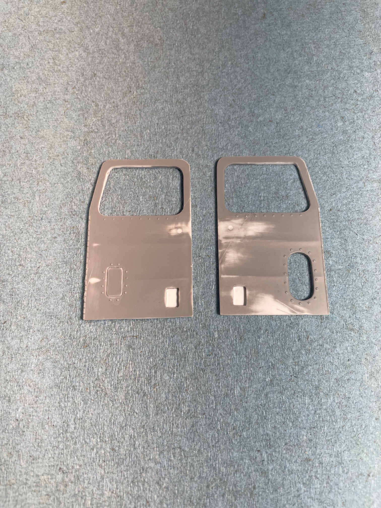

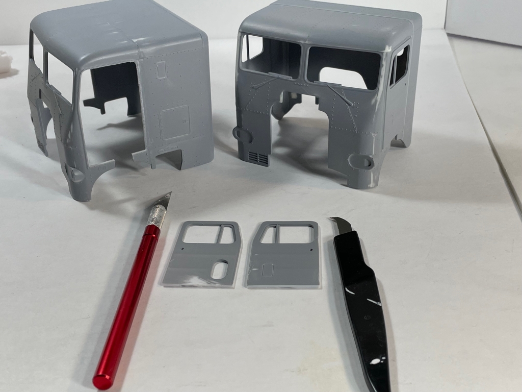

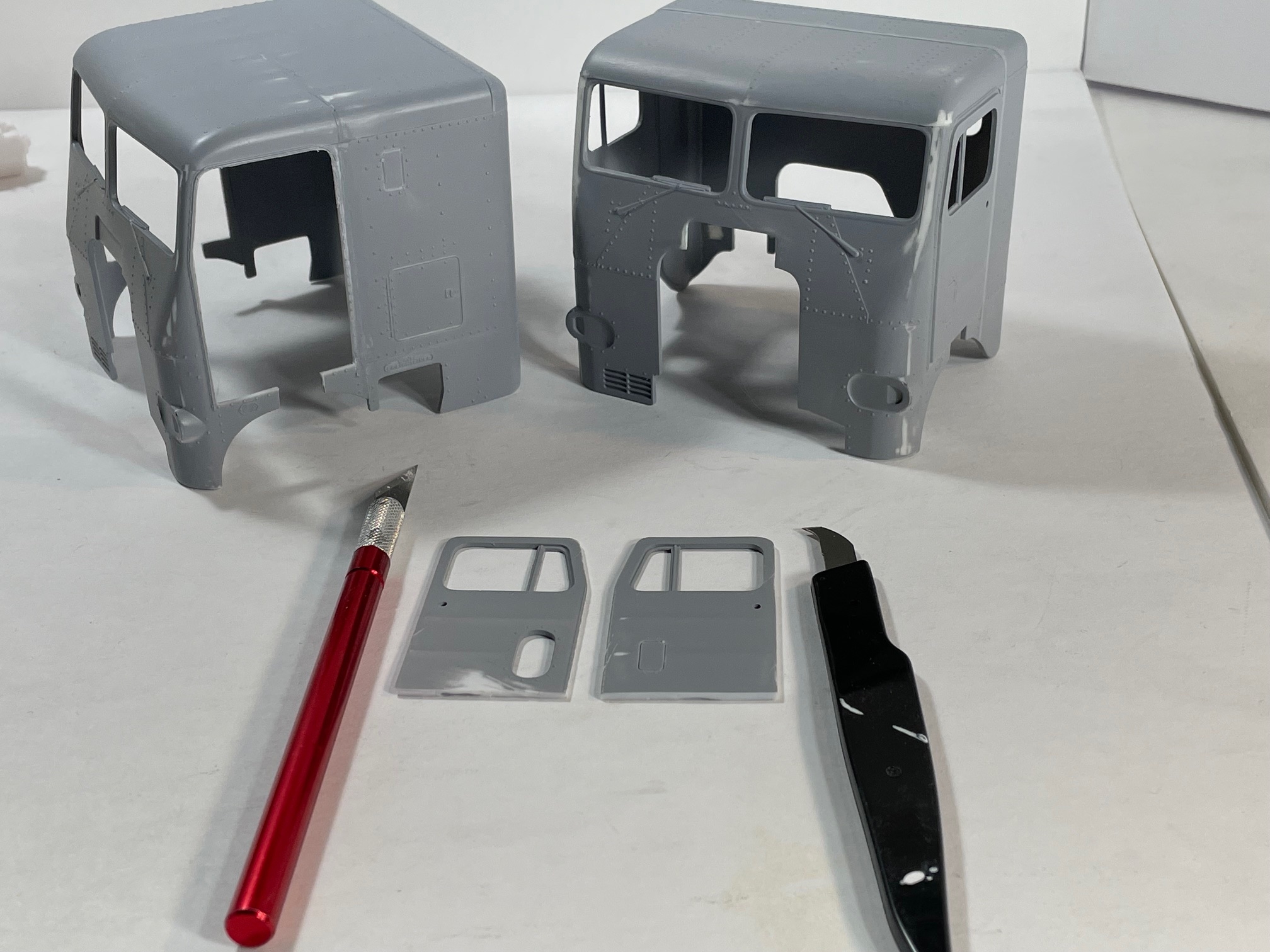

First attempt at cutting out the doors was done with an X-Acto knife (an impossible task).
The panel scriber worked much better (but still required an insane amount of patience - be prepared to take your time).

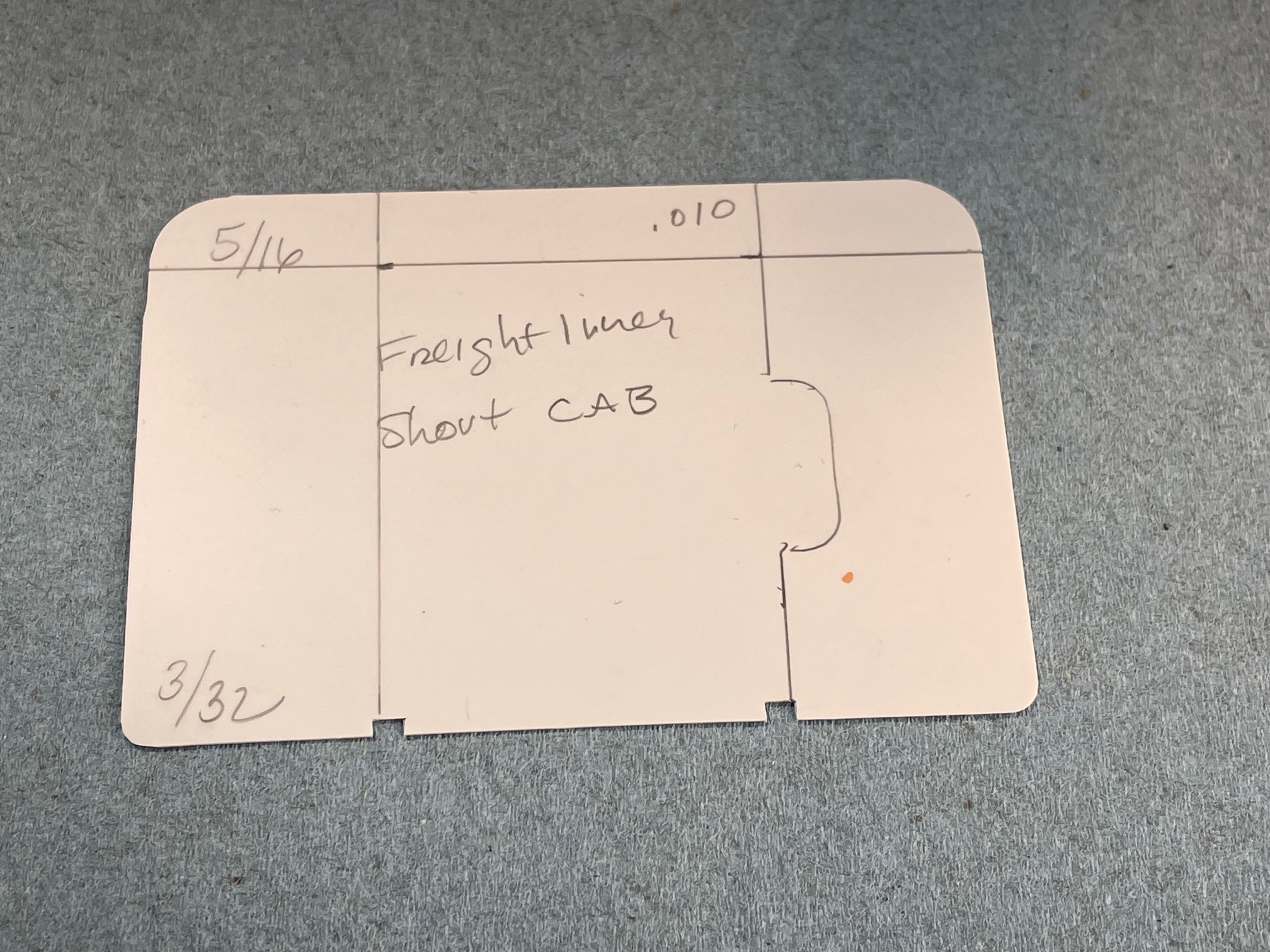

A template of the floor  is made for quick fabrication in the future.

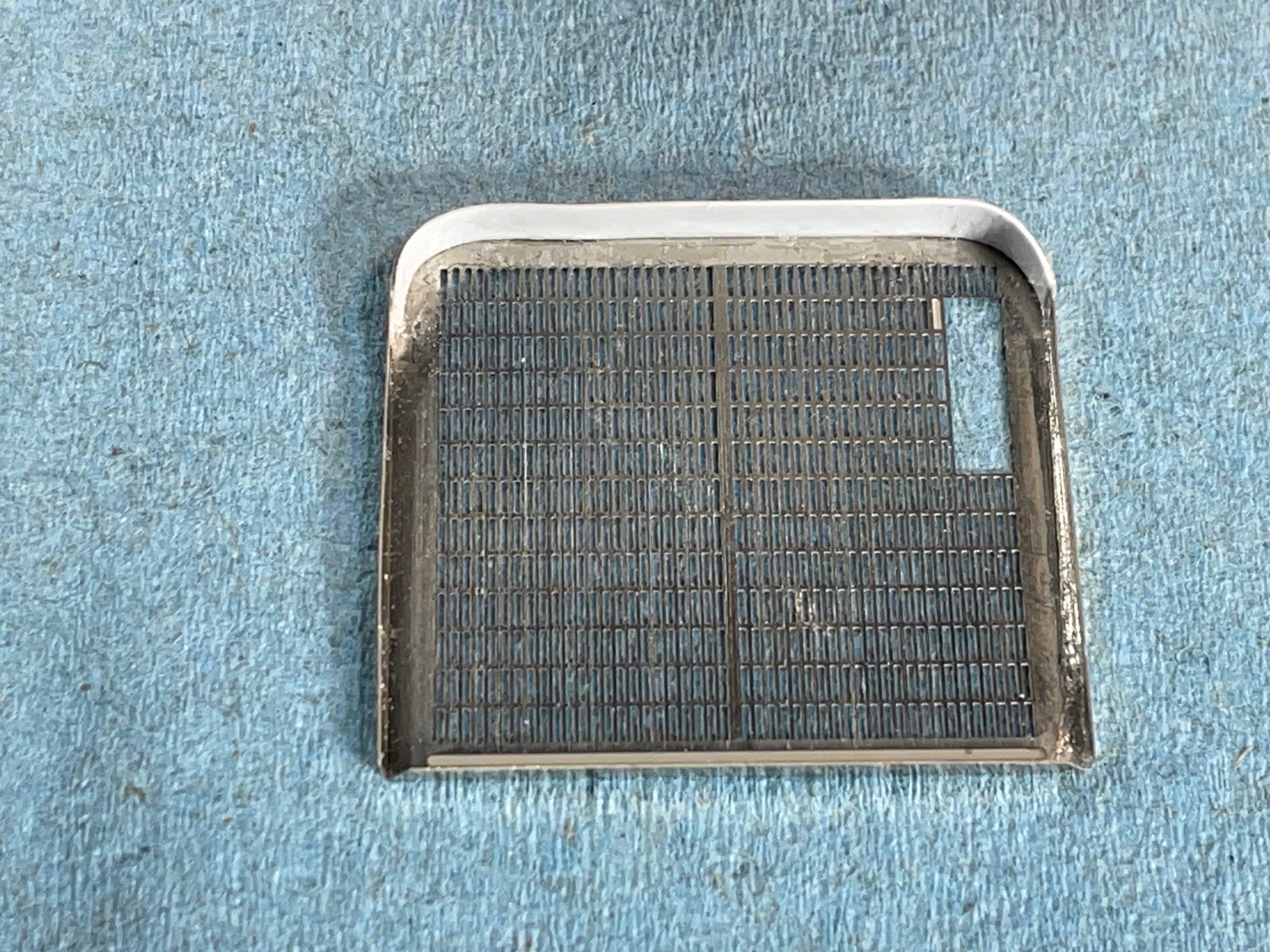

It was much easier and quicker to use the PE part above than cutting out the grill detail on this cab.
This  experience will certainly make me think twice before trying to  do a whole radiator.

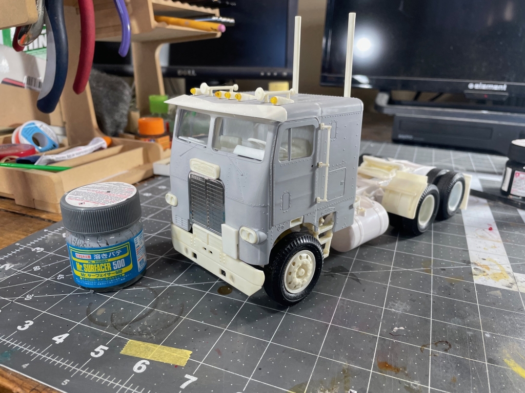

The third window is added to a short cab.  PE window gaskets applied.IMG_2981.thumb.jpg.d8e6ad84d664d4e6d7dd14bc4ebe2e6a.jpg

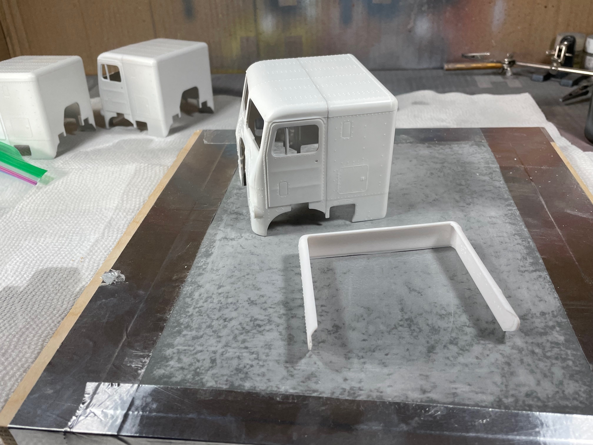

Using a sanding sheet taped to a flat surface greatly improved the problematic cab seam.

IMO, whatever method or material  is used, it needs to be easy and easy to sand.   For small gaps, I did not like using filler putty.

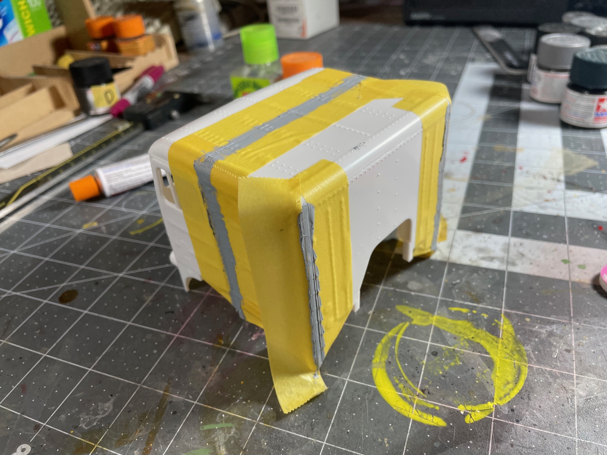

As illustrated above:  I sanded the seam on a large flat surface such as a piece of glass or MDF board.
To protect as much detail as possible, I taped closely to the cab seam and filled in MrHobby-MrSurfacer 500 primer with a brush.
Used as many coats as needed (it took a few).  Dry completely.
Initial sanding is before the tape is removed, then a careful final sanding.
Use tape to protect details while sanding.   Then primed with MrSurfacer 1000 or 1500 by air-brush or aerosol can.
Since I have not  applied a finish paint yet, I cannot be sure of the result.  What I am more sure of, is that this is about the limit of effort I am willing to try.

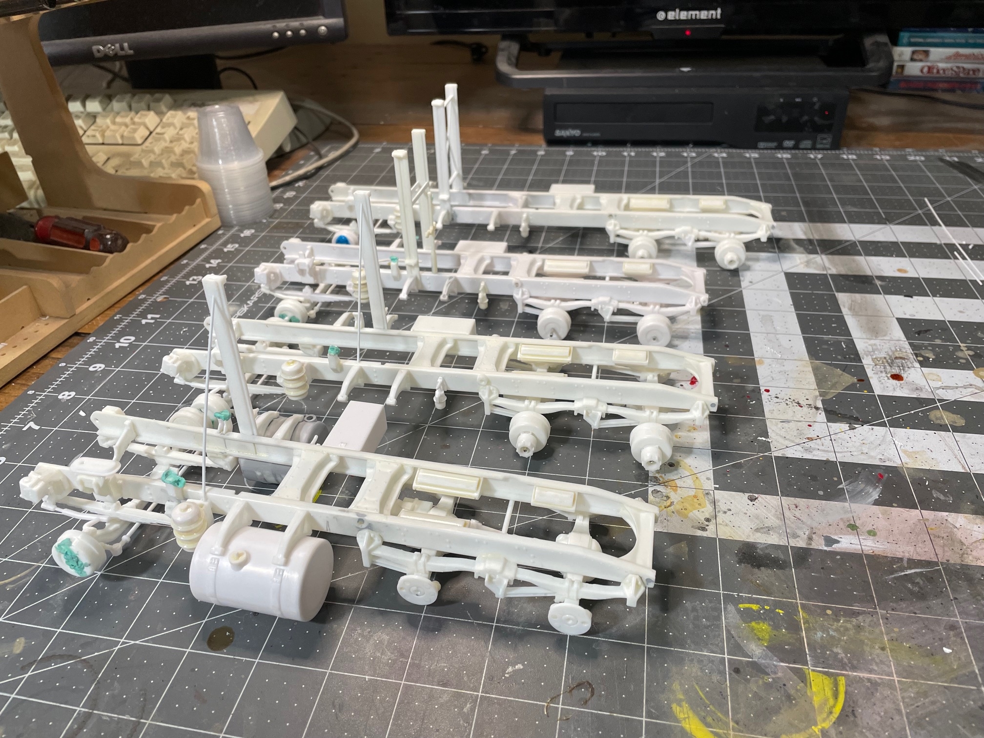

4 frames assembled.  1 shortened, 1 extended.

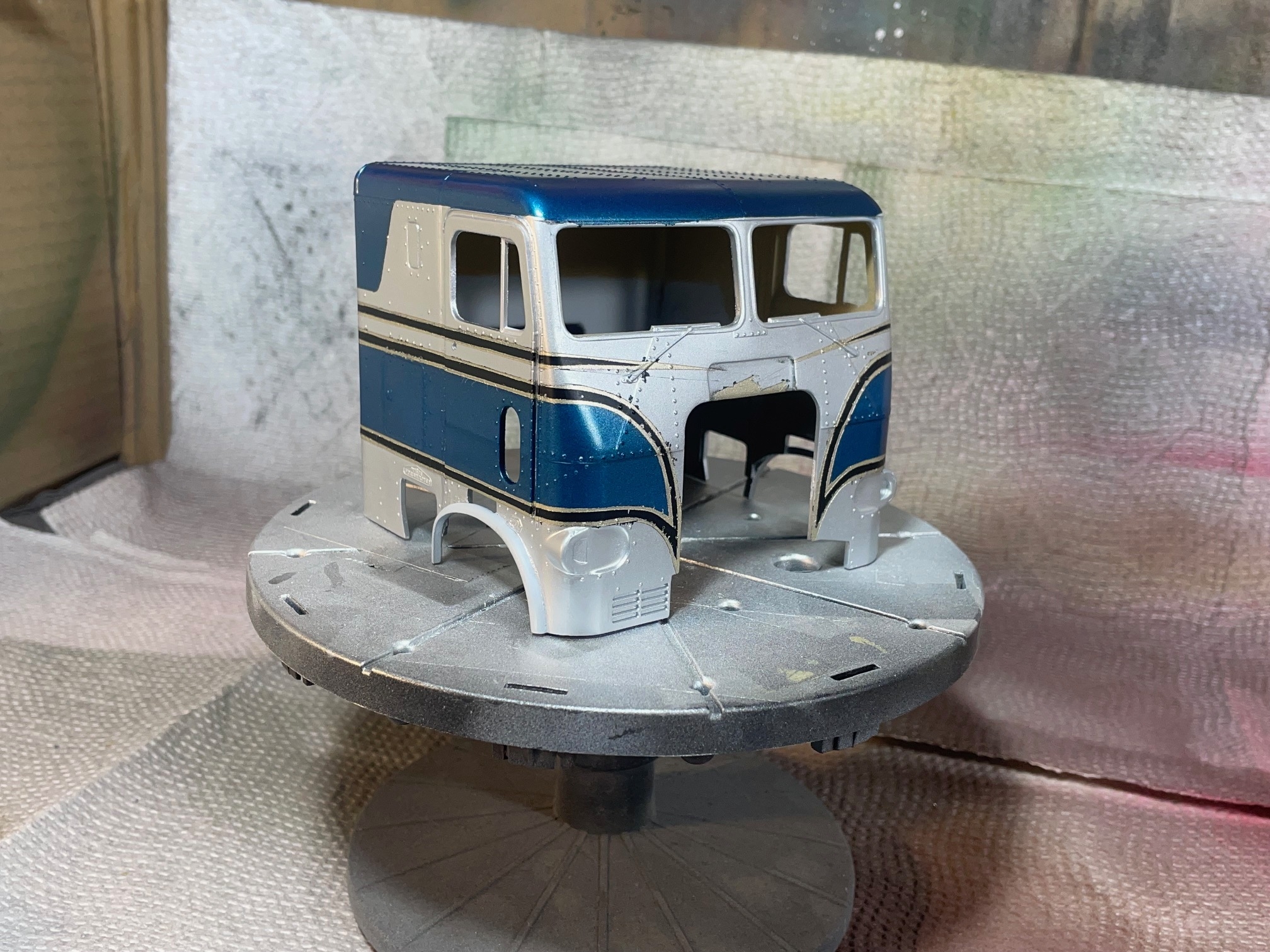

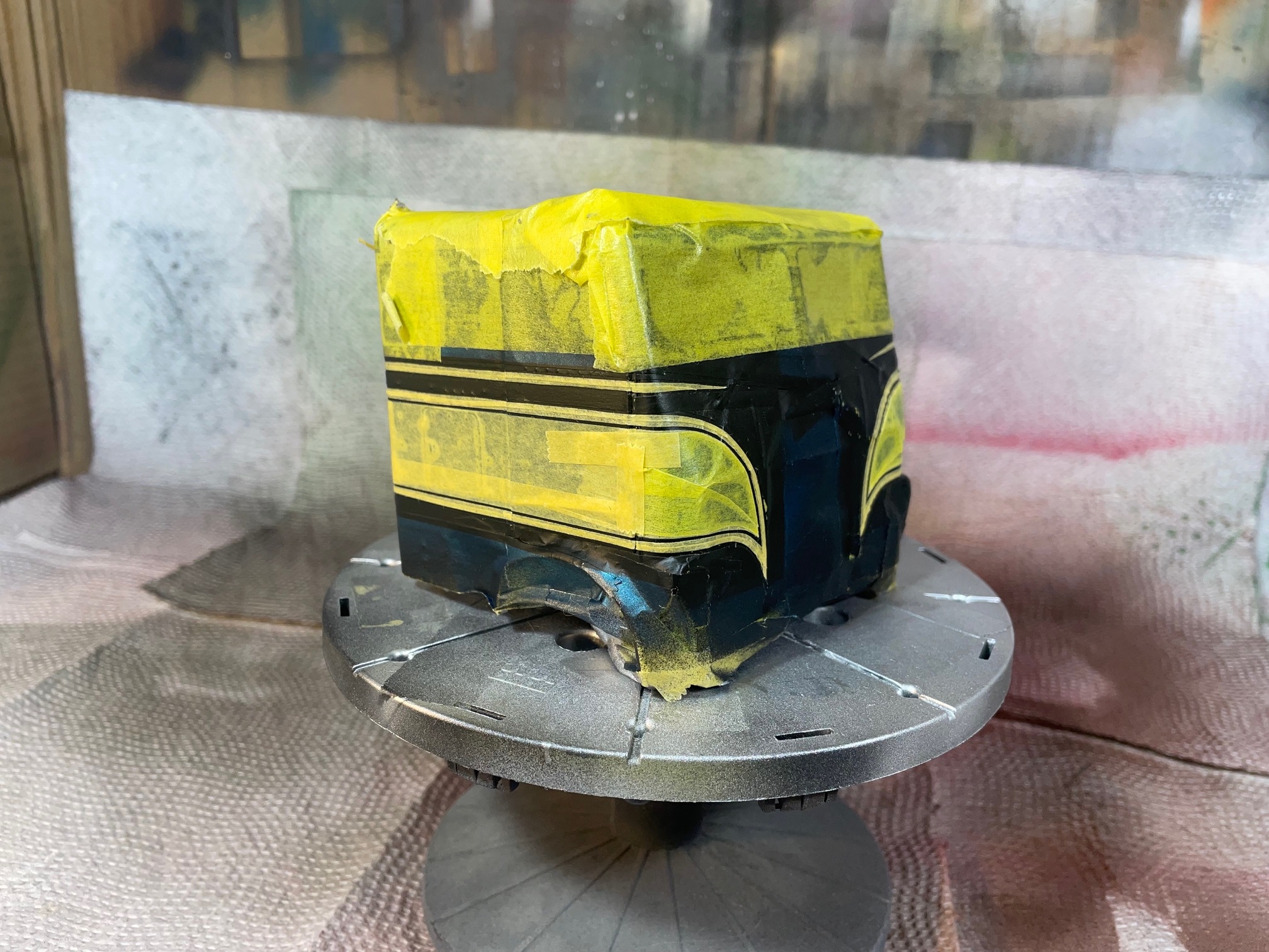

Practicing with tape.
In the paint booth.

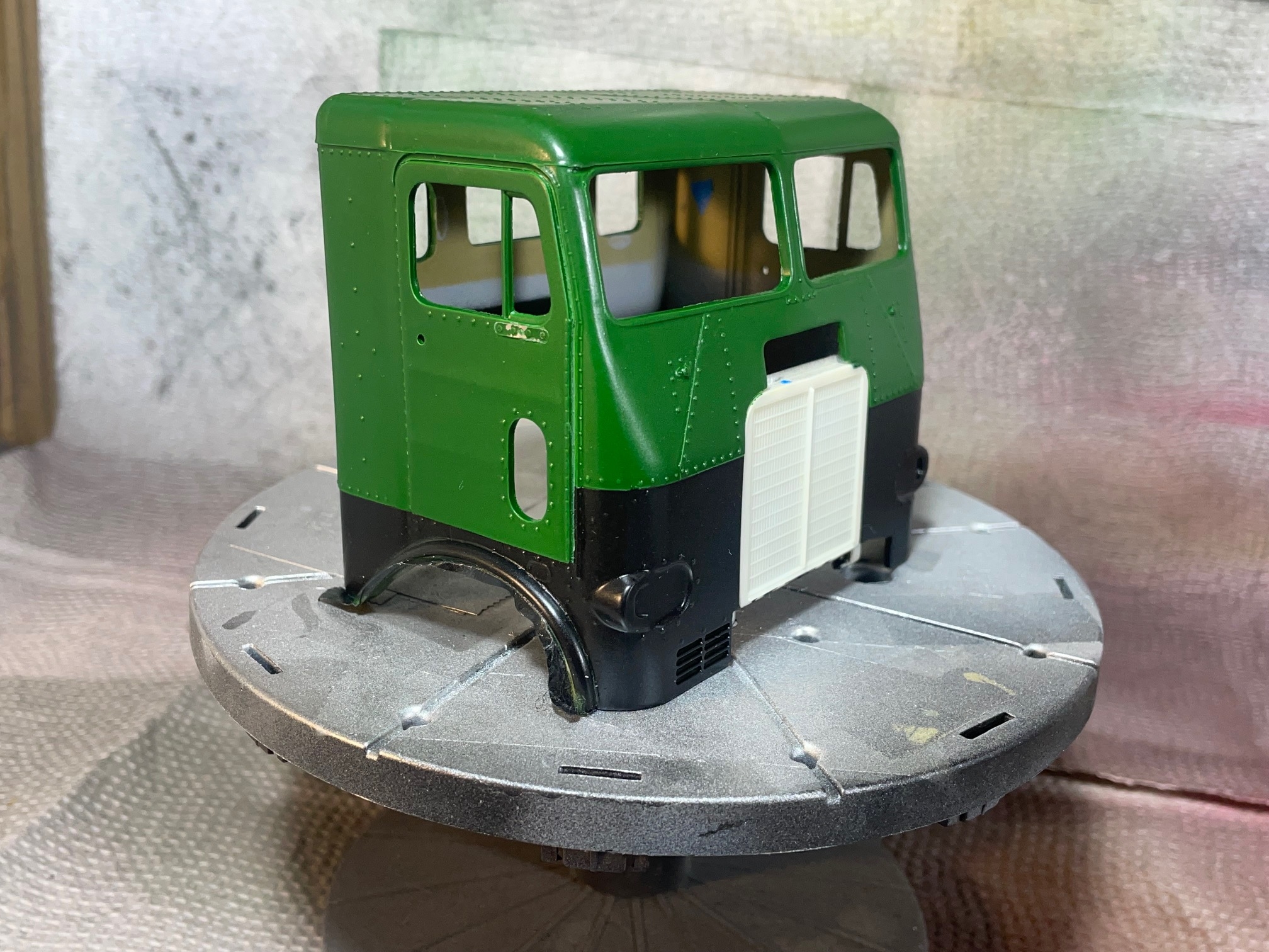

IMG_4091.thumb.jpg.987cdf7deda3099a1954b933b85ee1cc.jpgIMG_4105.thumb.jpg.1a4721a23c530e82c15f67050ef5e1a3.jpg

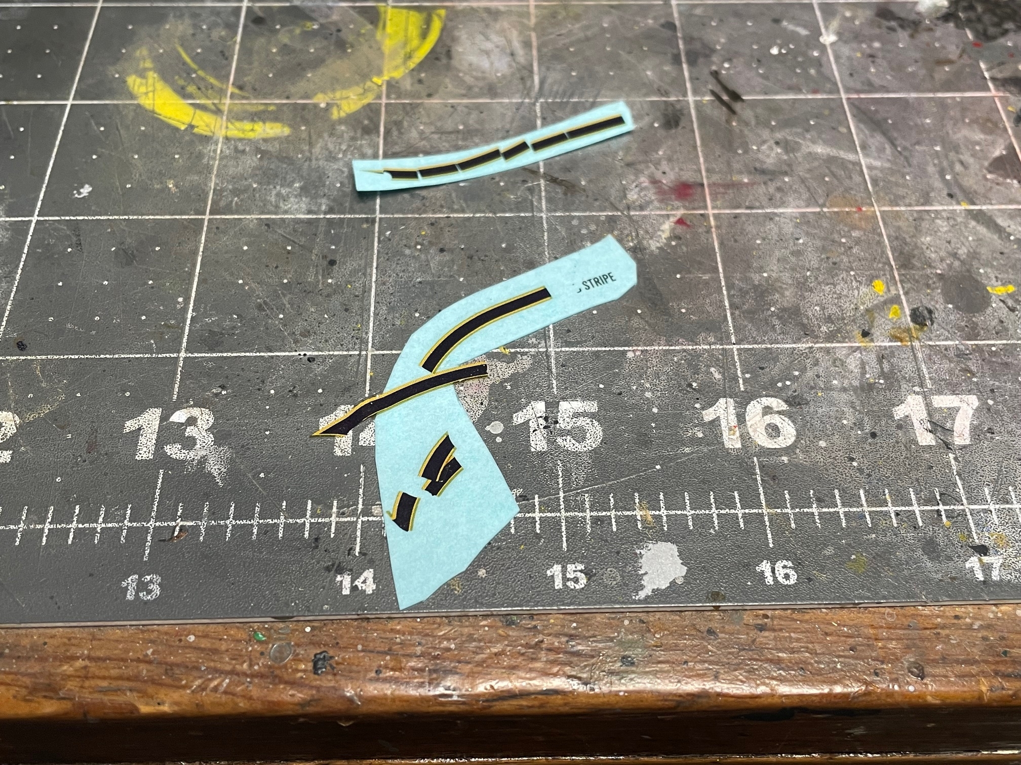

Decals did not cooperated.  Change of plans.  IMG_4087.thumb.jpg.c5b13798d7a2ea9db5bc29b0bea4f4d1.jpg
The striping will be attempted without the decals, which didn't even make it off the paper.

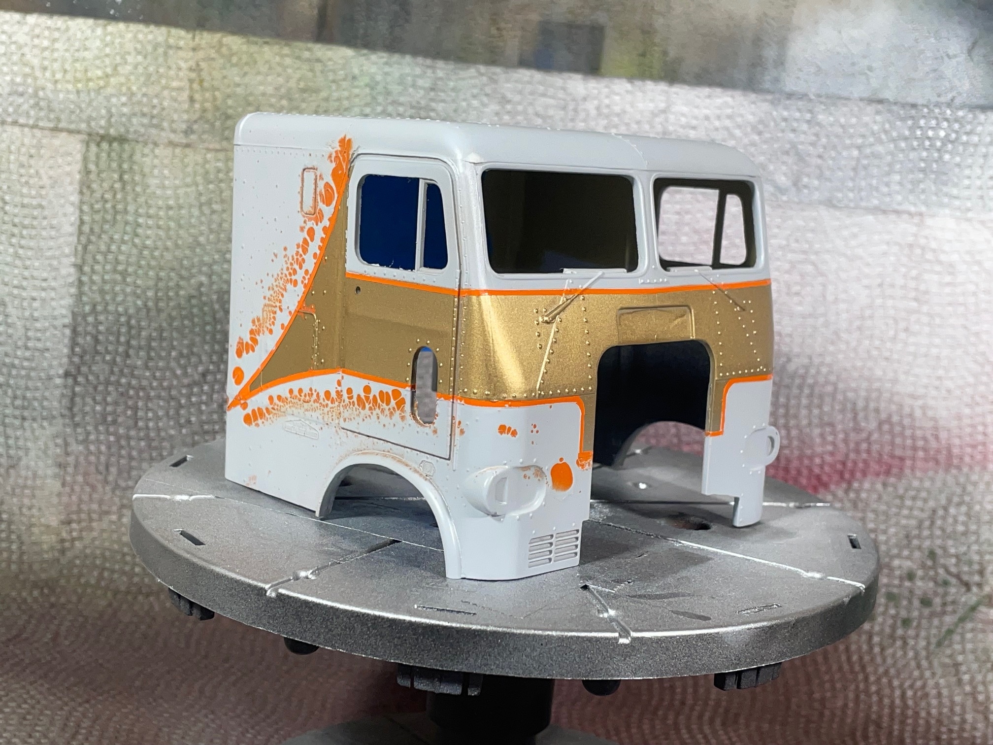

Good enough.  I can clean it up.
Catastrophic failure.  In a tank of Lacquer thinner it will go for a complete re-start.   I really like the concept of #2.
Edited by 02fusoFG
Actually. That white one with the orange , almost looks like a custom paint job , like some bubbles. On my phone as the picture is a bit small it looks pretty cool. It could be clear coated and be the pride of the fleet.  Nice color combination too.
