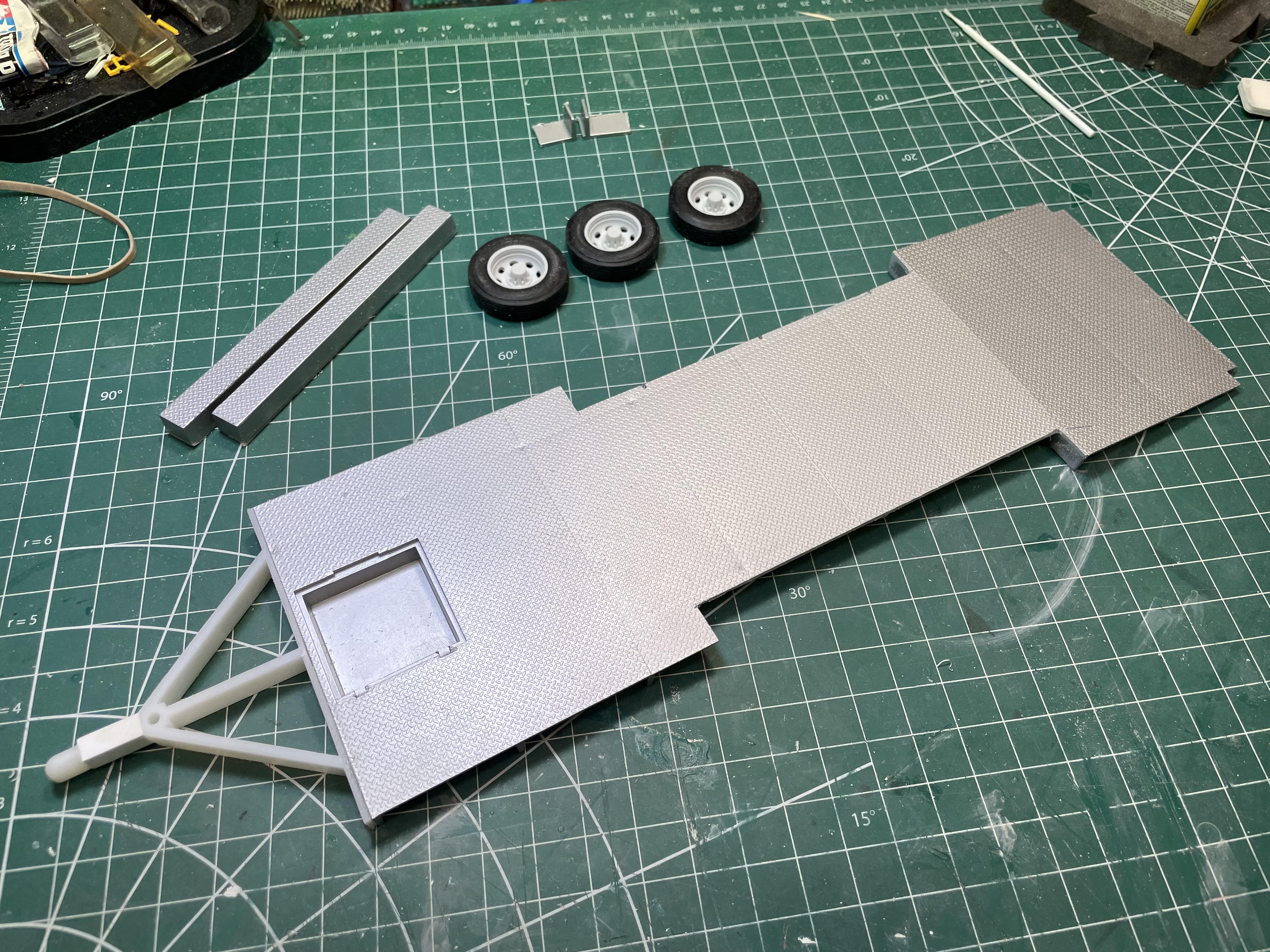

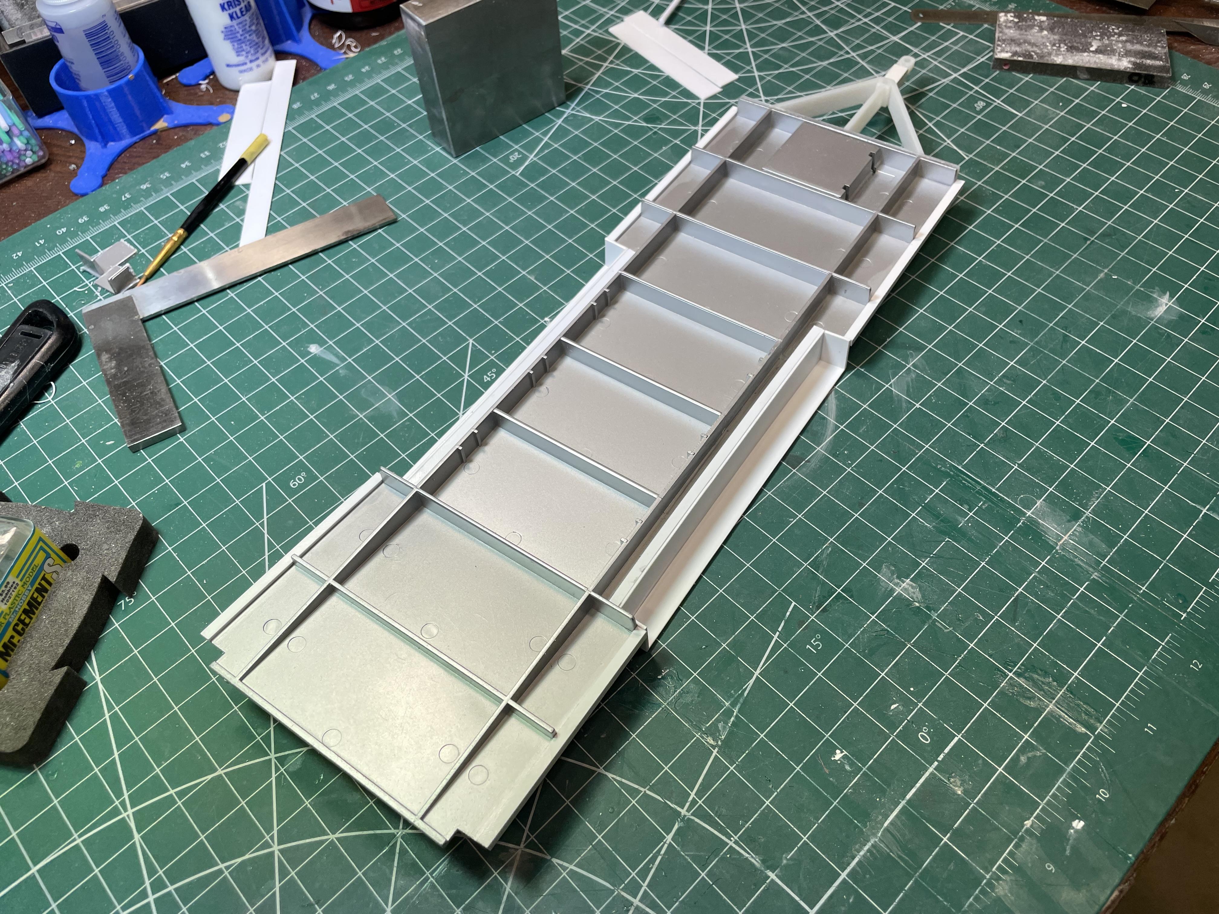

IMG_0424.jpeg.04fb84f1bcbea3891ac4127f444fe2b3.jpegFor the frame and floor, I’ve sourced parts from a partially-built Galaxie Limited 5th wheel enclosed trailer kit. I modified the length to match a scale 24’, added the bumper pull tongue from another kit and lengthened the tongue to a scale 5’ (extended tongues make it less likely to hit the coach body in sharp turns).

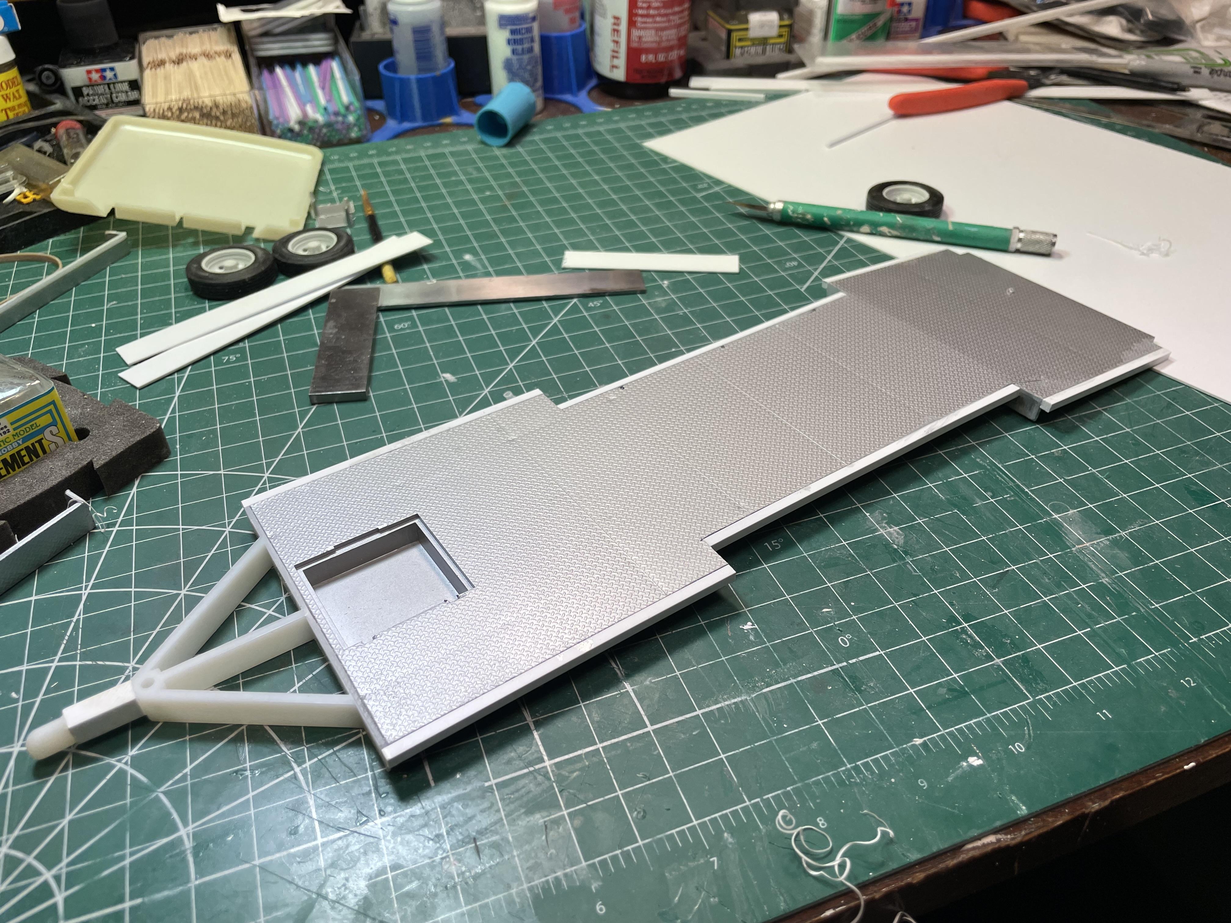

IMG_0425.jpeg.c6ec304c6662a287b7105a1e40944443.jpegIMG_0426.jpeg.7913ea1c06b557208079e55f85c2d723.jpegOut of the box, the floor width is too narrow, so it was widened 1/8” on each side with styrene strip for an overall width of 102” (with the sidewalls in place) in 1/24 scale. I cut out the kit’s inner fenders and replaced them with taller and longer ones made from styrene sheet. The wheels and tires will be 19.5”, and the axles will have a 42” spacing, more typical of modern stacker trailers.

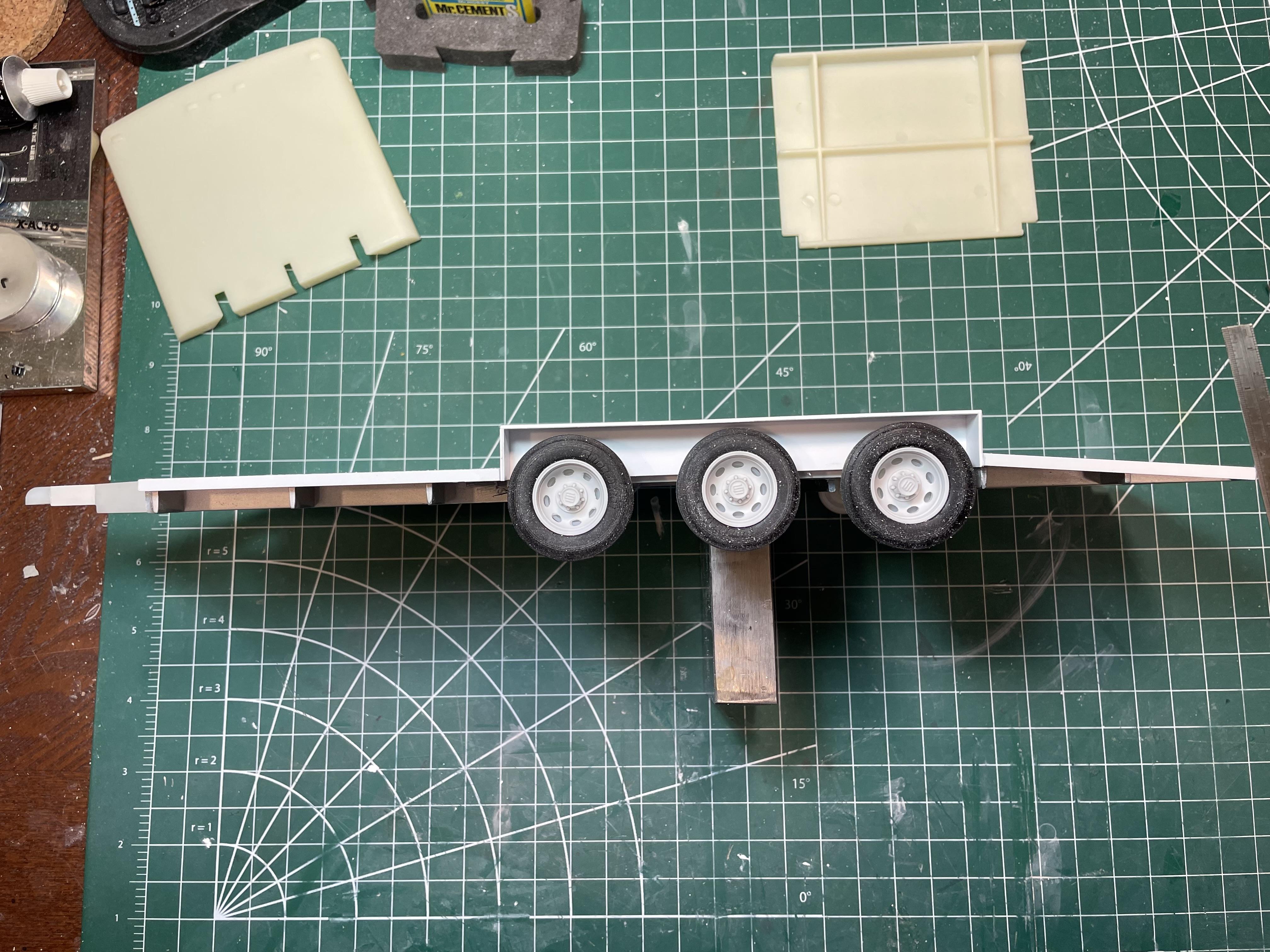

IMG_0427.jpeg.42a3861f8e9c84305c77779ddb86804b.jpegIMG_0428.jpeg.02354a64b2b28801289726188d553aae.jpegIMG_0430.jpeg.06294b77d5abb98a34c7d2f7a67b38a3.jpegTo lower the ride height of the floor to the more realistic 14” ground clearance of most stackers, I modified the frame for the axles. I’m using the kit’s inner wheels as rudimentary disc brake assemblies to add width to the axles. The wheels are oval hole 19.5s from Scenes Unlimited. Tires are 19.5 Bridgestone steer/trailer tires from Moluminum. Next, I’ll be working on the sidewalls.

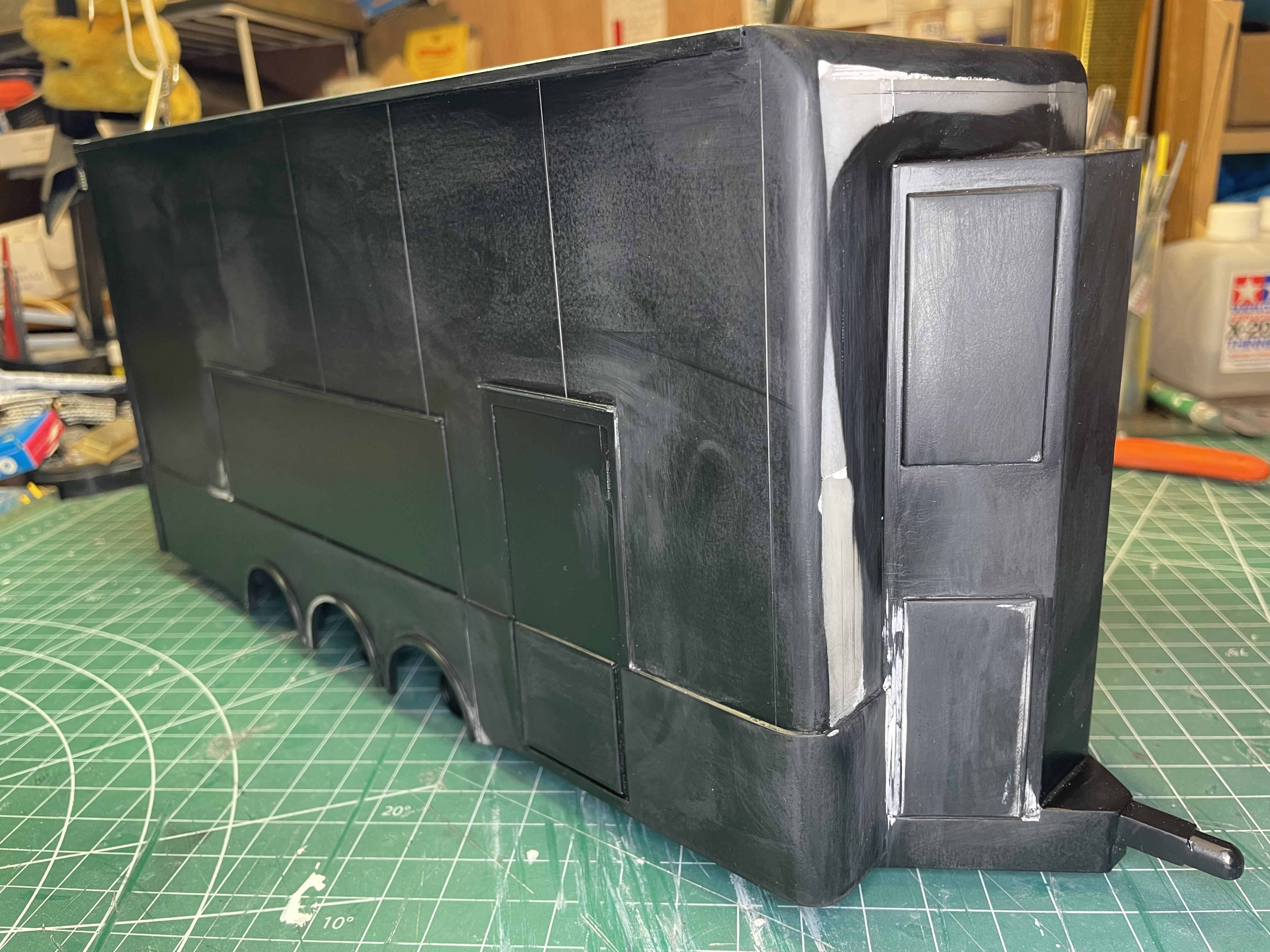

I haven’t had a lot of time to dedicate to the project in the past month or so. But, I managed to get the body work done on the exterior of the trailer, and I was able to begin the process of laying down primer. Ignore the fish-eye effect on some of the photos, not sure why my phone was making the photos look like that.
There wasn’t as much filling and sanding as was on the coach body, so I was able to skip the heavier primers and go straight to Mr. Hobby Black 1500.IMG_1152.jpeg.7725a460e7b52988e29a27bc9a485f3e.jpeg
As usual, the primer exposes small, but noticeable flaws that’ll need a little more work. However, just getting it into black, even if it’s primer, makes me feel like I’ve accomplished something.

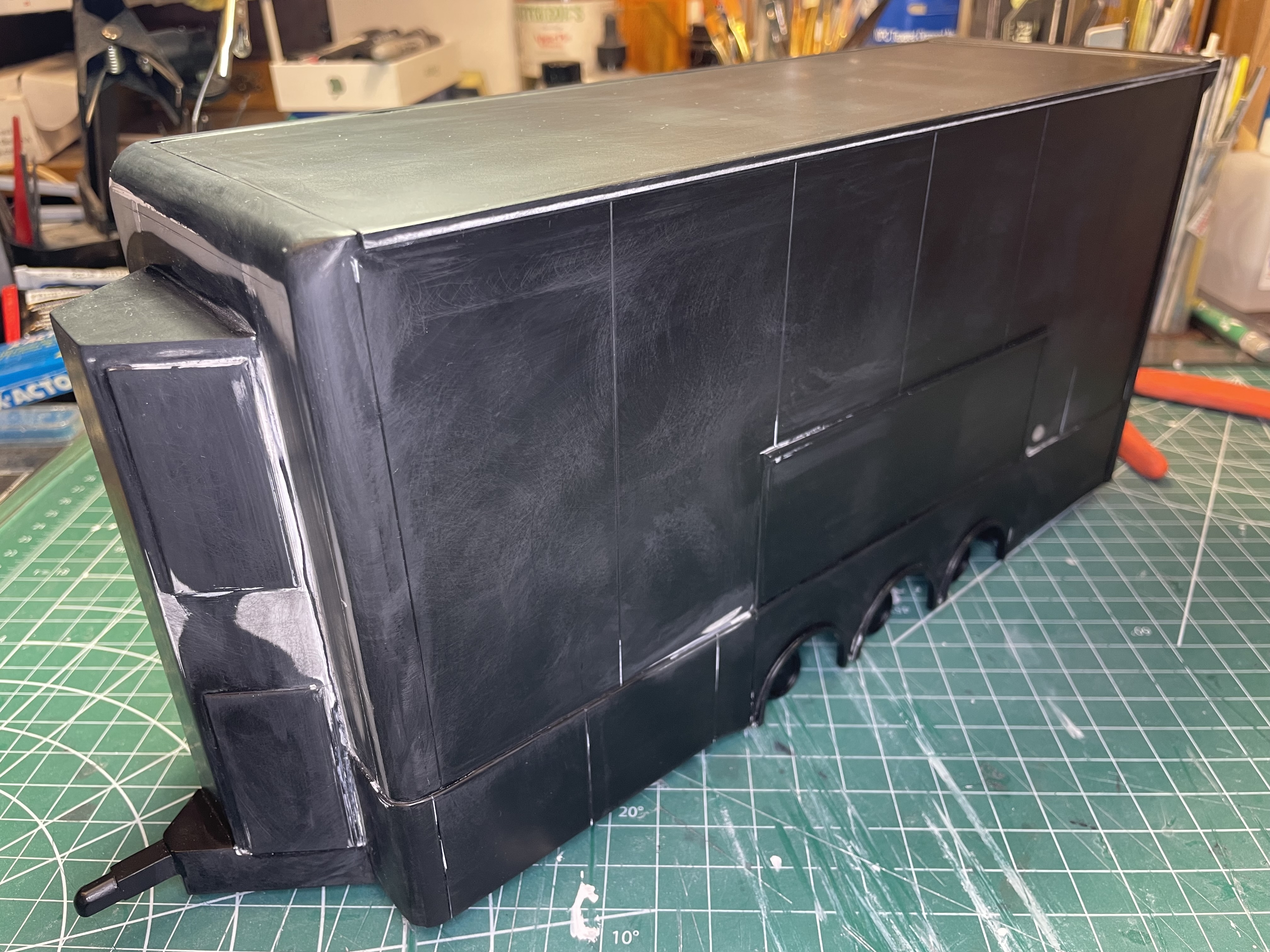

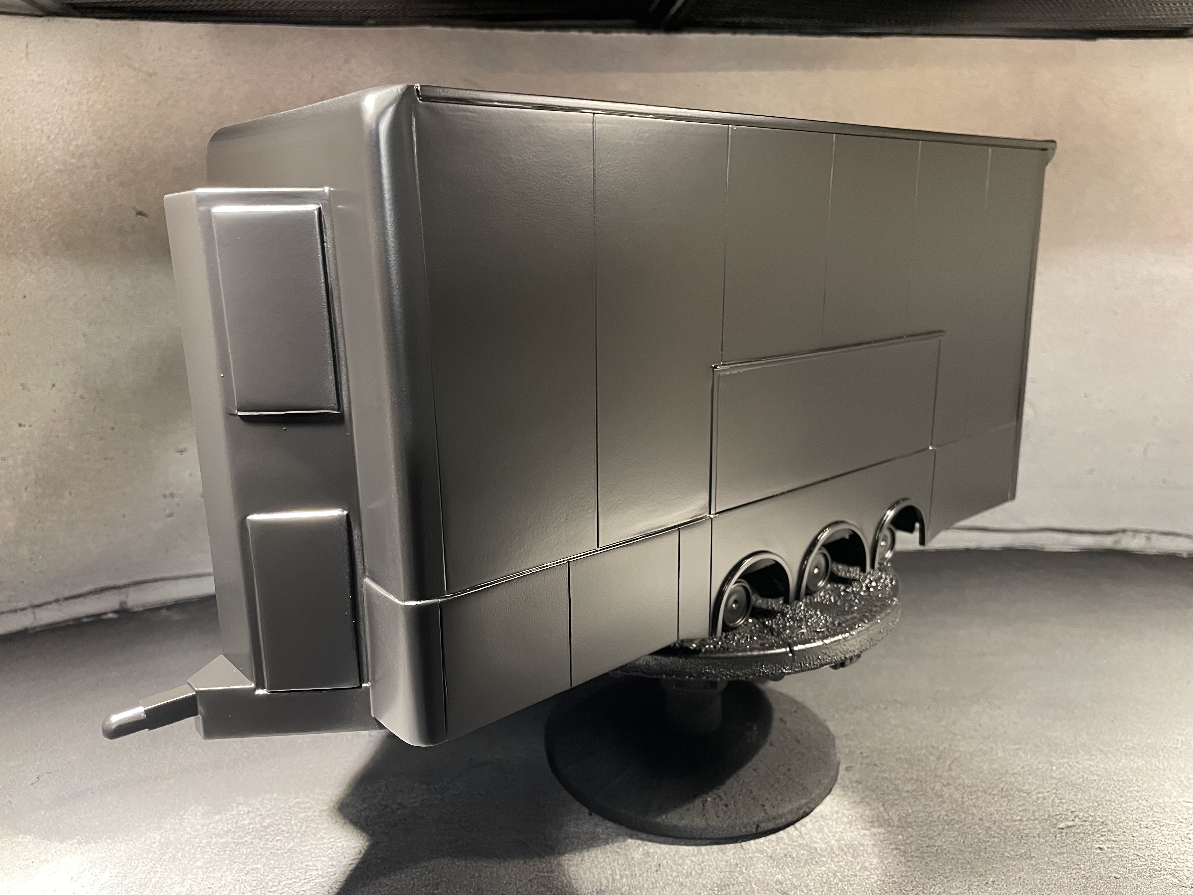

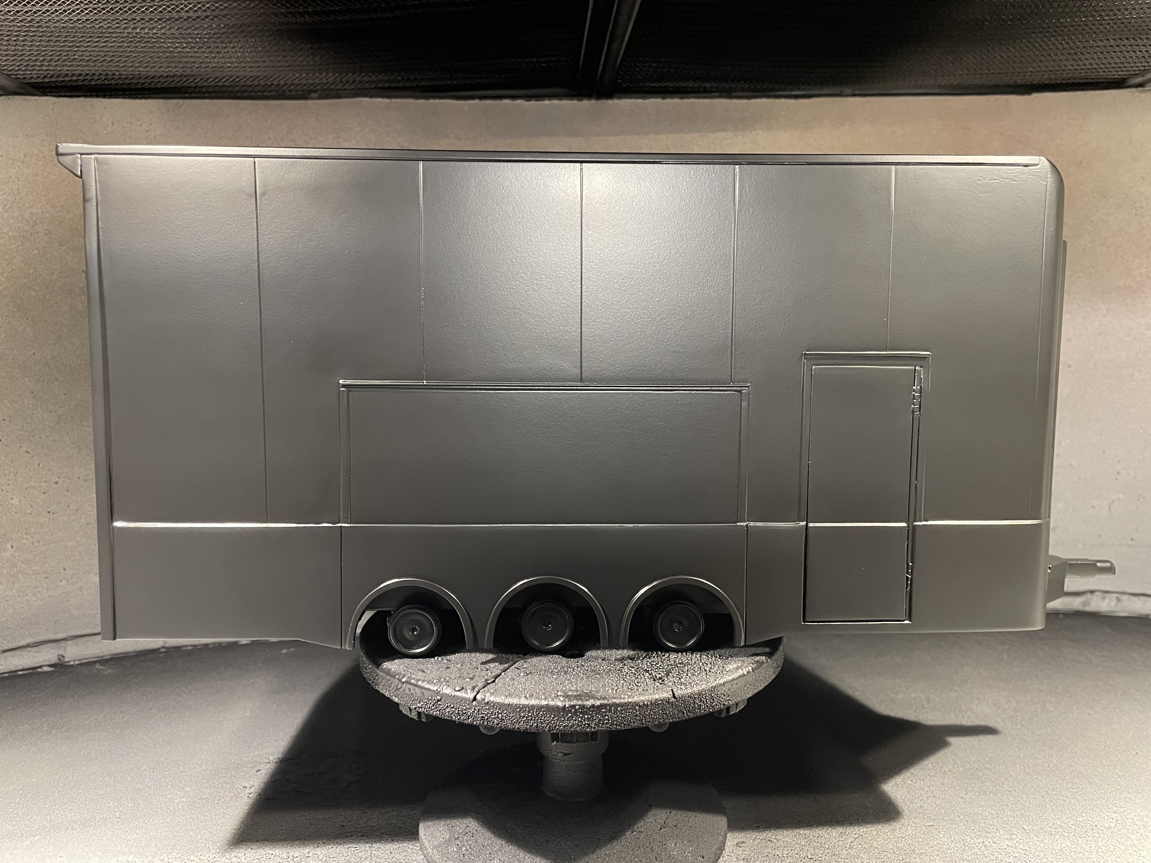

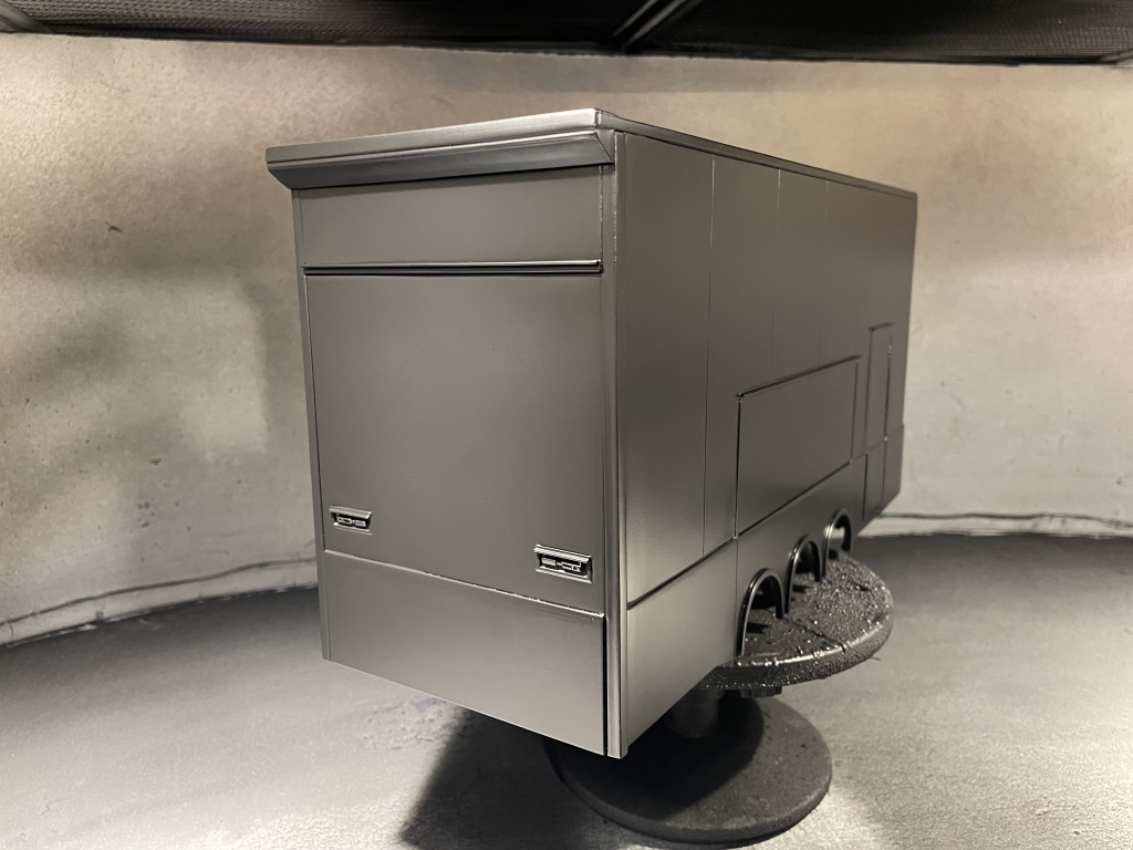

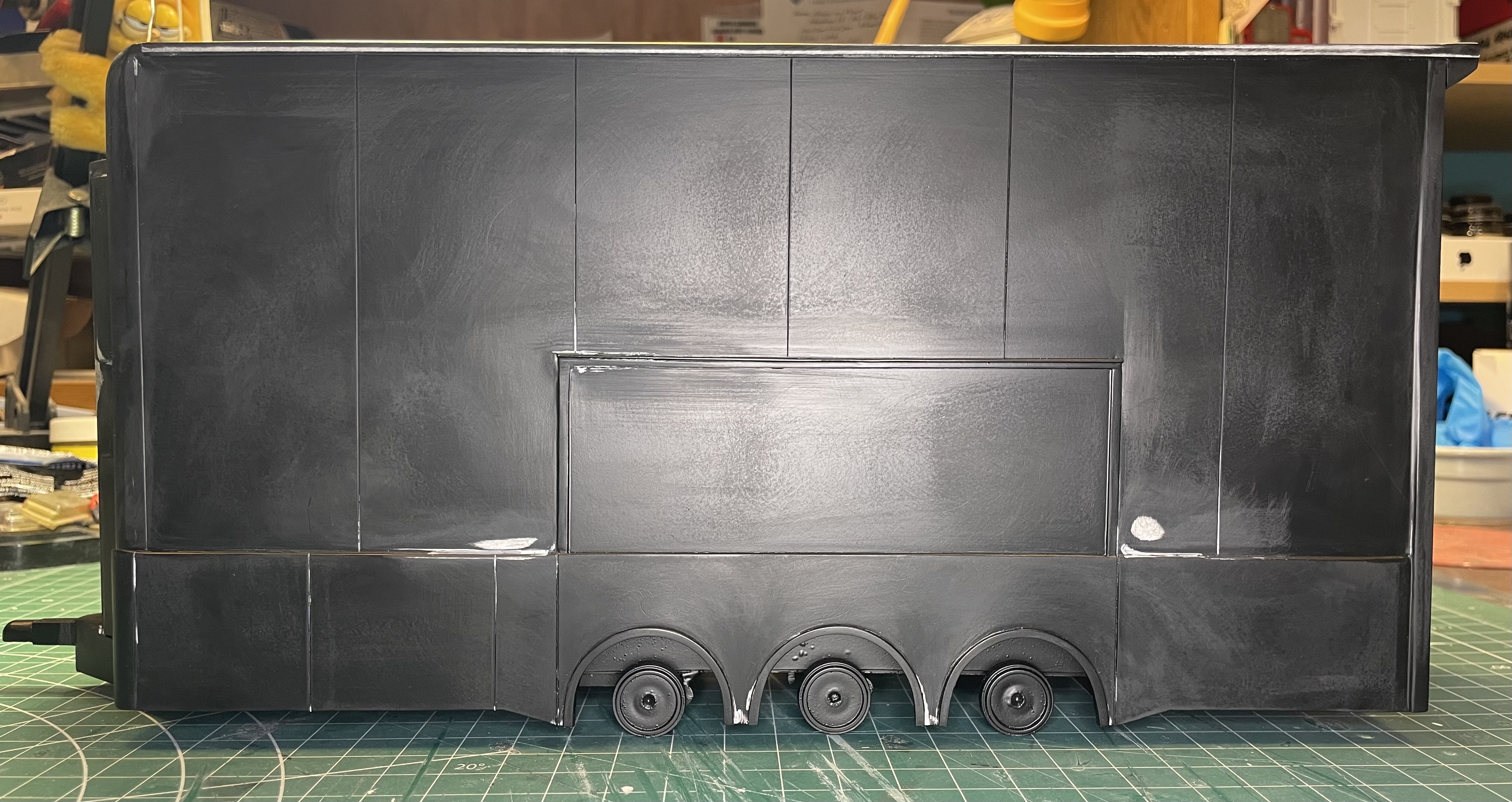

Here’s the latest update. Over the past couple months, I’ve been finishing the exterior bodywork on the stacker trailer.
I’ve done a lot of corrections to the wheel well trim - one of the most difficult things to get right on this trailer.
I’ve put four coats of primer on it, correcting minor imperfections in between. More filling and sanding than I originally anticipated, but there’s light at the end of the tunnel.IMG_1366.thumb.jpeg.81830a3d595795a0d477dda7c420ac7a.jpegIMG_1367.thumb.jpeg.e9bd5ce46623f15fdd1305db298447c6.jpegIMG_1369.thumb.jpeg.3ed77306156eaa1adaa23973b190b0ac.jpeg

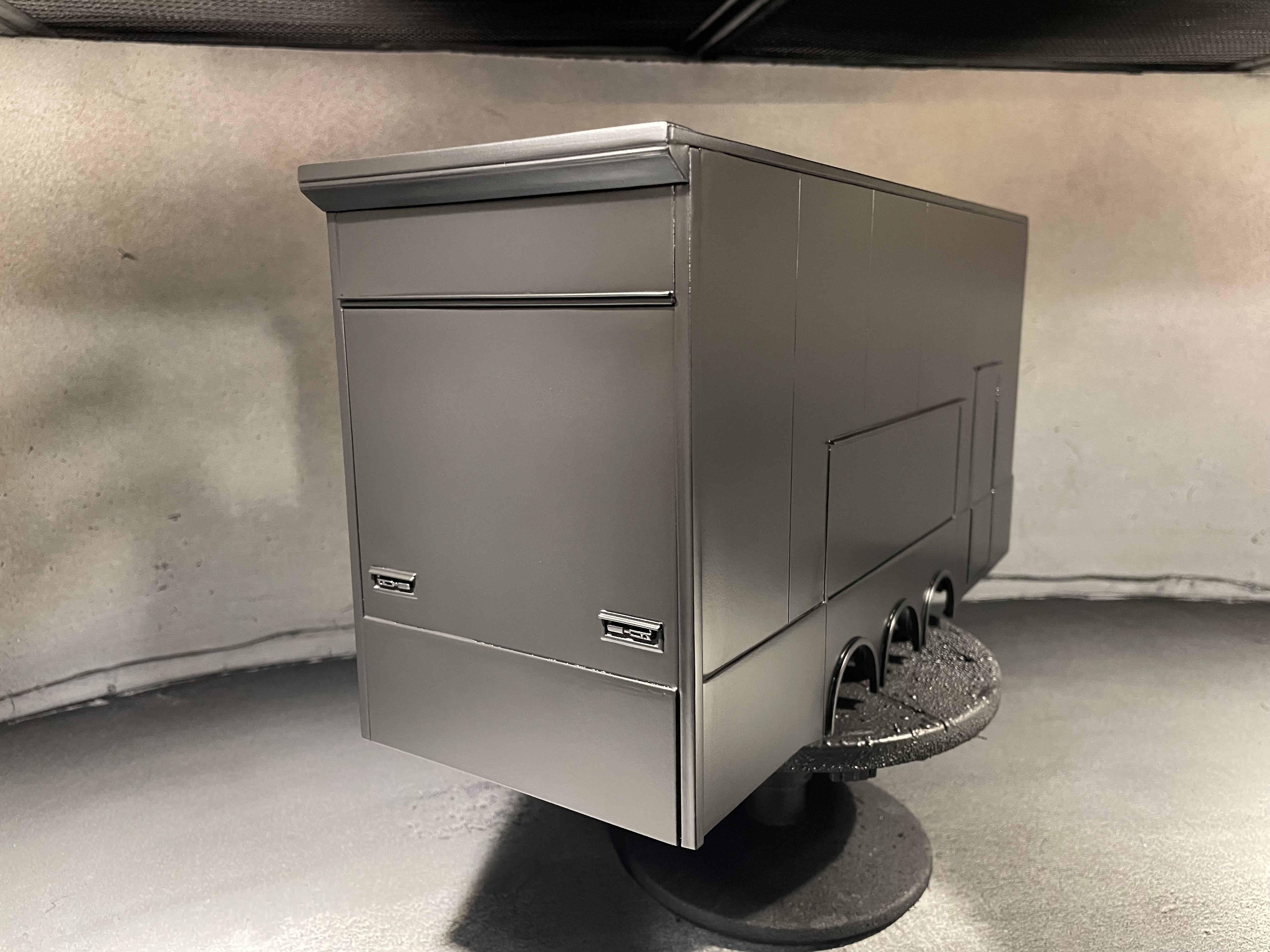

The above photos show one of the workbench sanding sessions in between primer coats. Below are photos from the paint booth during what I hope is the second to last layer of primer.
IMG_1372.thumb.jpeg.5e398dee9e2b007cce8477471d9fd74c.jpegIMG_1371.thumb.jpeg.f37406be26f57d804a12dba9da78c341.jpegIMG_1370.thumb.jpeg.08044051d4b360ee9ad5f12ed16be938.jpeg
