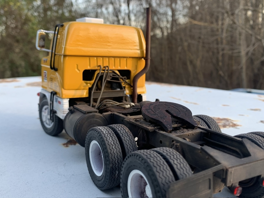

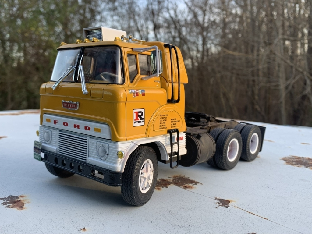

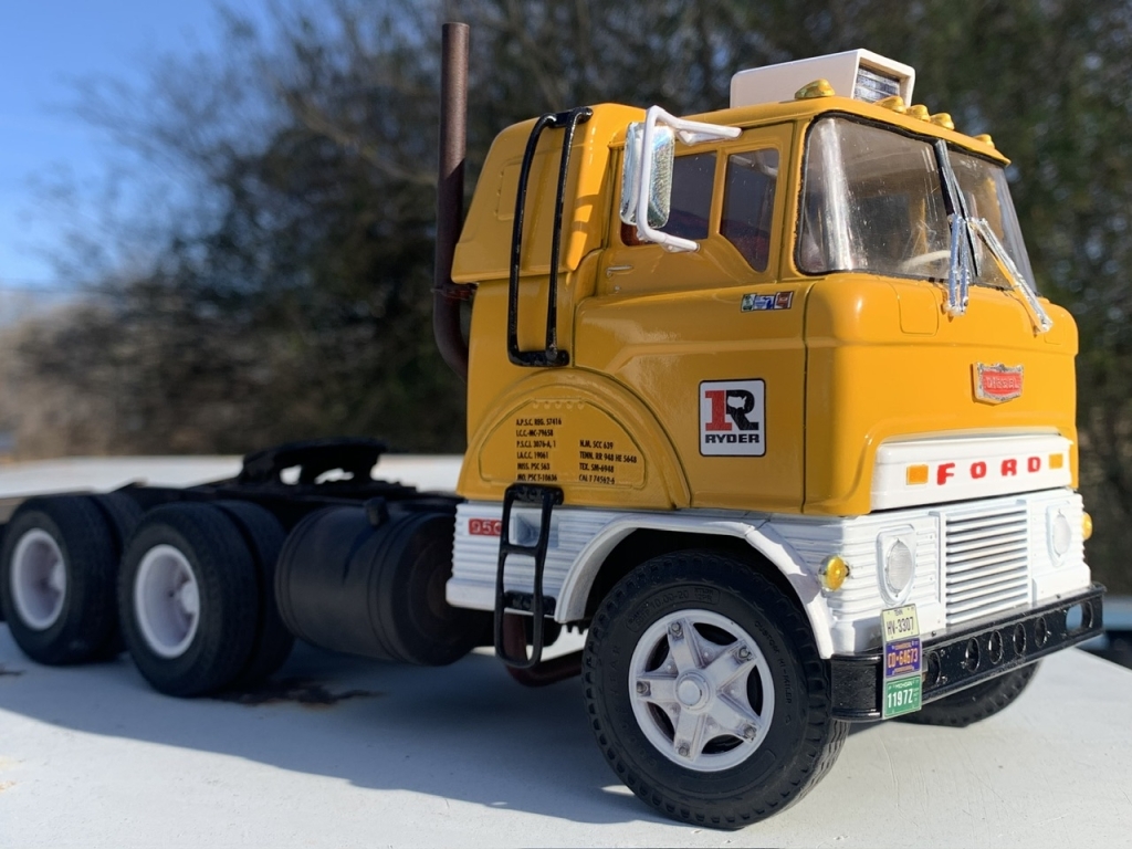

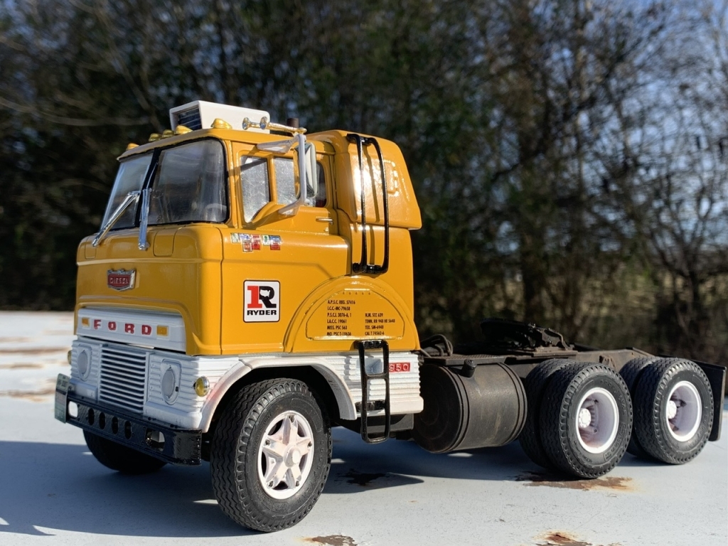

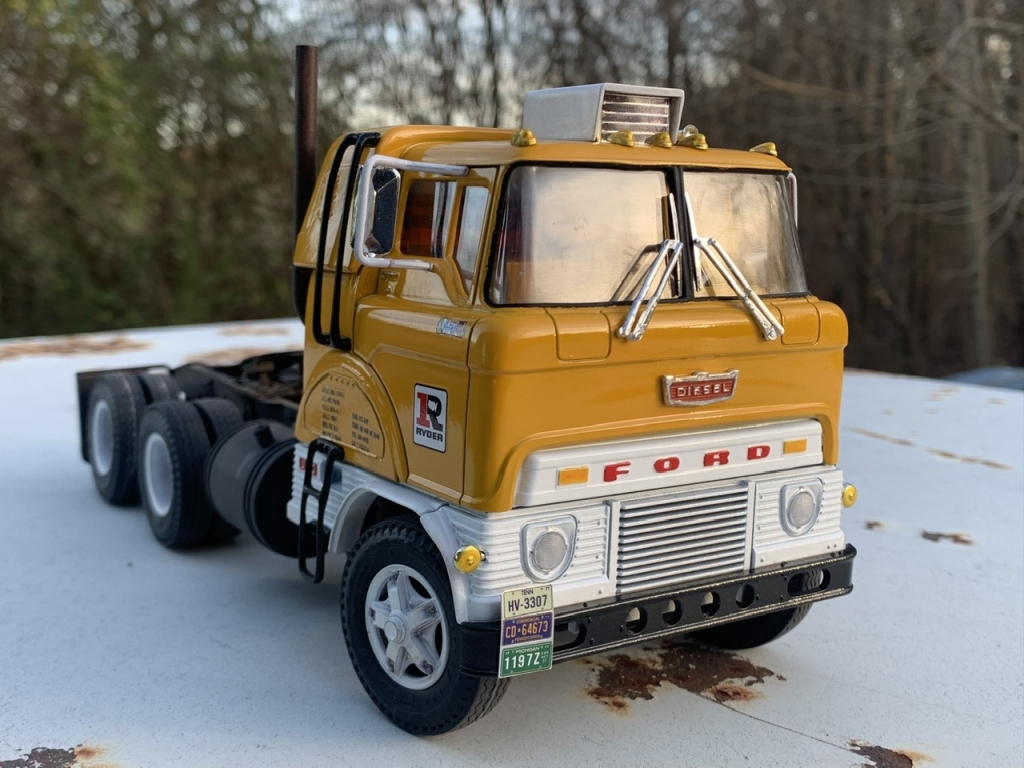

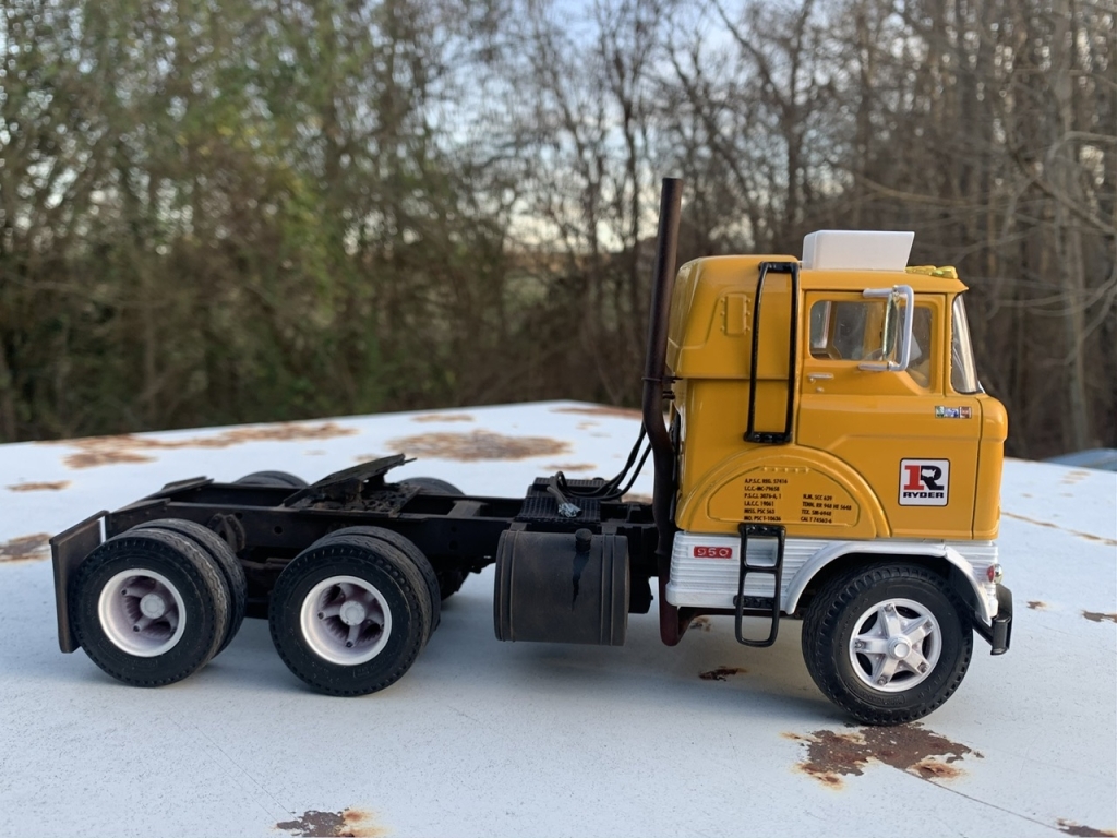

DRIPTROIT 71 Posted December 24, 2023 Last build of the year. 3 Share this post Link to post Share on other sites
Brian Conn Posted December 25, 2023 ..great looking build...any details? Share this post Link to post Share on other sites
DRIPTROIT 71 Posted December 25, 2023 12 hours ago, Brian Conn said: ..great looking build...any details? Thanks! It is the AMT C-Cab cab, with conversion parts from “ Too Many Projects,” (modelerrob on Ebay) to make it an H-Model. It is on the latest release of the 4070a chassis. I swapped out the rear suspension with an old Ertl walker beam Hendrickson suspension. The engine is an AMT Cummins made to resemble a 220. It is mounted at a tilt. Share this post Link to post Share on other sites

DRIPTROIT 71 Posted December 26, 2023 8 hours ago, Johnny M said: That looks great -- love the fuel decals and swinging license plates! Q: Did Ford have to lean the engines over to get them to fit in there? Whassup with that? That's an interesting detail for sure. Johnny Thanks! Tilting the engine was pretty common. Ford did it in the LN models as well. The H models didn’t have a dog house, only a small hump in the floor. The engine was tilted for clearance. Share this post Link to post Share on other sites
