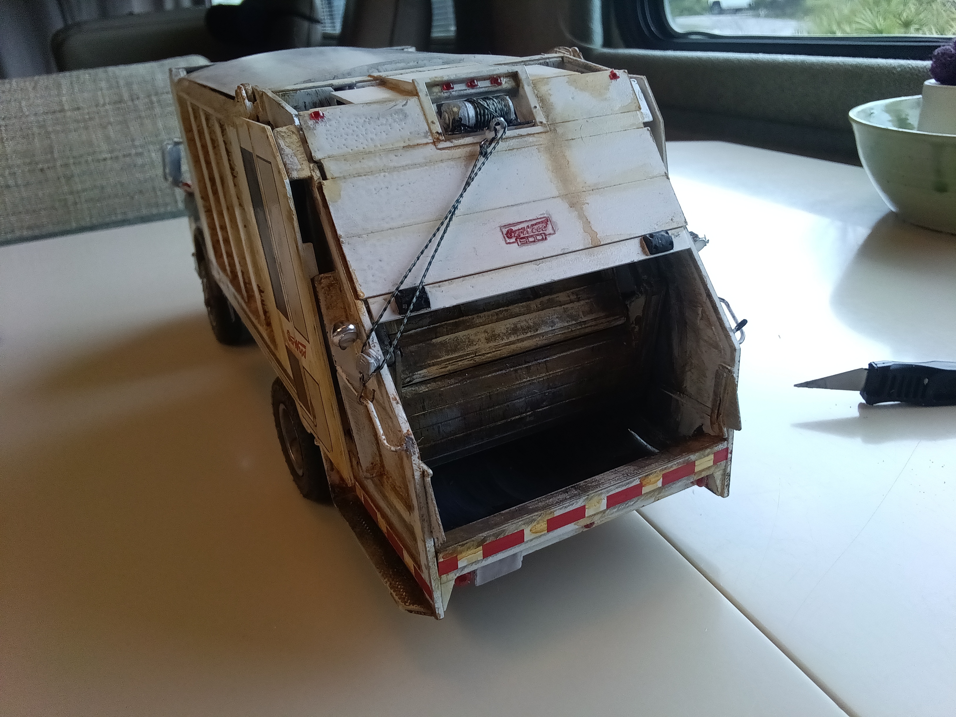

Eric Posted January 14, 2024 Hi Brian This is my first post on here so bare with me. After a 43 year career as a truck and coach mechanic I retired and am traveling with my wife in an RV six months of the year . As a kid I built many of the old ertl truck kits but haven't built any in nearly 50 years until recently I'm currently working on my second one The Garwood refuse truck you are working on and found a good link for the detailing of the compactor. Below link https://www.classicrefusetrucks.com/albums/GW/GW18.html Also the picture of old purple on the box cover has an tube video of the actual truck. both of these should help with the detail Share this post Link to post Share on other sites
Brian Conn Posted January 14, 2024 Thanks Eric, excellent first post... I made contact with Eric Voytko at Classic Refuse Trucks prior to starting this build. Needless to say, I have scoured the Garwood section quite thoroughly a few times and discovered where AMT had made some mistakes, whether intentional or not, with the packer body. The Purple truck is what I'm using as a base for the exterior weathering that I am doing.....found another Ford C-900 trash truck that I'll use for the cab interior weathering and another 2 or 3 packer body interiors that I'll use for weathering the interior packer body. I plan on displaying this build at model shows with the packer body roof off to show the correct packer body interior details. 1 Share this post Link to post Share on other sites

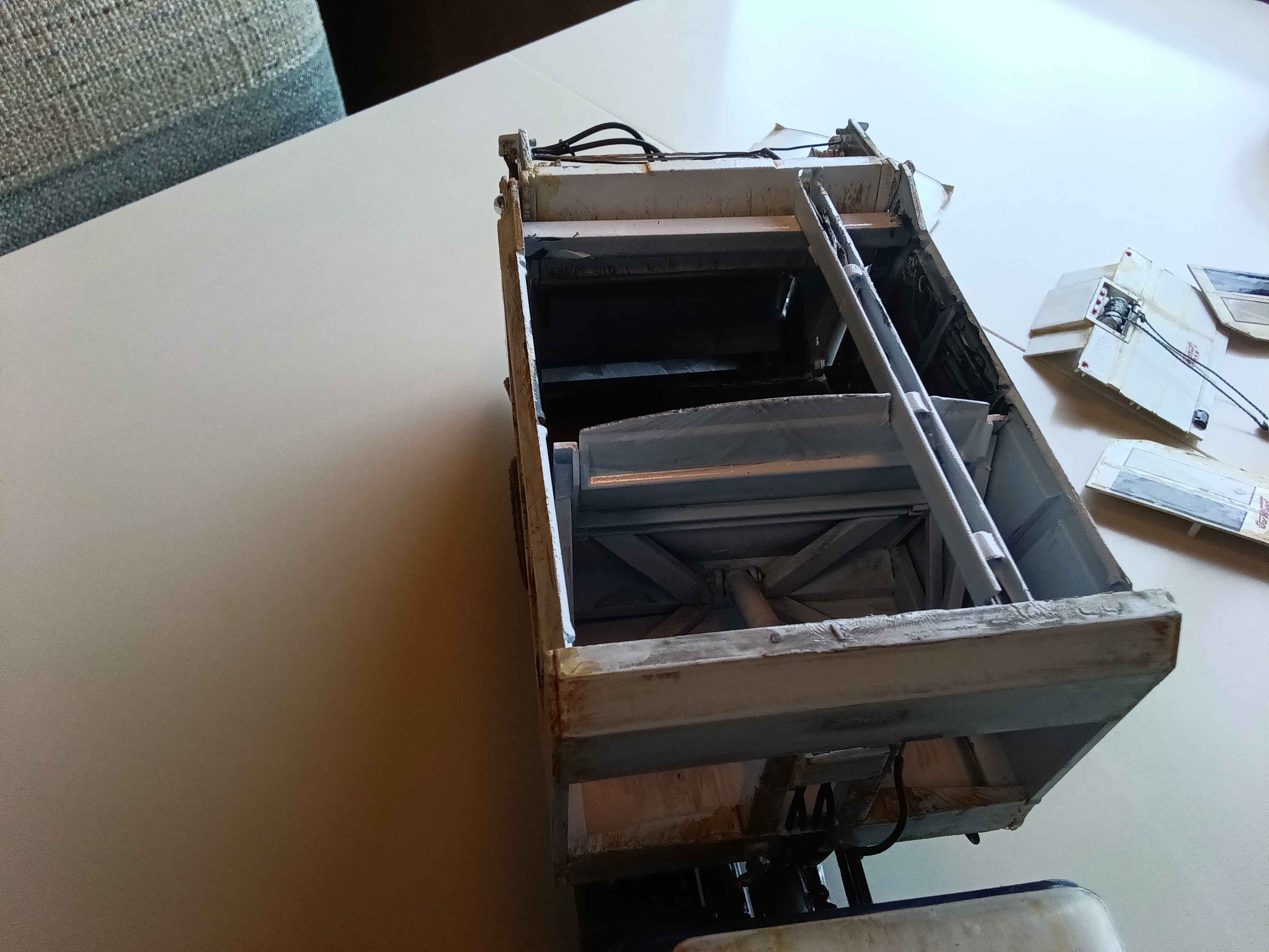

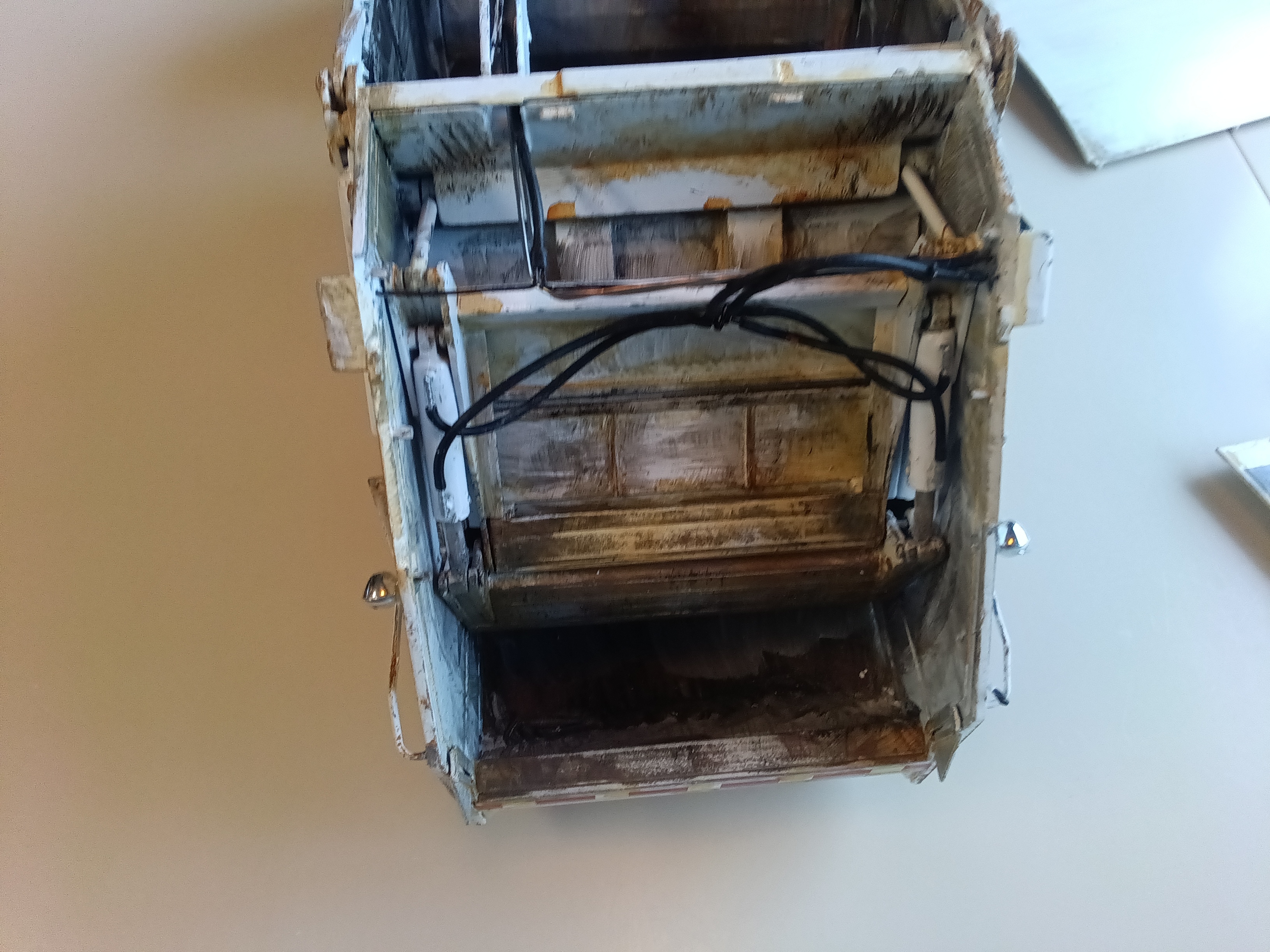

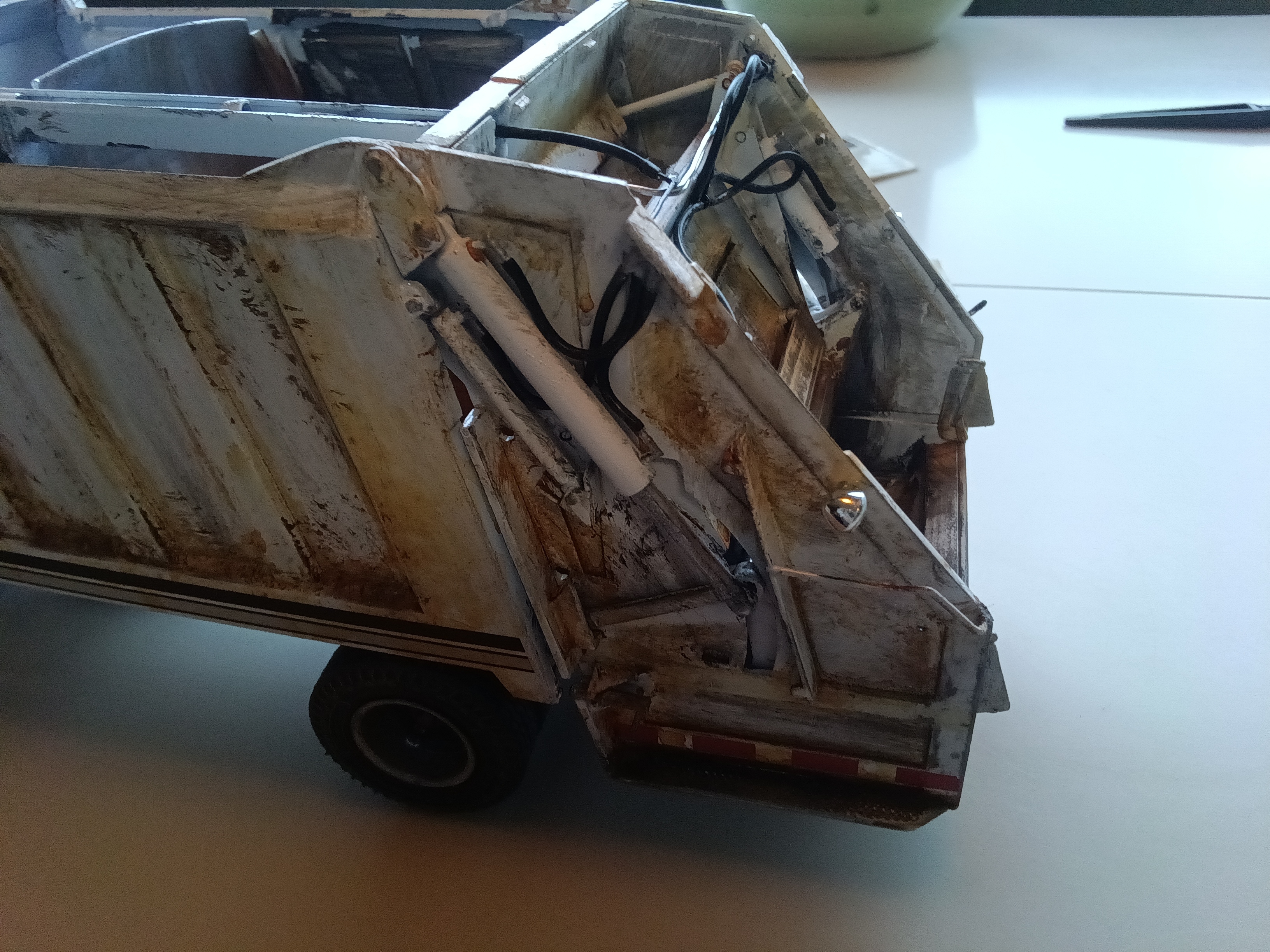

Eric Posted January 15, 2024 Hi Brian on my build I cut a notch in the top of the ejector wall and built a channel to run the hydraulic lines from the front wall back to the tail gate like the 1:1 unit did From my research and experience there should be three hydraulic lines running from the front to the rear one from the forward valve block to run the tail gate lift cylinders And one pressure line to the packer control valves on the passenger side of the tailgate to operate the rear packer. There should be a return line in that conduit as well making a count of three. It looks to me like the return line running from the forward valve body should have run up and teed into the return line coming from the front and then go through the filter housing on the upper front wall before going back to the tank.( On the kit AMT show the return line from the forward valve body going straight back to the tank. There is a hydraulic circuit diagram in the patent diagrams for the PL 900. The packer hoses should have teed on the upper movable packer section and the run to the passenger side wall where they would connect to the control valving. In the 1:1 packer that hydraulic line conduit was welded or bolted to the roof but on my build I wanted to be able to lift the roof off as you do so I added a cross member at the upper rear of the packer to carry the conduit. I'll try to post some pictures of my build tomorrow. Eric Share this post Link to post Share on other sites
Brian Conn Posted January 15, 2024 (edited) As you have discovered, the hydraulic lines are pretty much generic in the kit...p.t.o pump to the front, underneath control valves to the hydraulic tank and whats visible on the hopper even though they designed the cover panels on the side of the hopper to be removable for display. Here is where I am at presently.......... Got the steel air lines plumbed from the compressor to the primary and secondary air tanks, and from the air tanks back forward to the cab area. Added some fuel stain paint to the gas cap area on the fuel tank and weathered some small areas around the air lines. Attached the fuel line to the tank. Edited October 23, 2024 by Brian Conn 1 Share this post Link to post Share on other sites
Eric Posted January 15, 2024 (edited) Looks great so far On the fuel tank you'll see three fittings close to the frame on top of the tank that is where the fuel pickup and returns would have gone the larger circle out towards the outside of the tank was just the fuel sending units for the gas gauge and would have had two wires connected to ita ground wire under one of the out circle retaining bolts and a signal wire to the center of the sending units. I didn't get into all the air lines and wiring as you have .but as I spent the last five years of my career as a heavy equipment mechanic I did try to connect as many hydraulic lines as I could . The kit has almost enough hydraulic line to do everything except the over head line front to rear which I did with craft wire ( If l had it to do again I'd have used solder for those instead. I also drilled the tailgate latches and used craft wire to hide them so the tail gate could be opened. I also added the winch cable and snatch block as shown on old purple As you can see I weathered this one up as a fifty year old heavily used unit ( maybe a bit over done) and will be suspended towing it with my already completed AMT Pete tow truck. Edited January 15, 2024 by Eric 3 Share this post Link to post Share on other sites

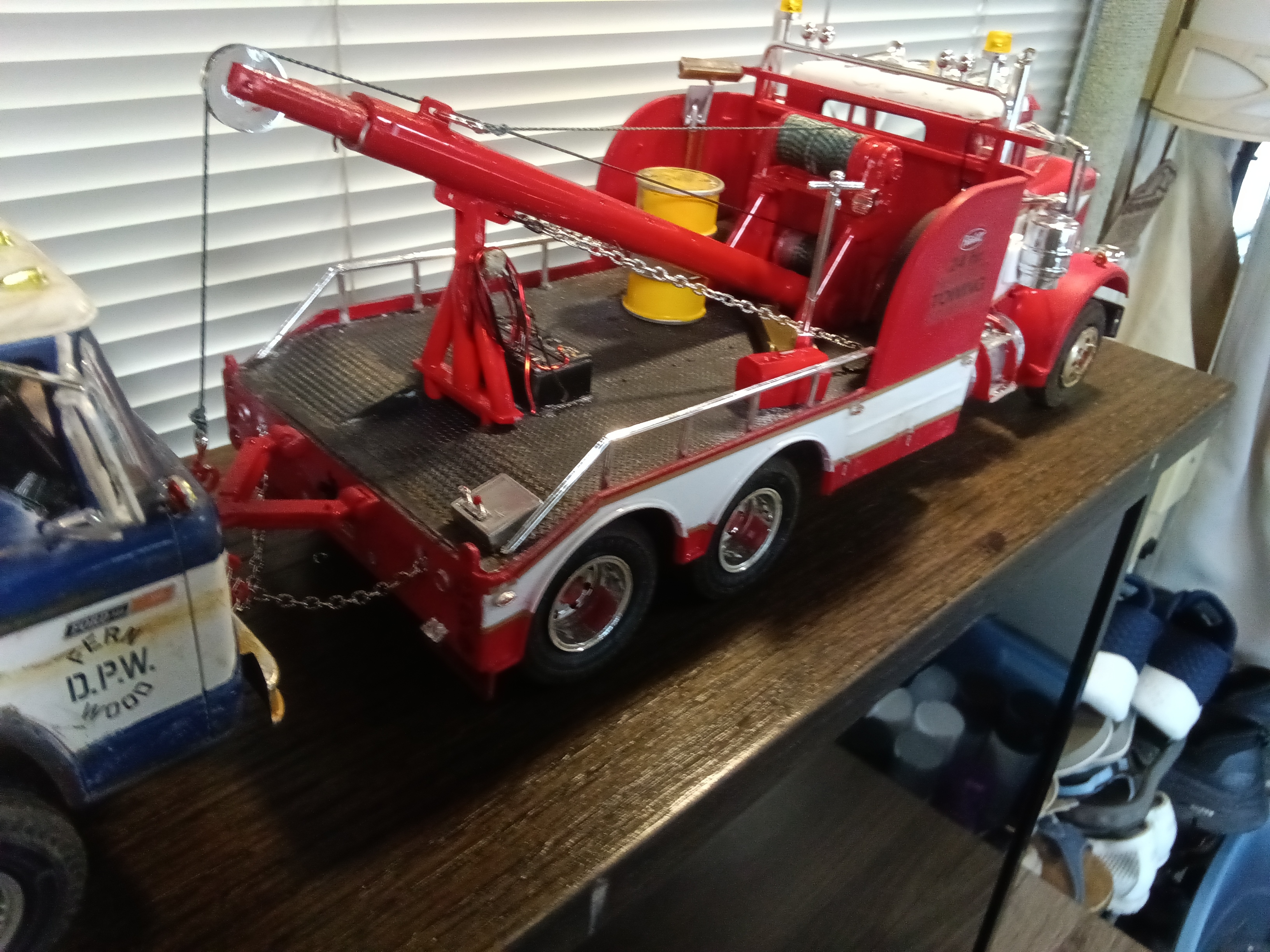

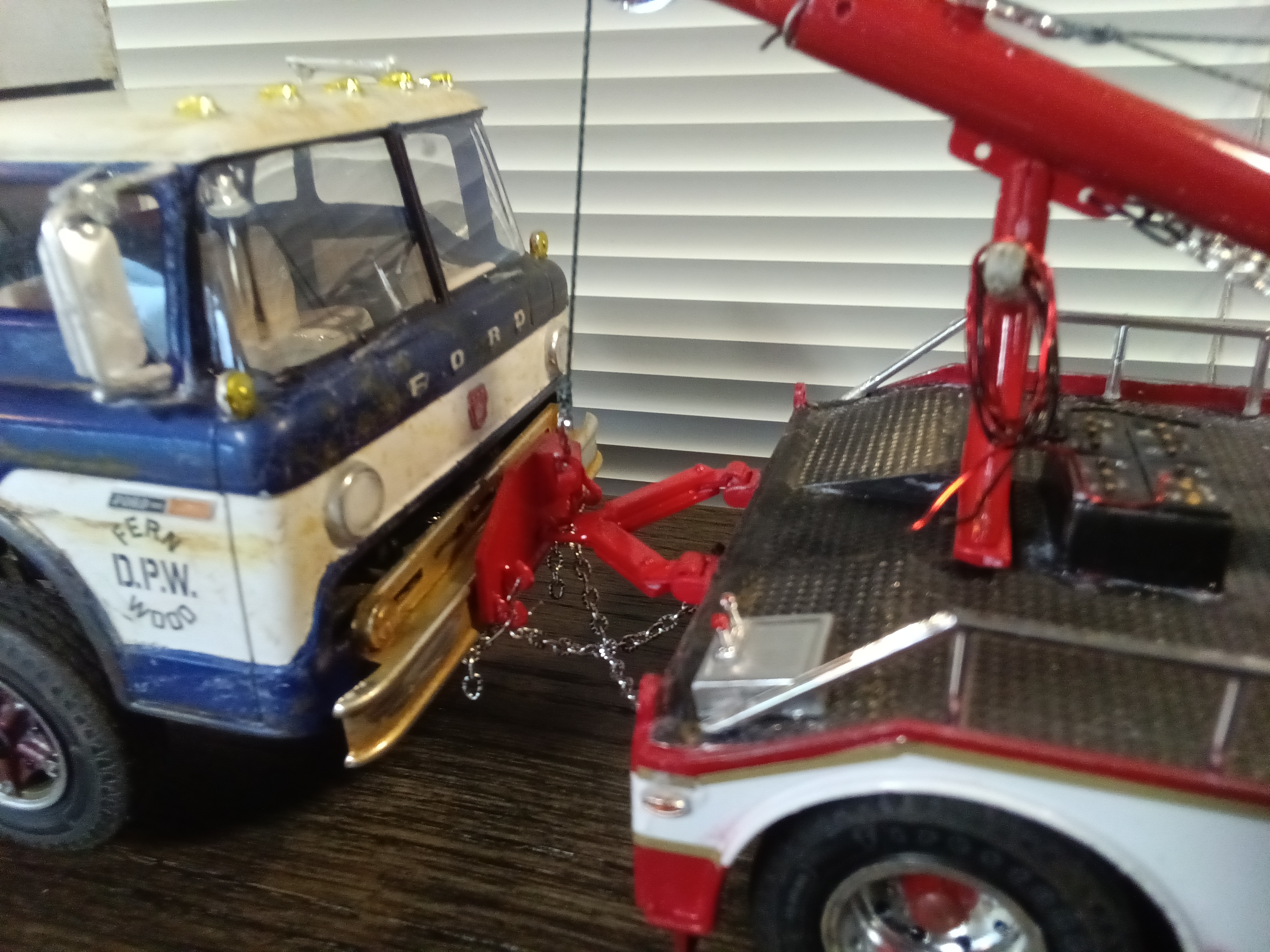

Eric Posted January 15, 2024 Here is a picture of two of the refuse truck being suspend towed as promised 1 Share this post Link to post Share on other sites
Johnny M Posted January 16, 2024 That's just great, Eric ! I can almost smell it from here. 😜 Johnny 1 Share this post Link to post Share on other sites
Eric Posted January 16, 2024 Thanks Johnny I tried to create everything but the stink. Lol Share this post Link to post Share on other sites
