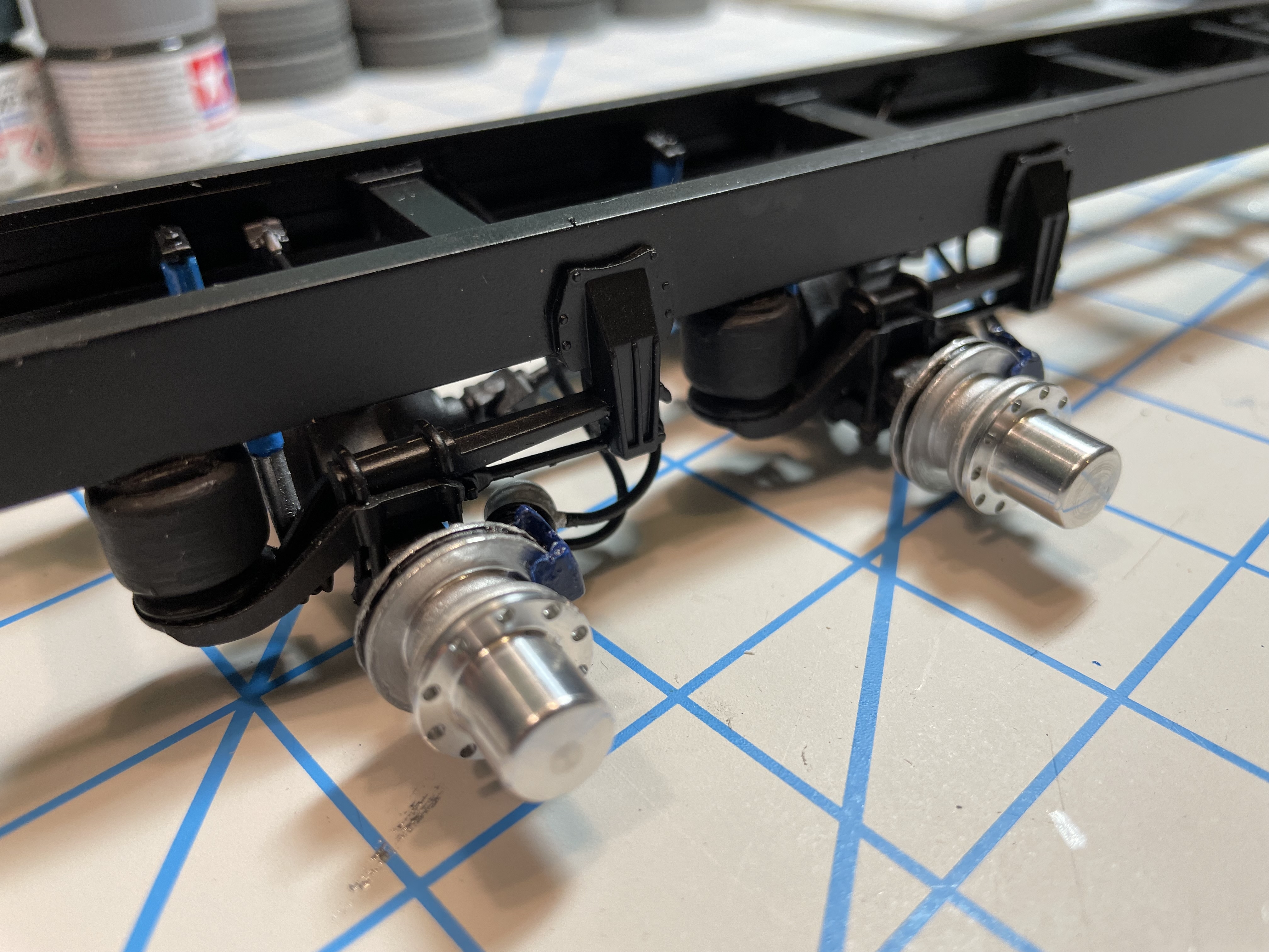

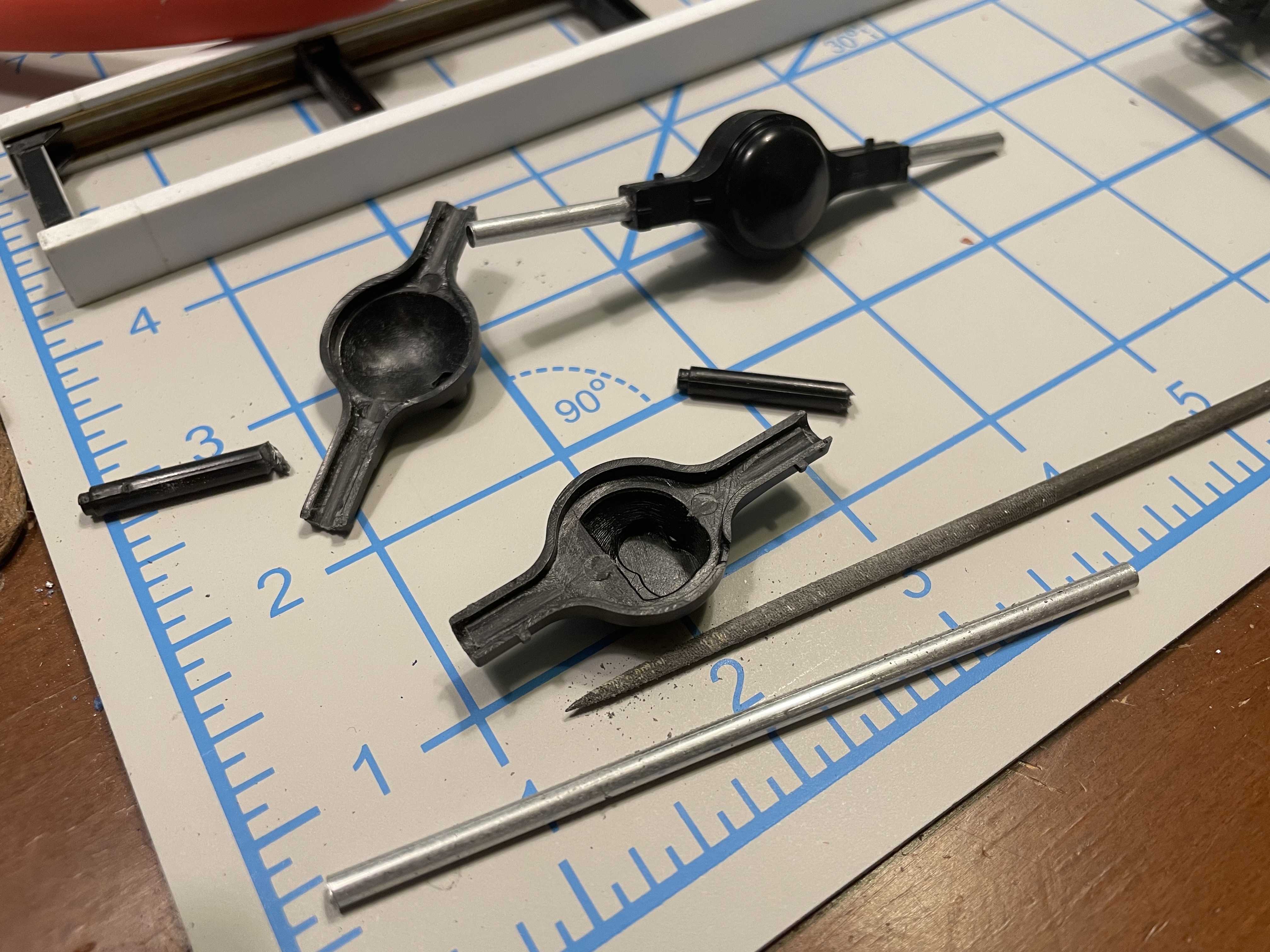

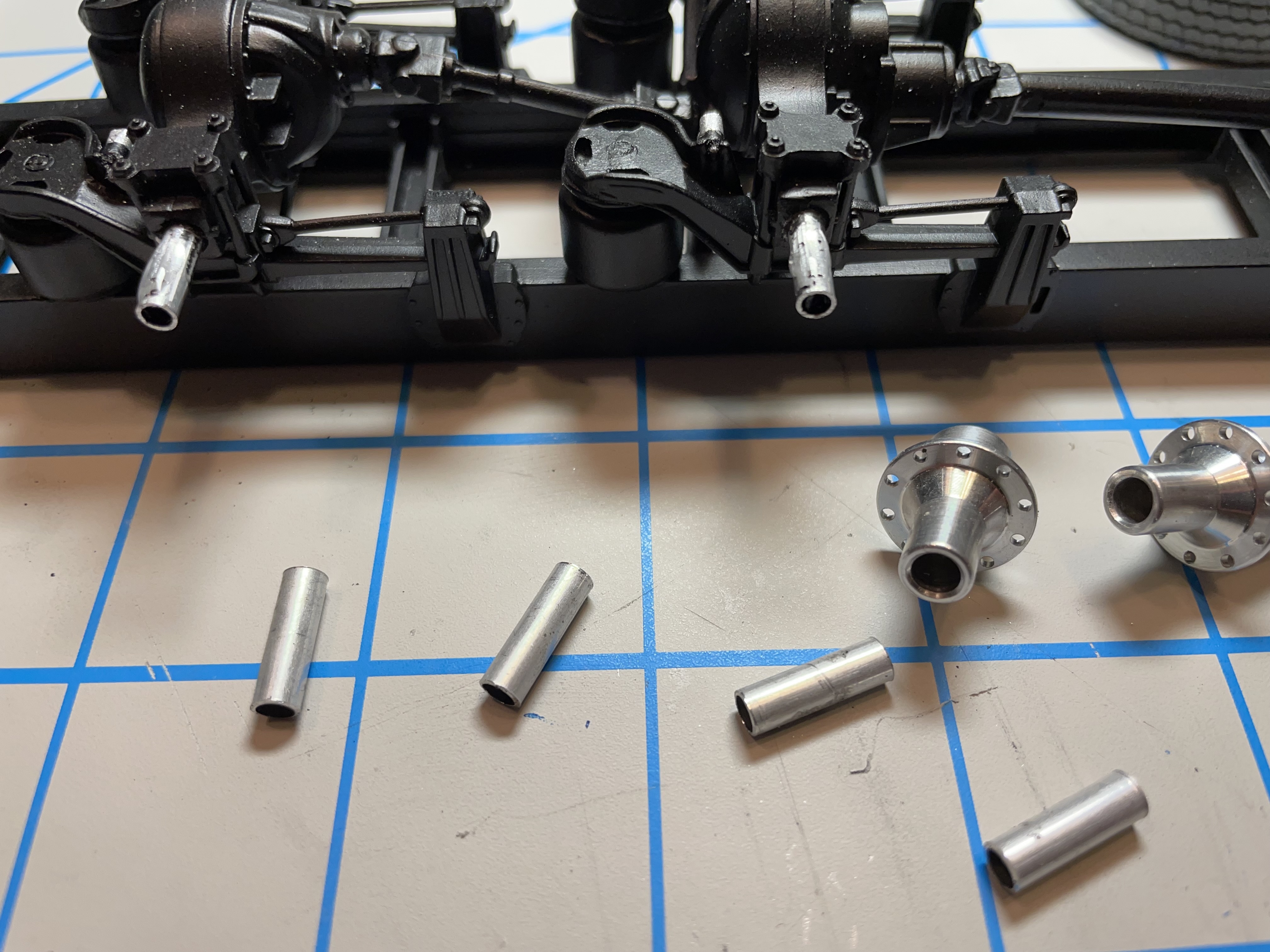

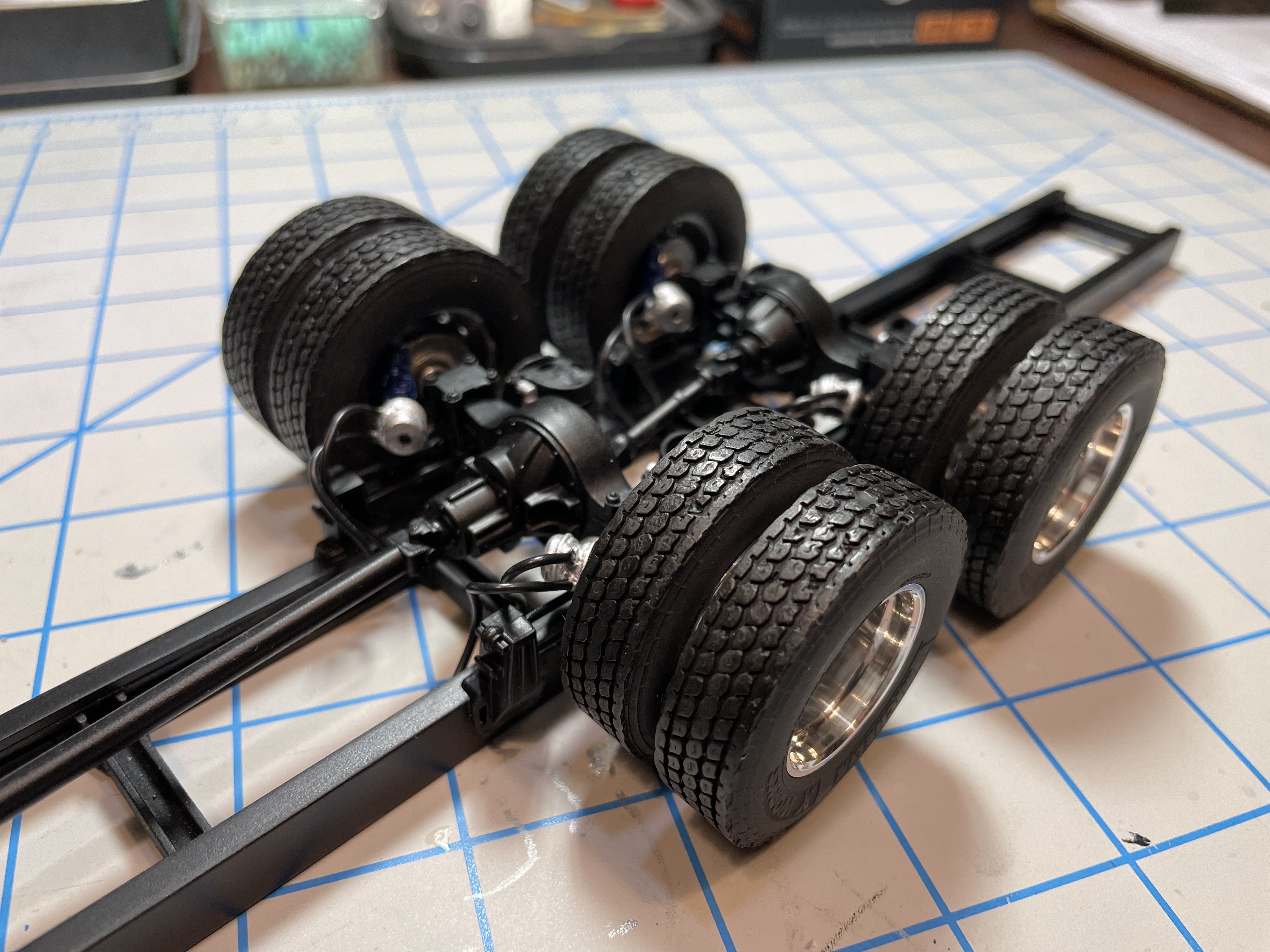

Another idea, I used metal tubing to reinforce the Italeri axles for my current 379-based RV project. The reasoning was to allow the axles to better support the weight of the body going on the chassis. It’s going to be a heavy build. I adapted the Italeri axles to mate with aftermarket aluminum hubs and wheels, resin disc brakes, and resin tires. But again, I wasn’t looking to make them roll, so everything is glued in place.
However, I bet the basic concept could be applied to the rear axles of Italeri kits with a solid rod or open tubing to make them roll as you describe. Try to drill out the axle to fit the rod or tube, and sandwich the two halves over it. Then, making sure it still rotates, glue the wheel sets onto the rod/tube. I’m not sure how you’d approach the front axle, or other brands, but other builders may have ideas.
IMG_6864.thumb.jpeg.fc7417c478c5739a1e4ed27fd84951c5.jpegIMG_7022.thumb.jpeg.bf995c57233016e26e942dfef3e440e7.jpeg

That looks pretty awesome Victor!!
