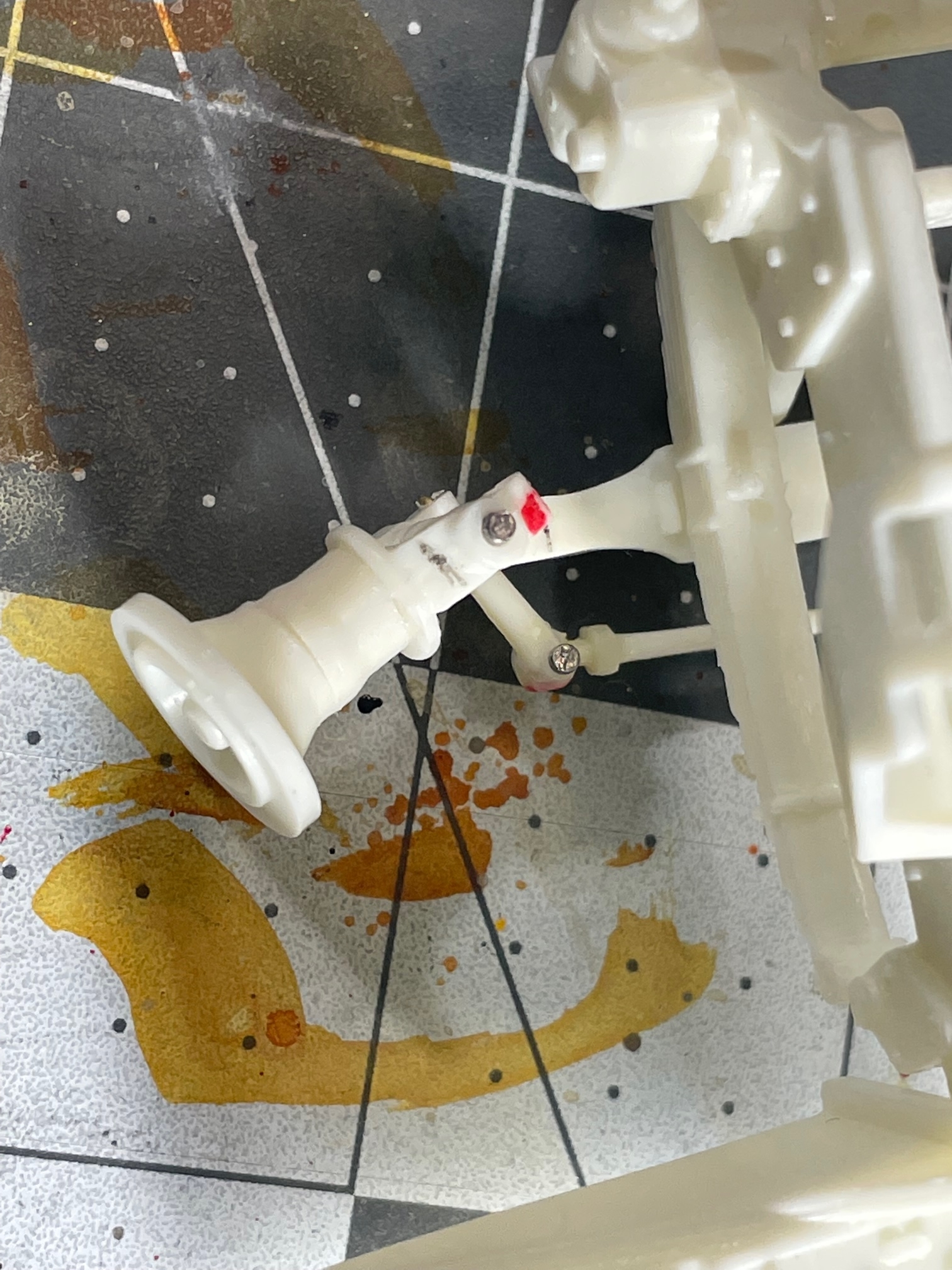

First up, the front axle and tie rod are  pinned with small nails.

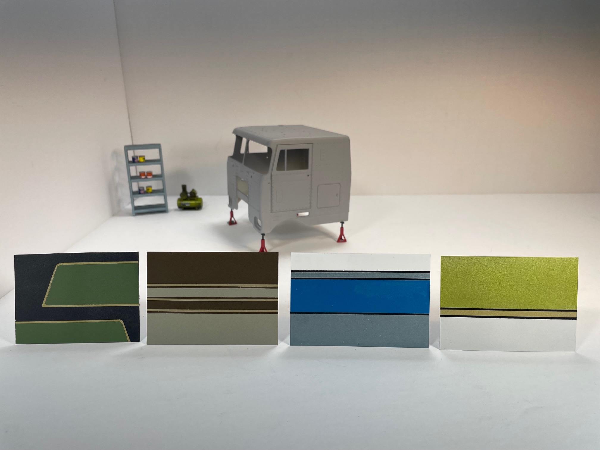

Next, working to develop  a concept for the build.
On the paint board are several photos from the internet printed on glossy paper.
Old trucker movies are also a good source of inspiration for those who want to capture the original colors of  "their time".

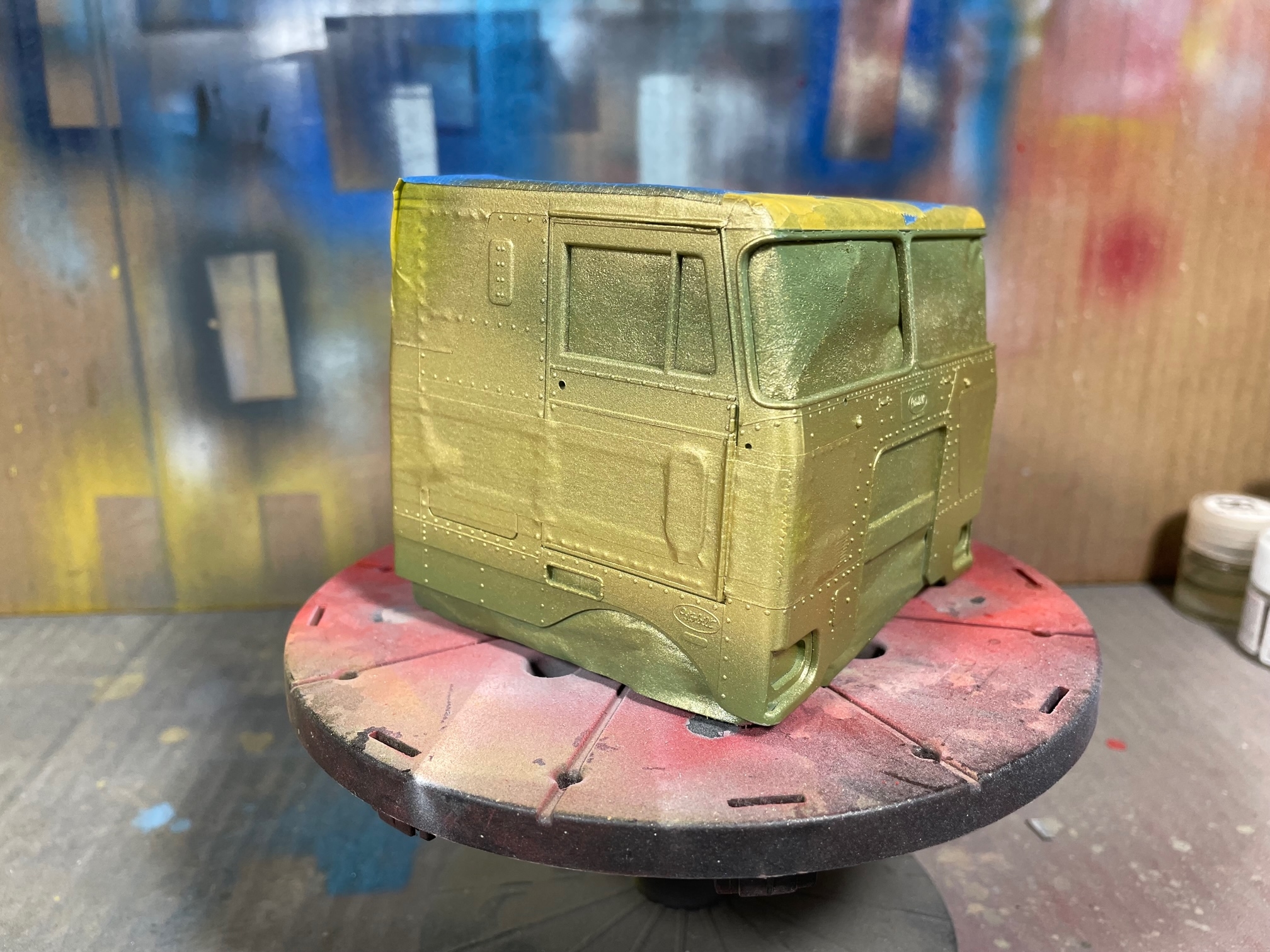

"Blue" on the right is giving me trouble finding  the right color match.  I will have to try custom mixing, but don't have any experience or feel for it.   My first attempts have been unsuccessful.
None of the box decals are ideal, so I will have to buy custom made ones or learn to make my own.   Does anybody have a good source?

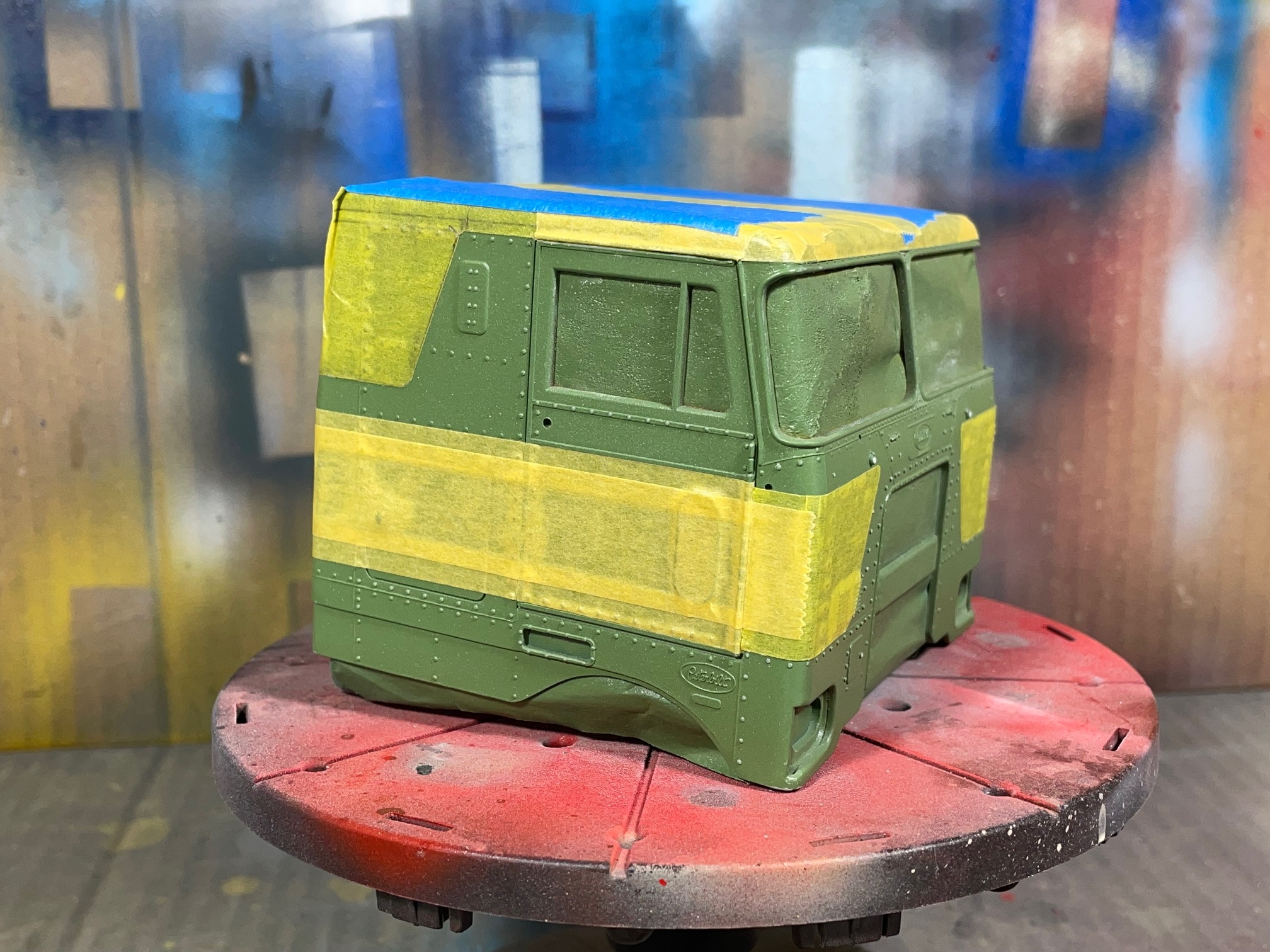

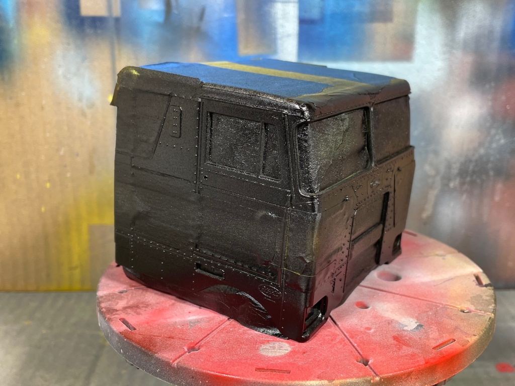

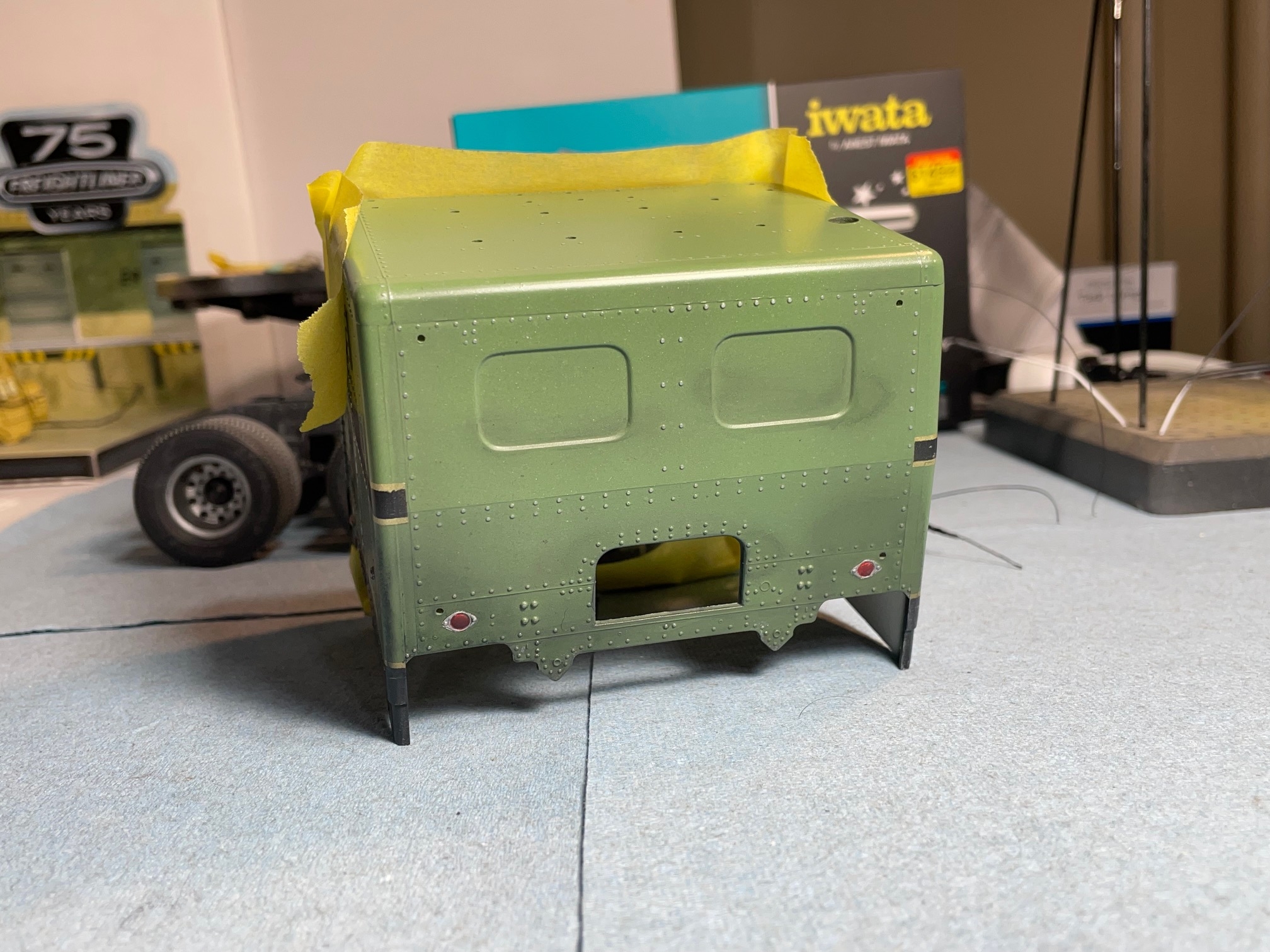

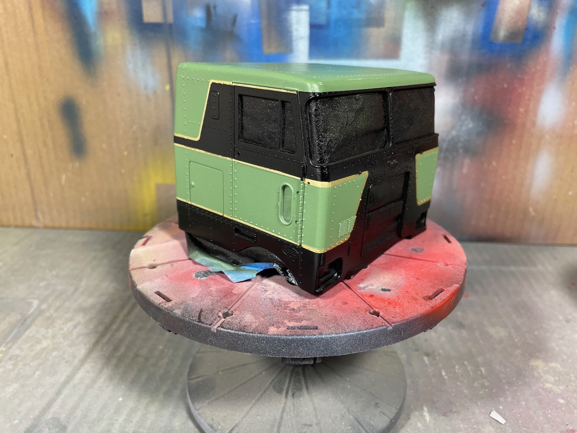

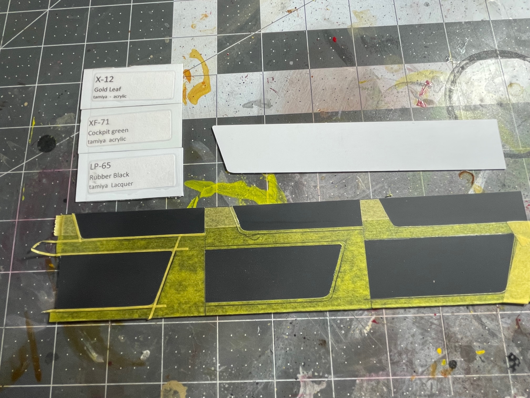

Up next is the paint trial.   I don't want to risk ruining the cab.   A template of styrene sheet was made to mask the body and try my hand at pinstripes.
3 copies initially  are made so that I can play with the  technique and the finish coat sheen.

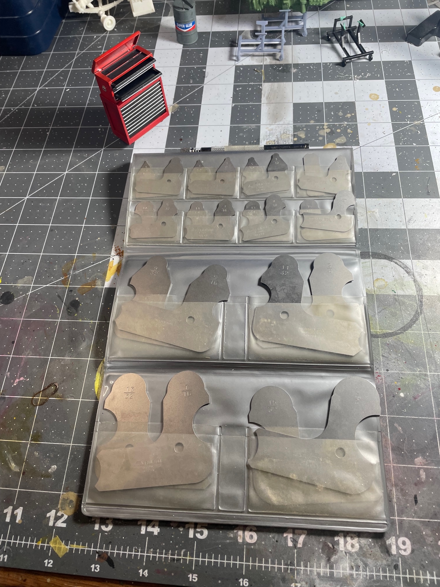

A set of machinists radius gauges comes in handy.

Tough decision. If it were me, I think I’d go with option #1 left to right. If fact, though you can’t go wrong with any of them, I think I’d rank them in order from left to right.

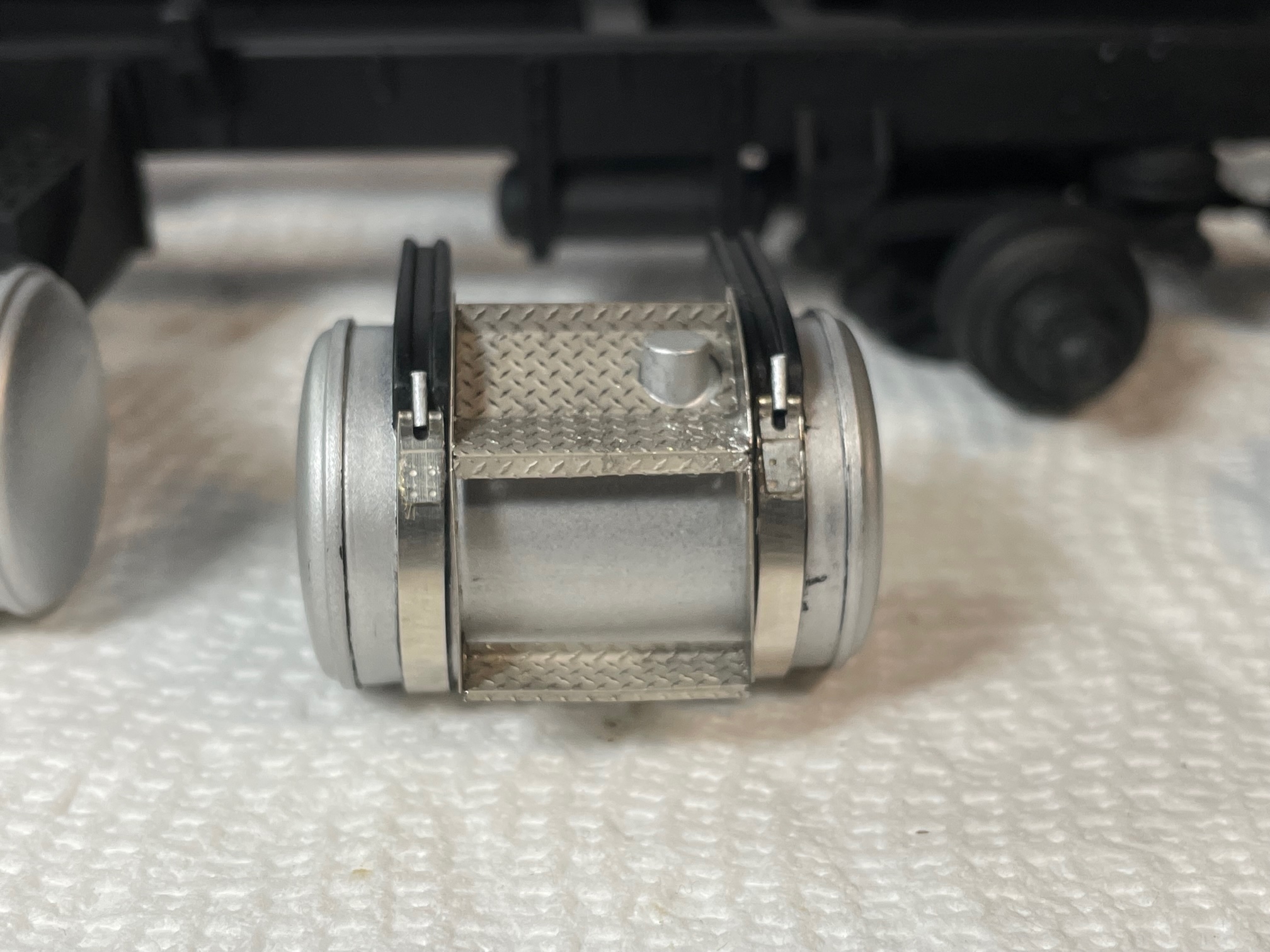

I have "embraced" PE (photo-etch) and am learning to work with the new material.
Every part is now a learning experience.
The details are removed.
The fuel tank steps and straps gave me lots of trouble with adhesion.  Most glues do not work well, and the steps had to be soldered.  IMG_2127.thumb.jpg.8e63a16e7c7a23c6713895c2173b1223.jpg

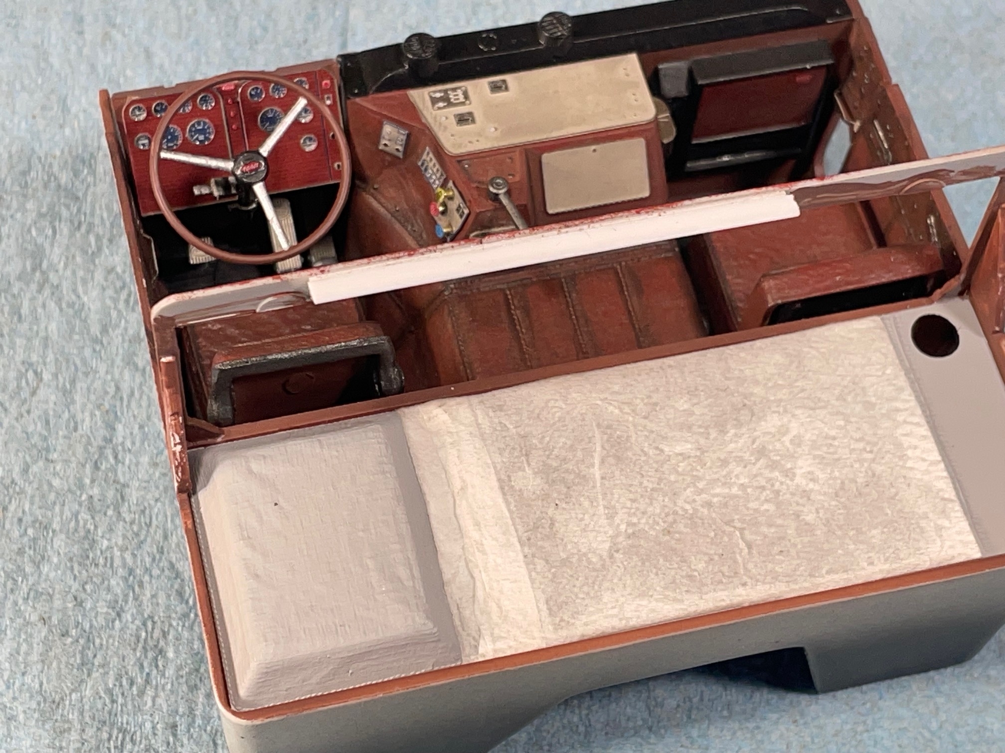

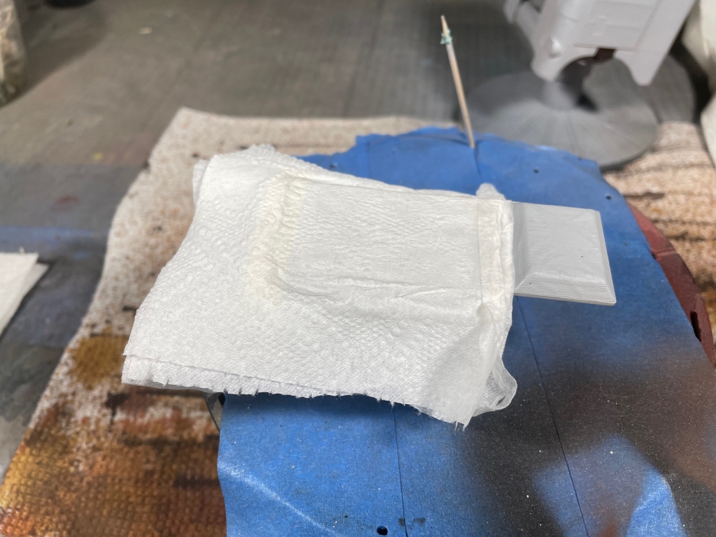

A piece of bathroom tissue is used with Elmer's Glue mixed with water.IMG_2873.thumb.jpg.ad3133861560dd892f03e22a070f9456.jpg

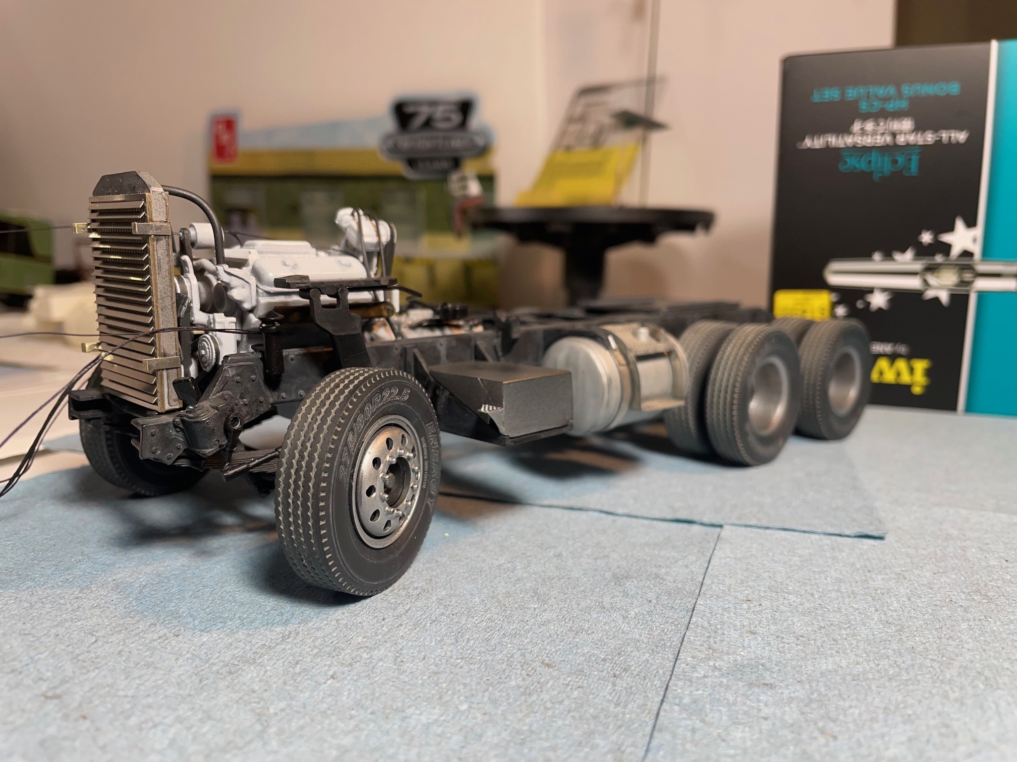

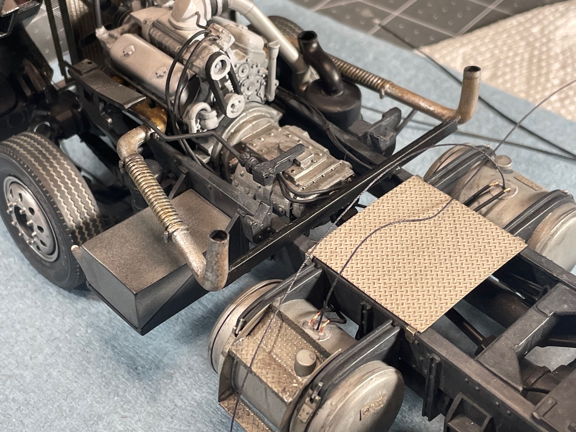

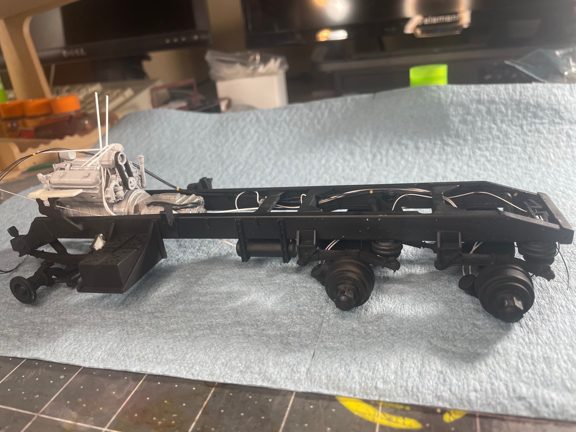

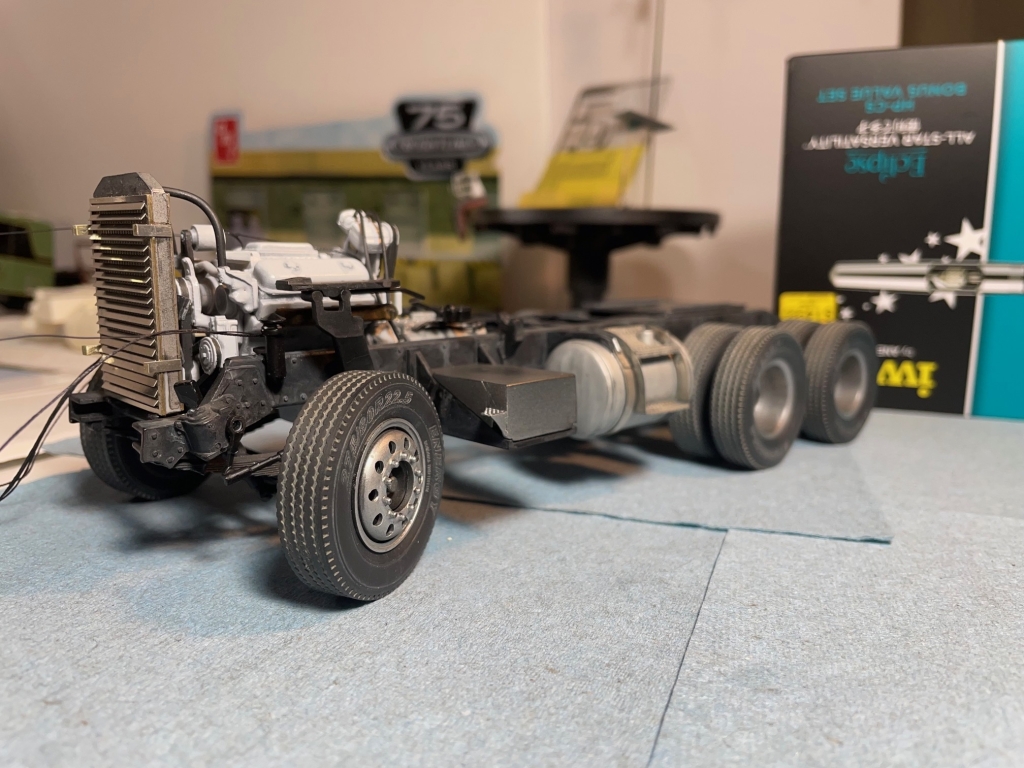

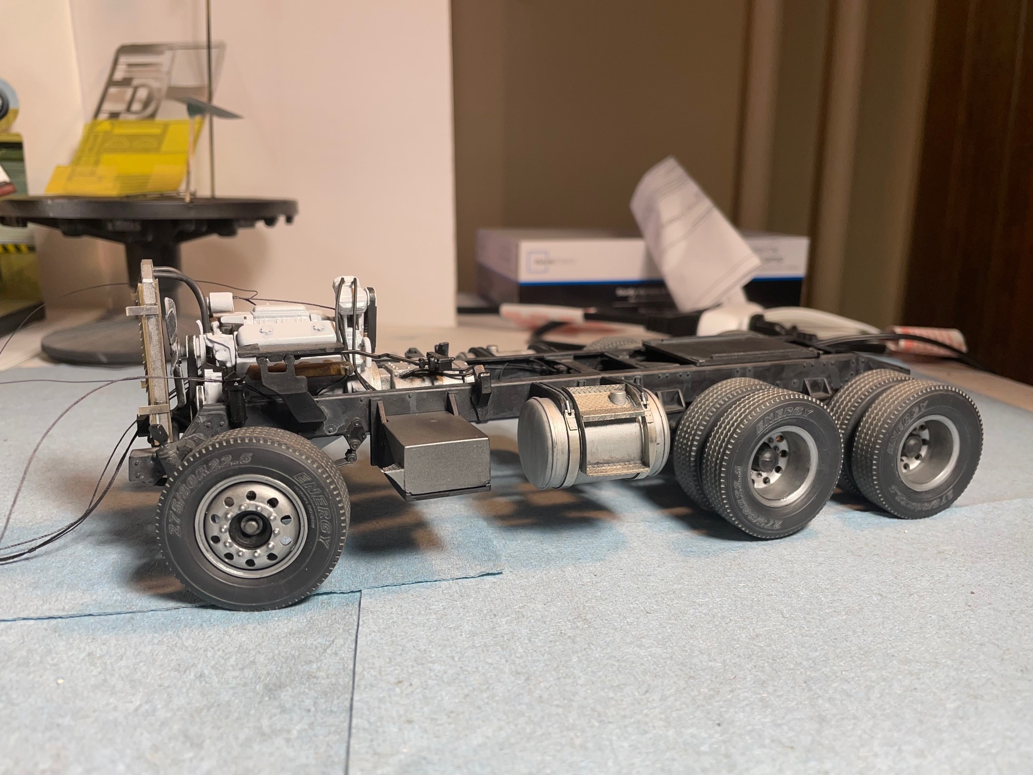

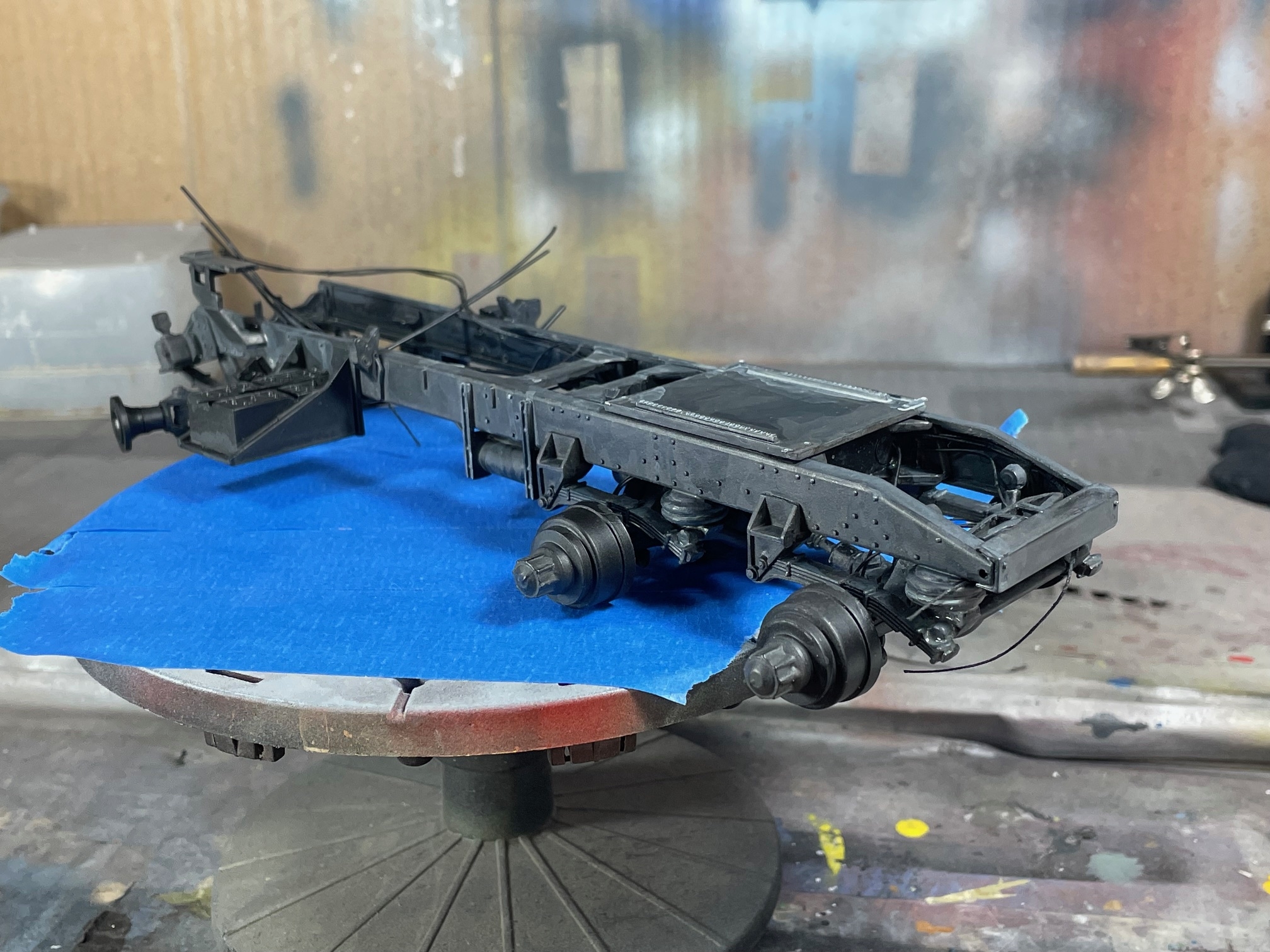

I have also taken the leap into adding some plumbing and wiring to this build.
Thin thread for electrical wire, .020" & .030" styrene rod for air lines, and telephone wire for the transmission.
The interior sub-assembly is finished and set aside.

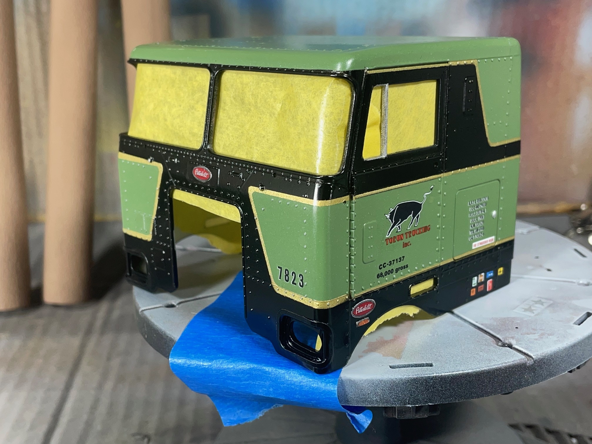

The frame gets some weathering.

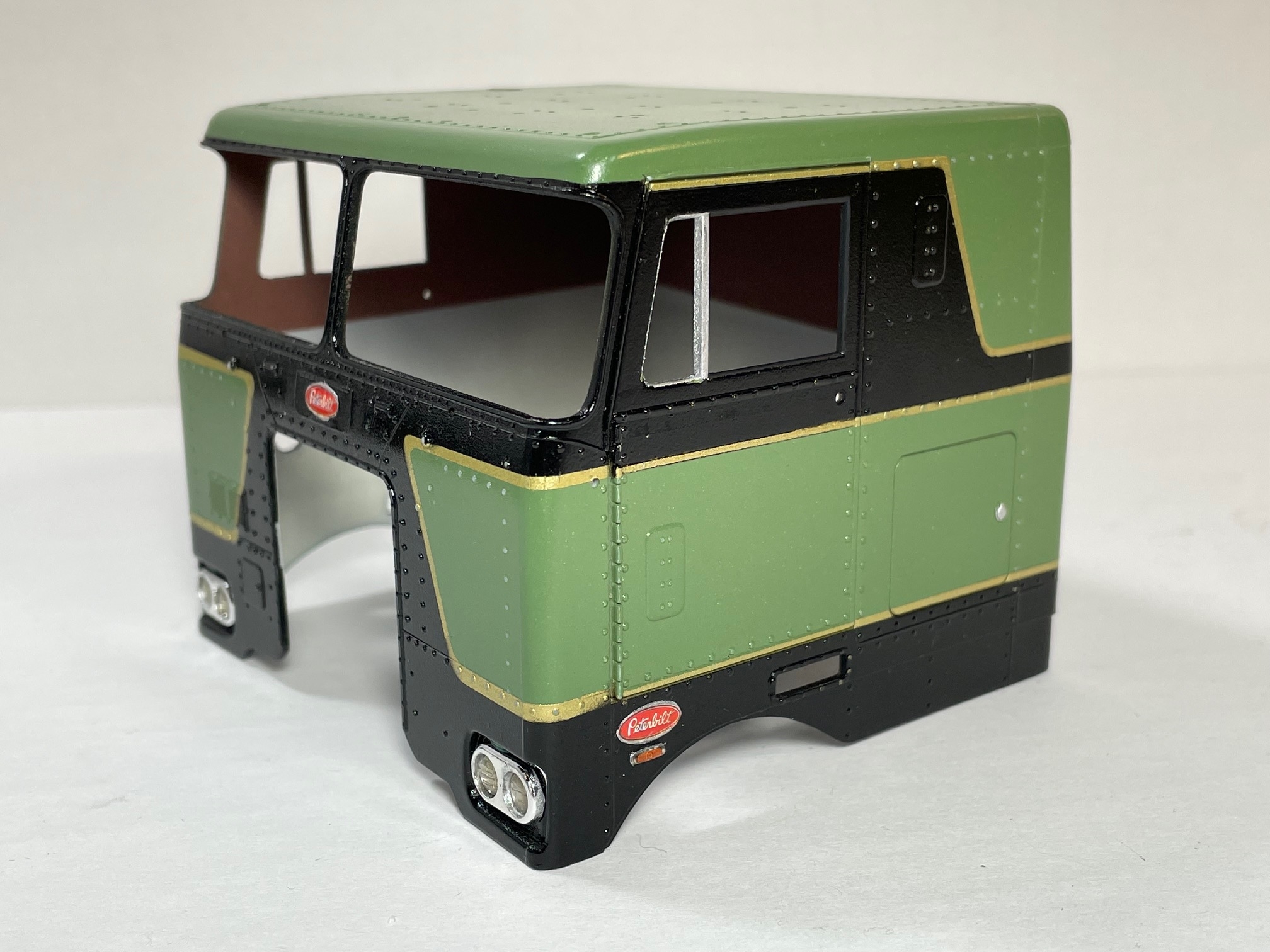

Added headlight bezels, which was a mistake to do so after paint.
I tried to remove the orange peel on the cab with Tamiya compound paste.  It is well hidden if the lighting and camera angle are right.
  • Thanks 1

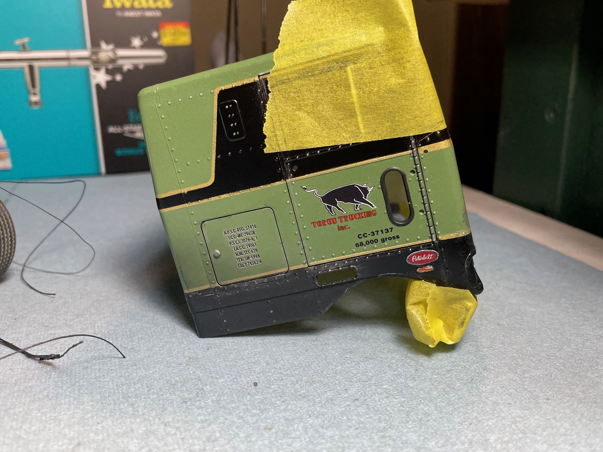

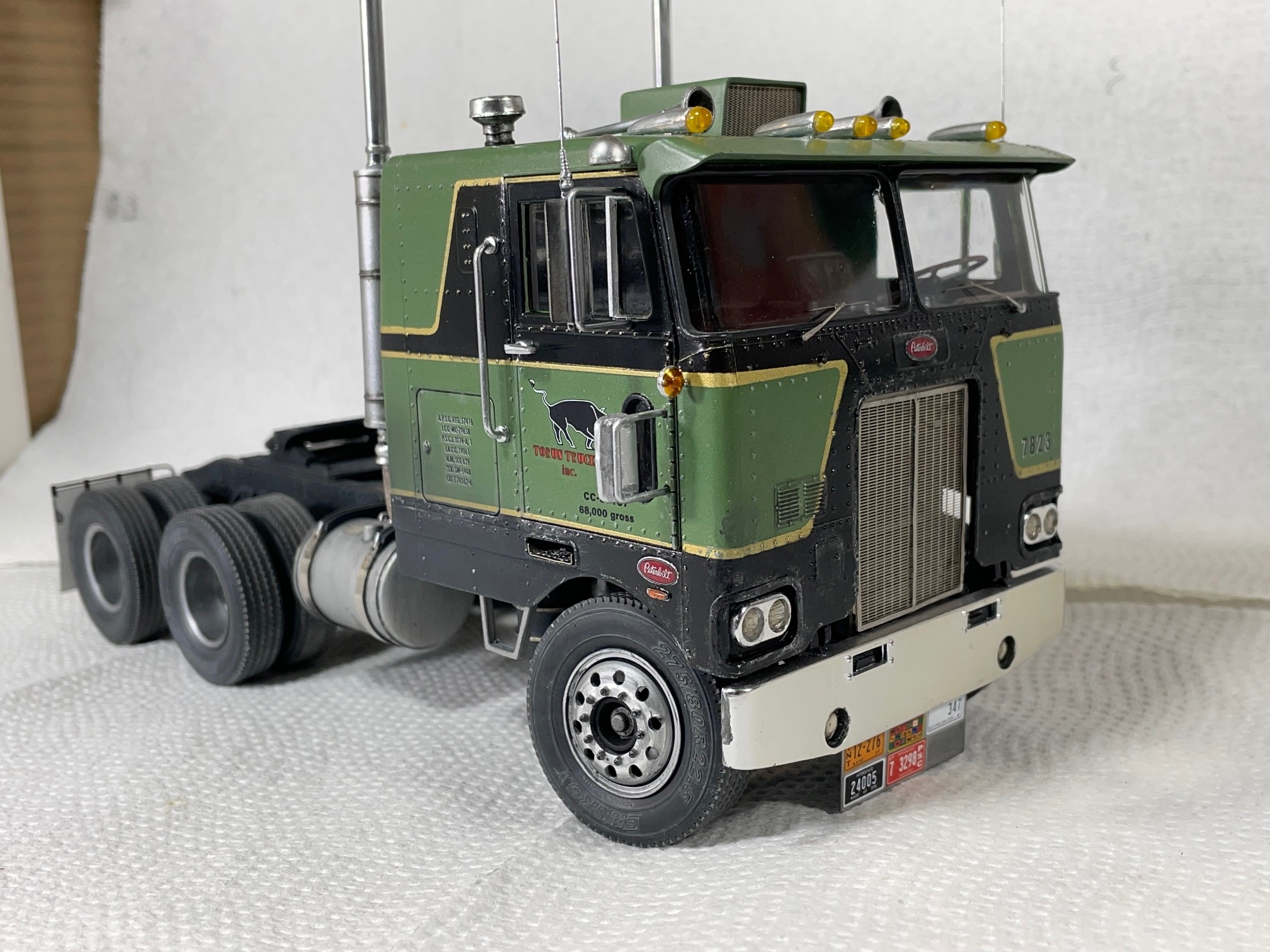

I used the white number decals, didn't like them so added the black ones over the top to look like shadow lettering.

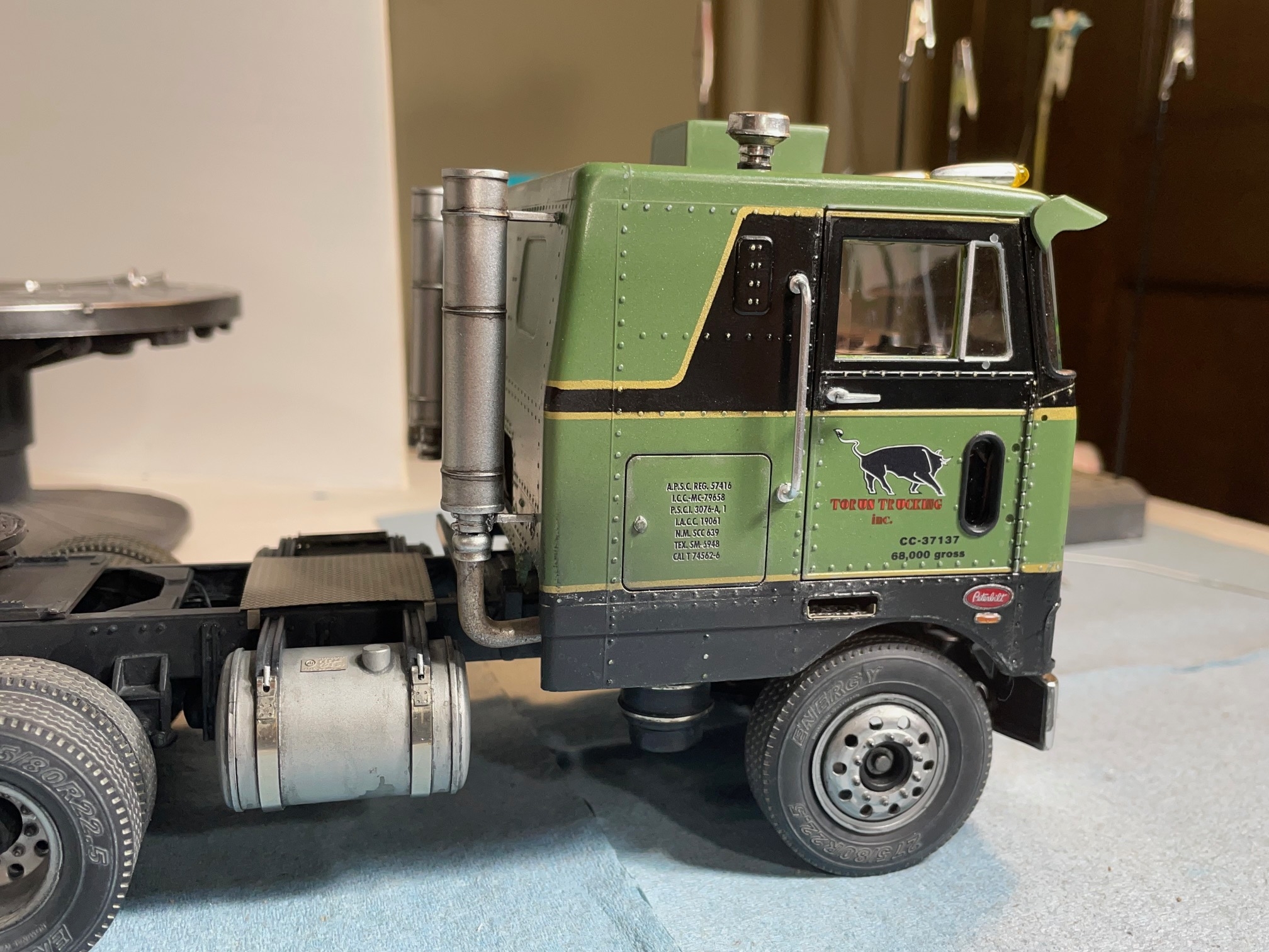

Working hard toward the finish line.
IMG_3217.thumb.jpg.b2301d6165b70e9f49d8b50f9f81c6b6.jpgIMG_3237.thumb.jpg.a7ff950691cd2fe3cd8bfe7a3577c267.jpg
Some very nicely done work
Adding grime to the cab using heavily diluted paint with a spray gun.   My favorite look is "in use" and am trying to learn the art of "less is more".

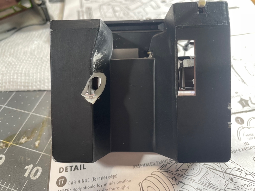

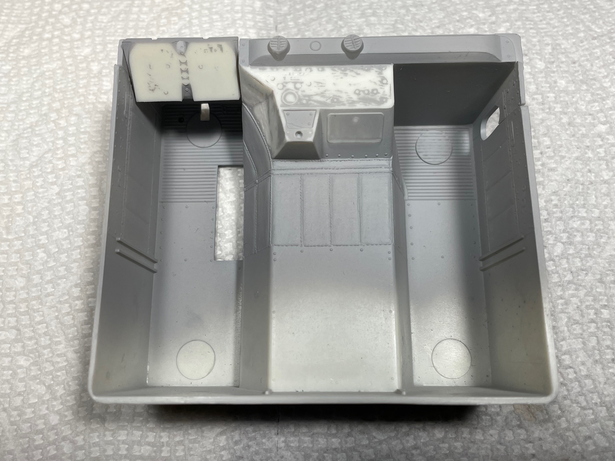

Booby trap !!!  I have come to expect "issues".  The interior tub had to be relieved severely to clear an interference fit  with the air intake pipe (93).
The shift plate (68) was also not cooperative.  (too high, too long)

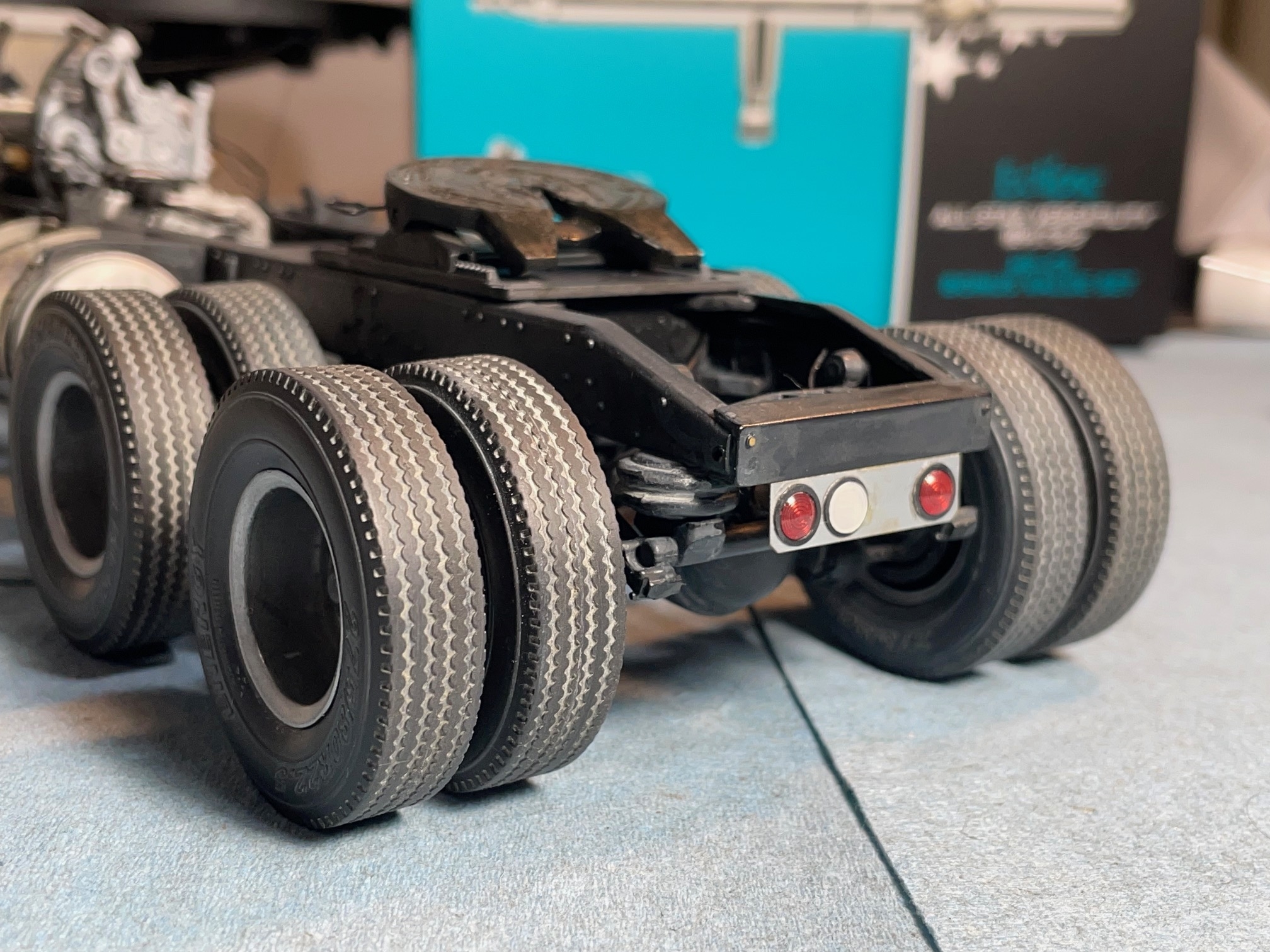

Copper tubing was used to fill the gap between the exhaust (95,96)  and mufflers.
Edited by 02fusoFG
Alignment of the exhaust was difficult.   I think they had to be shortened (horz.) and lengthened (vert.).
