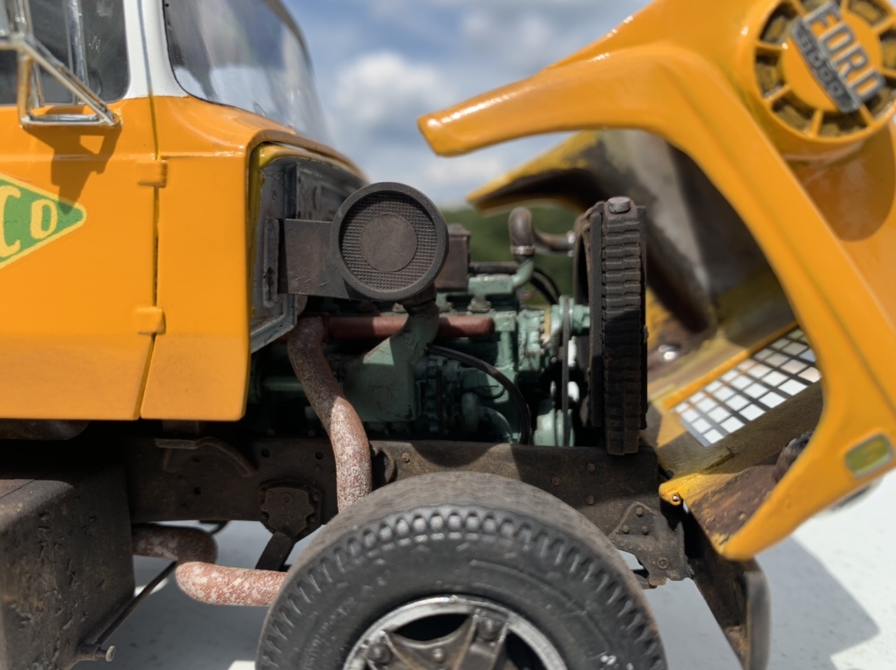

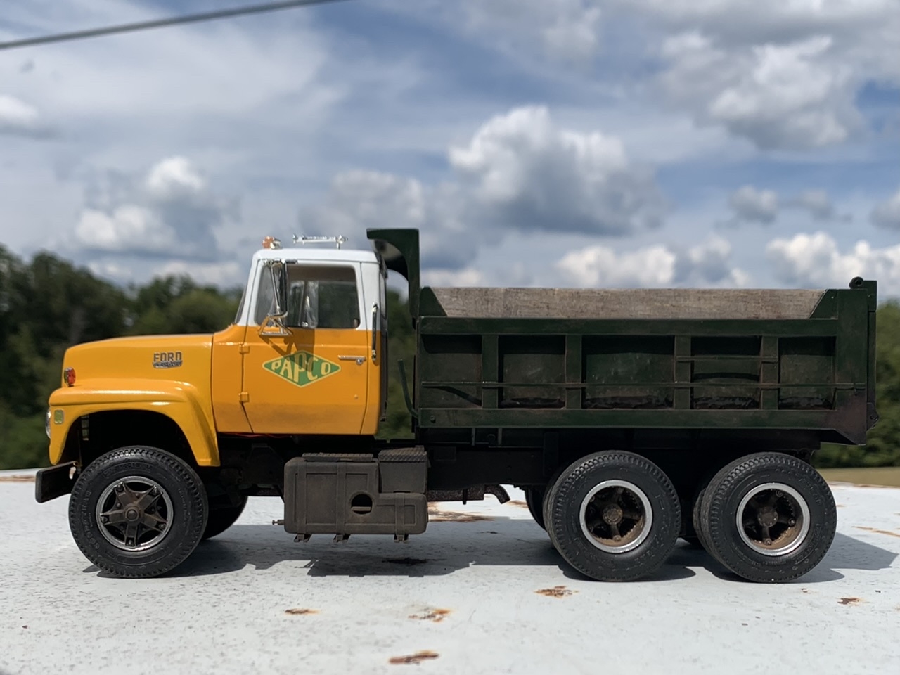

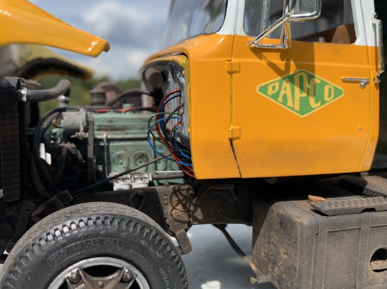

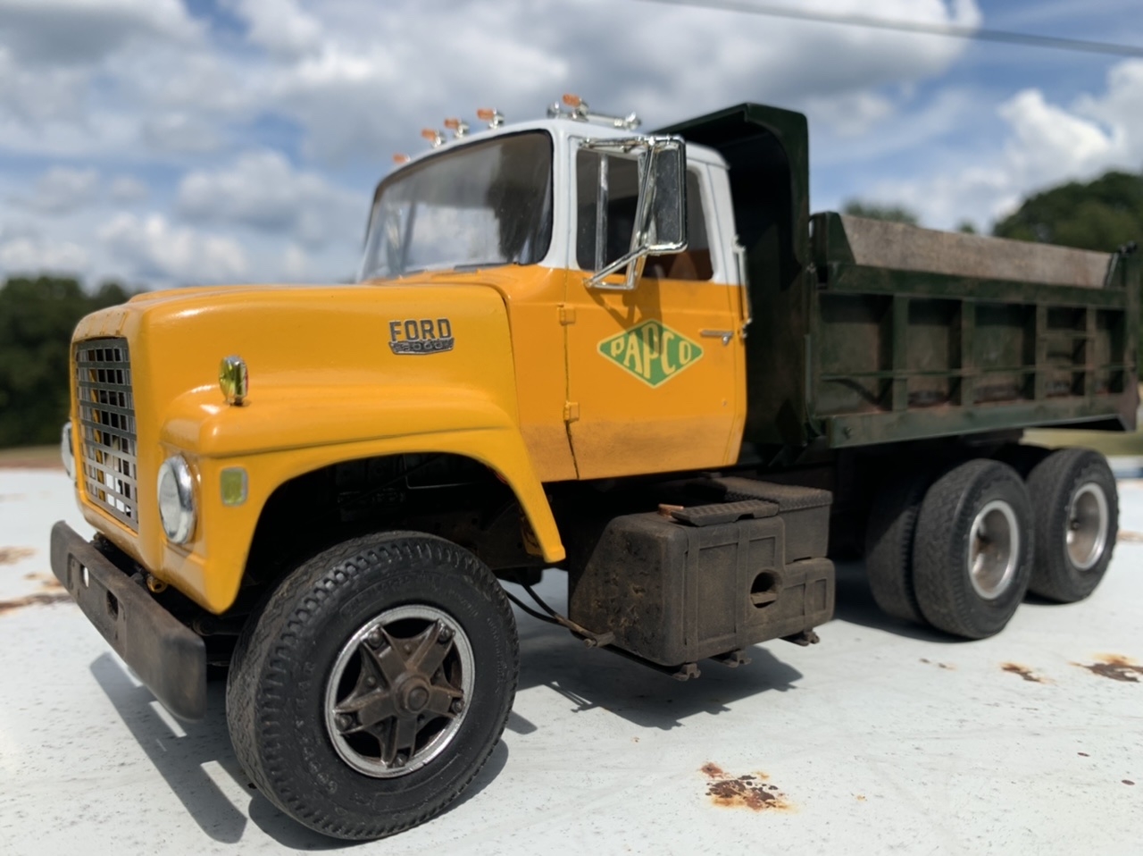

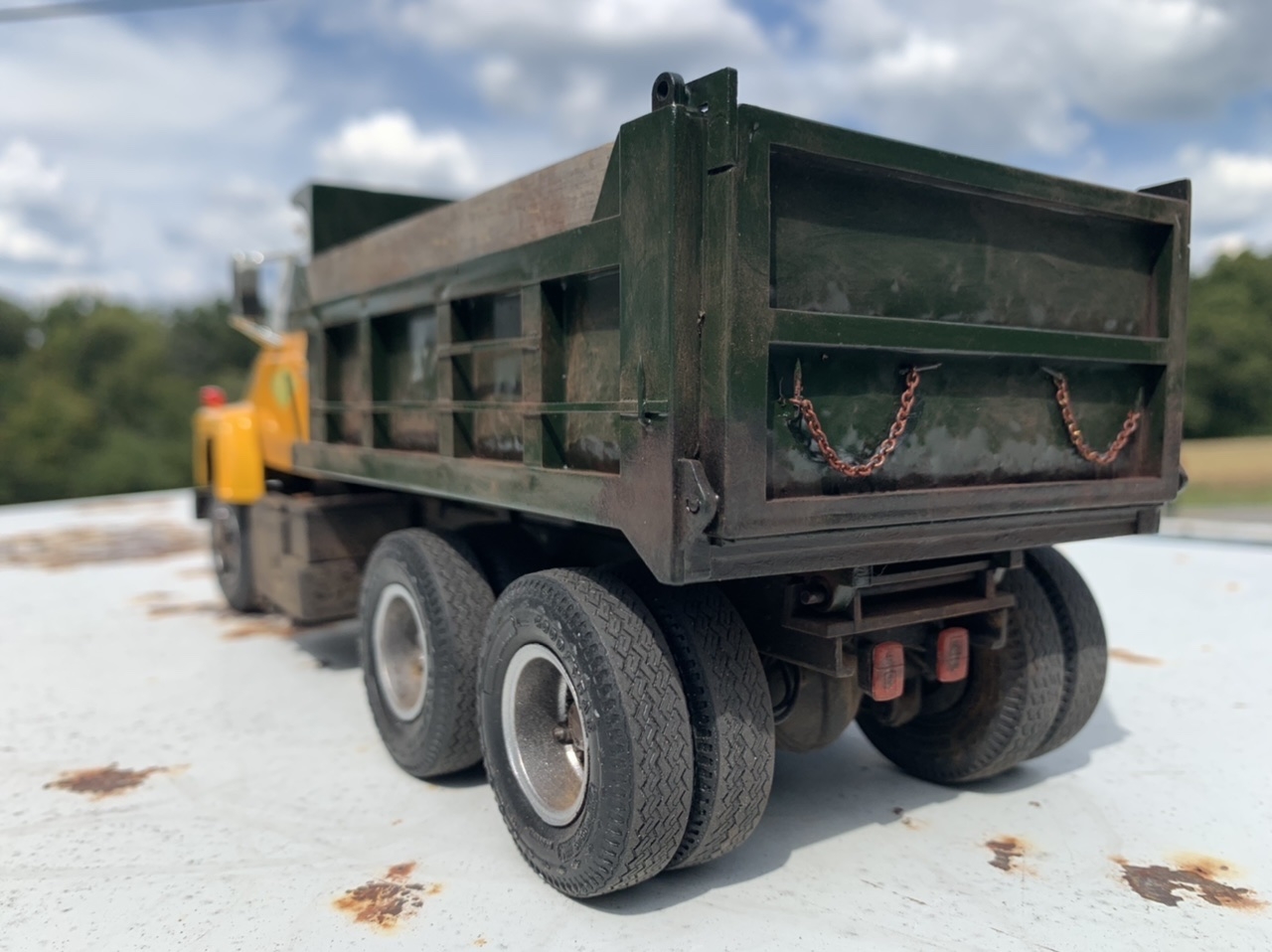

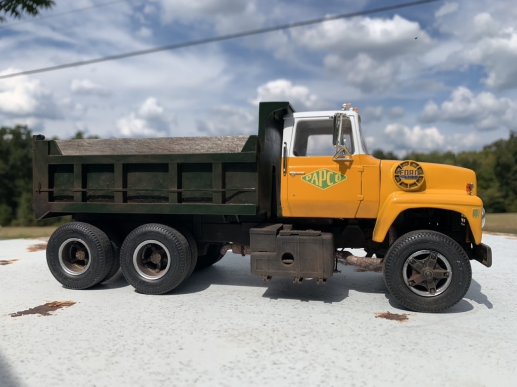

Looks great. The “happy accident” of the hood and cab color difference is actually really cool, and realistic. That often happens naturally in life as the elements take their toll on paint, or when parts are replaced or repainted. The weathering is excellent overall, with the subtle dents in the tailgate are looking great. Fine work.
Wow !
Love the well-used look -- you really nailed it.

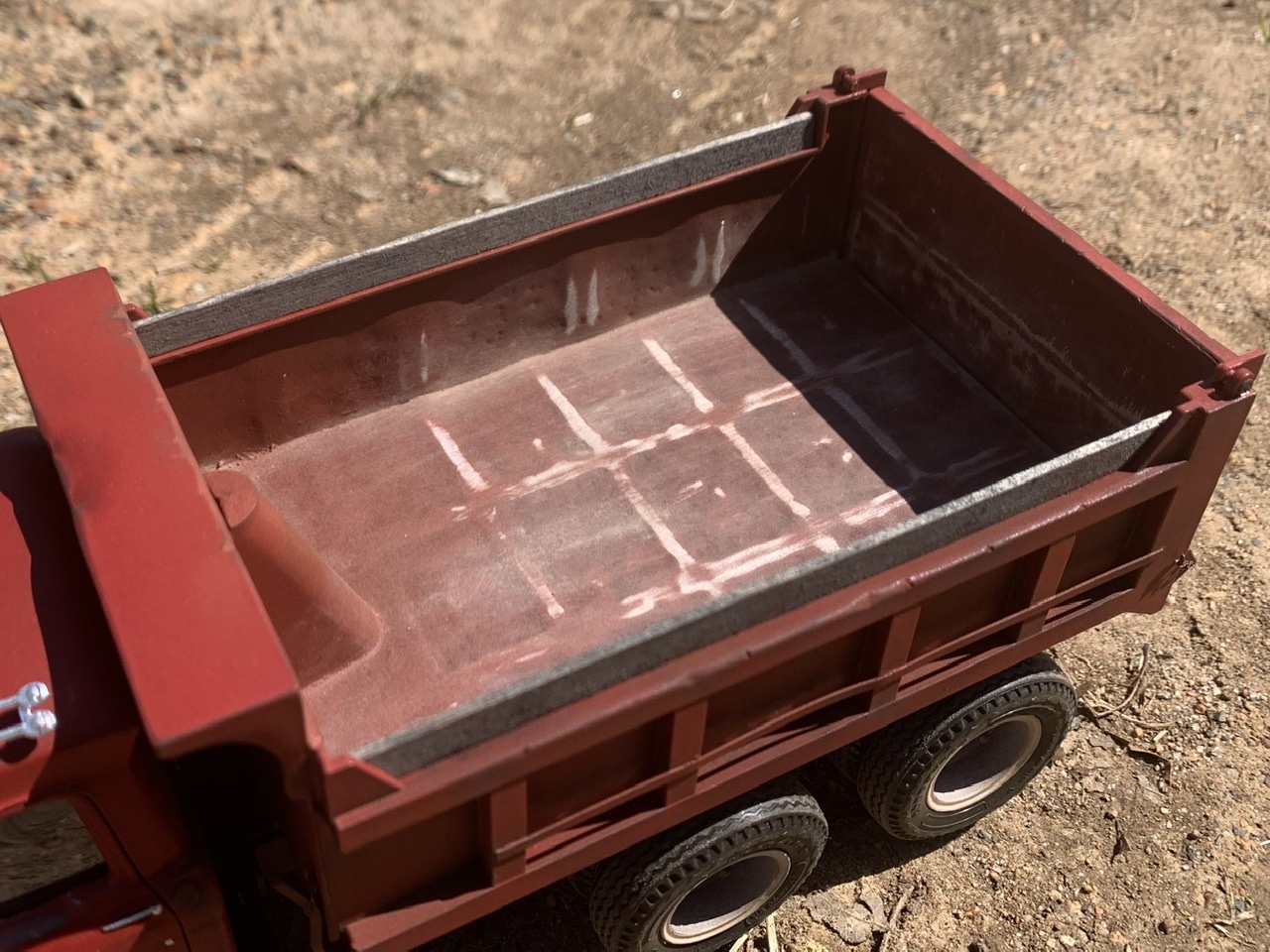

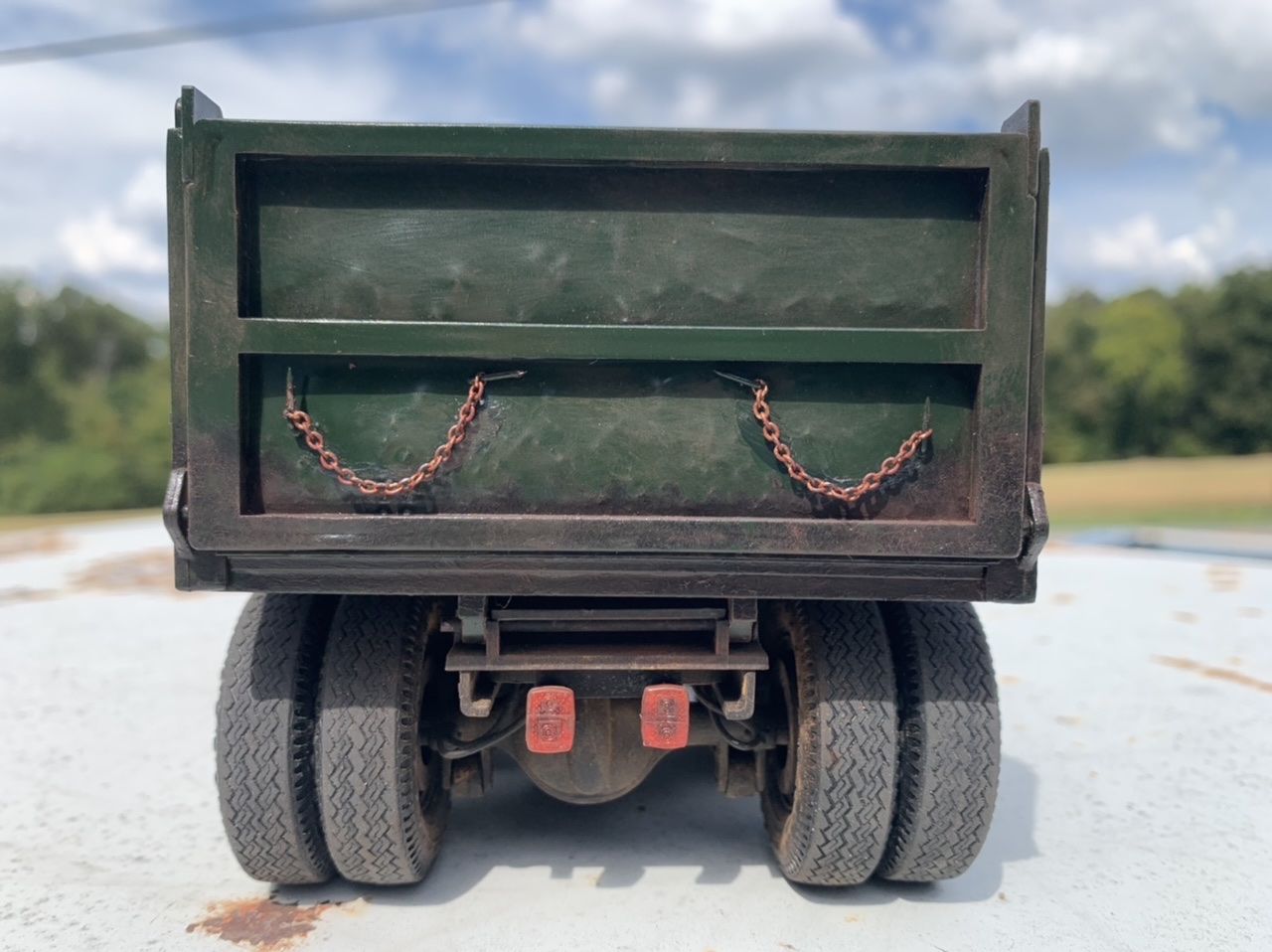

How did you achieve the dented look on the tailgate and dump bed sides? Is that some kind of fabric?
Thanks Vince!
45 minutes ago, Johnny M said:
Wow !
 Thanks Johnny! I use a very thin aluminum similar to flashing material. I glue it to the frame work and literally dent it after the glue has dried. The same effect can be done on the inside as well. Here is the inside of another ford bed that l did.
Oh that's so perfect -- thanks for sharing that.
Also, nice job on the top 2x6 rails. 👍
