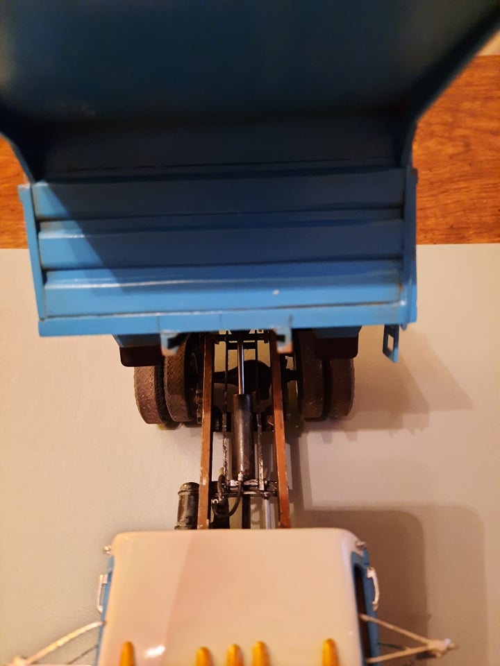

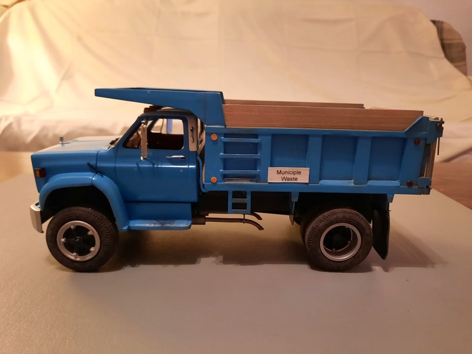

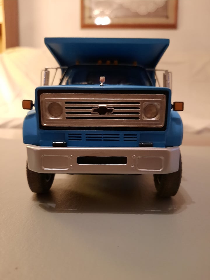

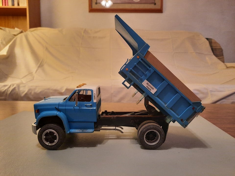

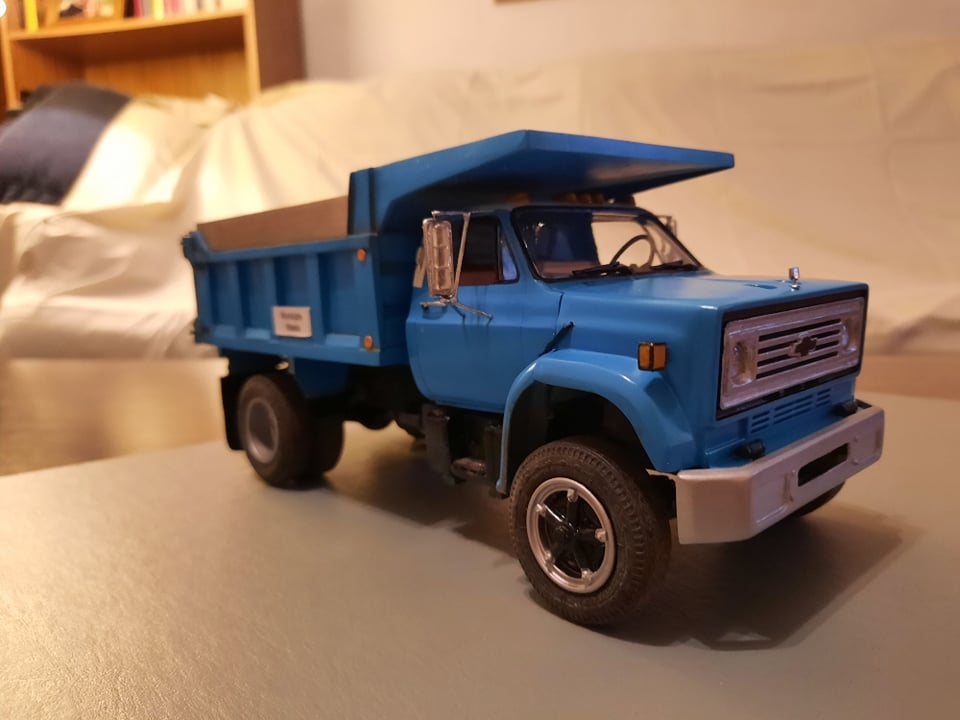

jpage Posted January 9, 2022 About 3 years ago I started a project to build a model of my son's dump truck and just finished it today. The interior, cab and front end is from the Revell snow plow truck kit with a shortened hood and scratch built fenders. The frame and front suspension, also shortened, came from the International 4300 kit and the engine, wheels, tires, cab lights and rear suspension came from a Dodge L700 kit. I also used the L700 body floor and fenders to fashion the rear of the front fenders. The fuel tank came from A.I.T.M.. The interior tub of the Chevy kit was poorly detailed, so new door panels were made and the seat was reworked. The rear cab window was shortened. The L700 steering wheel was used and the cab detailed, although you really can't see much of it. The bed, end gate, hydraulic lift, vacuum tank and battery box , bumper and mirrors are all scratch built. I was fortunate to connect with a guy on this forum, who 3 D printed a grille for me. This was a piece that I was really racking my brain on how to construct. His part is spot on and looks great! Originally, I wanted an opening hood, which on this model, flipped forward, but I was having issues with clearance and alignment while building the fenders, so I nixed that feature. Incidentally, the pic of the grille and rough hood was a practice piece. The final print was a perfect fit and replica. I did open the headlamps and installed lenses to add some realism. The mirrors are scratch built with fine wire and styrene and chromed with a Molotow pen. It's painted in acrylic paint with no sealer and replicates a worn but not shoddy finish, then lightly weathered to simulate use. This was a tough project for me as I'm not well versed in the scratch building realm and have been away from the hobby for about 40 years. My goal was to replicate as close as possible, my son's truck as it is today and still working! One thing I wish I could add is the decals, but I have no knowledge or equipment to do the white lettering. That would really make it look real! The photos do make it look better than it does in person! Because of the lighting, the paint looks a darker blue than what it is, and almost is exact to the original paint on the truck. The last couple of pics are of the real truck. I have the frame, running gear, bed and snow plow left from one Chevy kit, and another which is complete except for the windshield, which I managed to screw up during the build. I tried to remove some paint and marred the plastic. it could probably be sanded and polished but I don't have the material for that. What do they say, "if something doesn't go wrong, you're not trying hard enough"! I also have a few parts left from the L700 kit and I have no use for any of these kits now that the project is finished. If anyone is interested, we can work out a deal! Enjoy the pics. Share this post Link to post Share on other sites

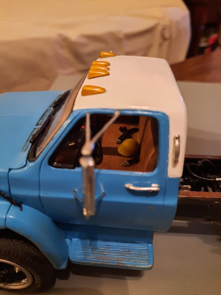

jpage Posted January 11, 2022 (edited) The hard part, for me, is that the fenders are not flat. They angle away from the body and have the curves. The rear fenders are peaked in the center rear section and angled away from the cab for door clearance. it's hard to see on the model. The fronts were laminated and pieced to get the contour. The fenders were the hardest part of the build. Can you tell me where on ebay you found it. I can't locate anything; I'd like to see it. Thanks Edited January 11, 2022 by jpage Share this post Link to post Share on other sites
