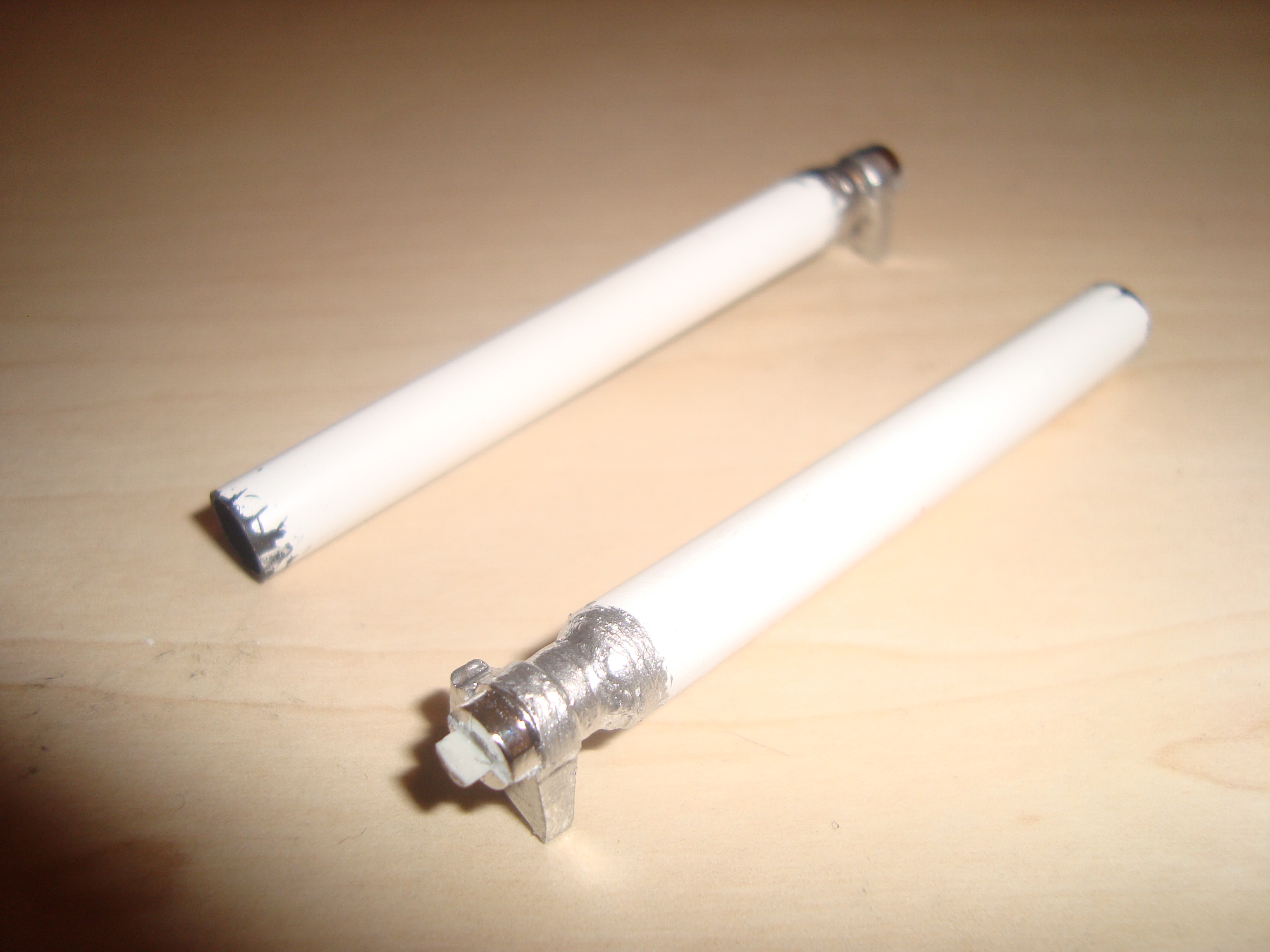

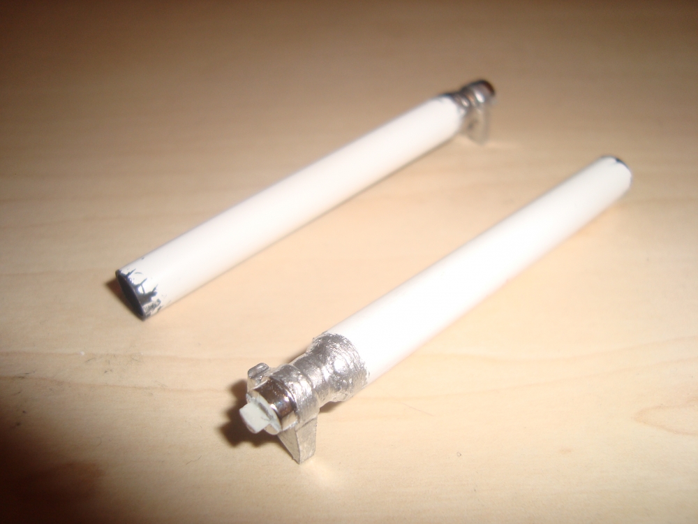

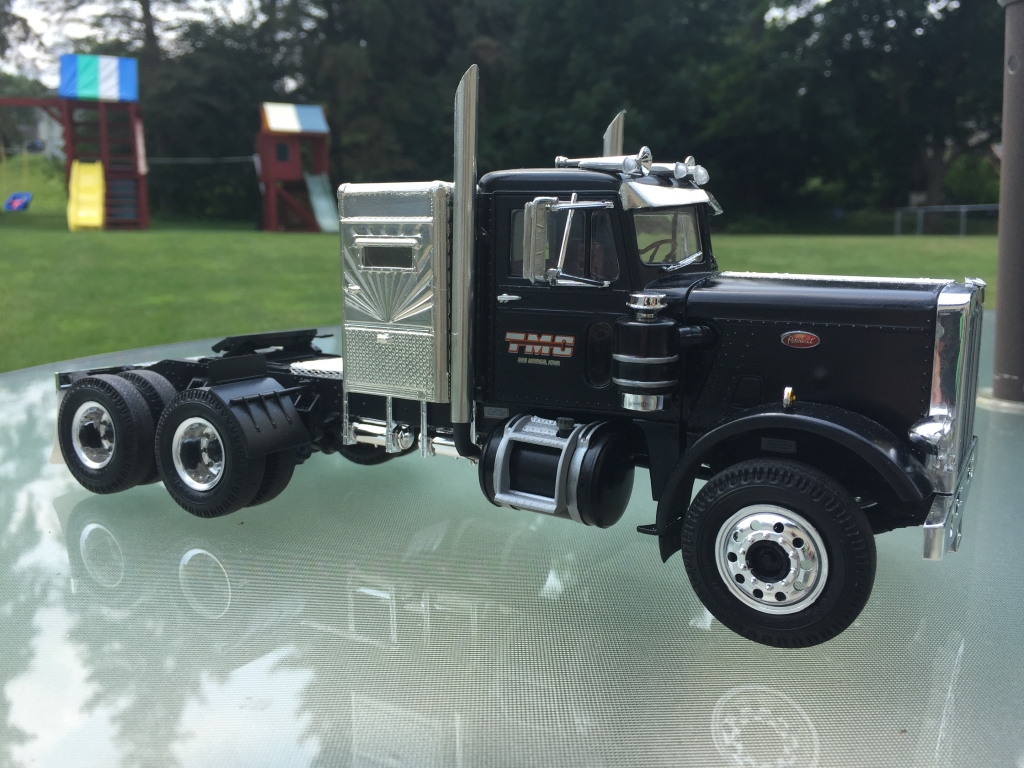

0 Joris Report post Posted September 23, 2015 For my Pete 388 I did the exhaust tips only; styrene piping, filler and BMF. More like a wing and a prayer, but it worked... 1 Share this post Link to post Share on other sites
