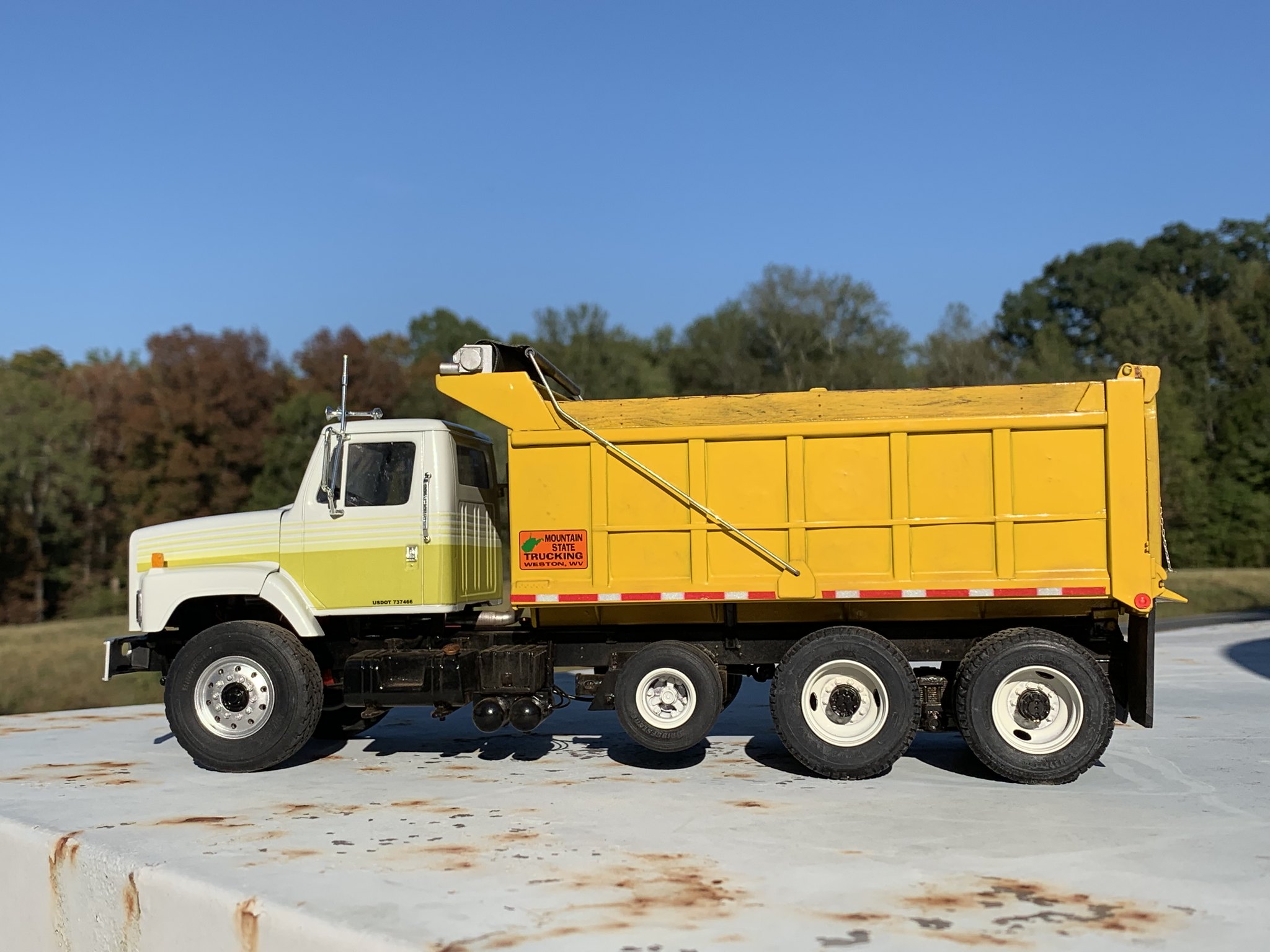

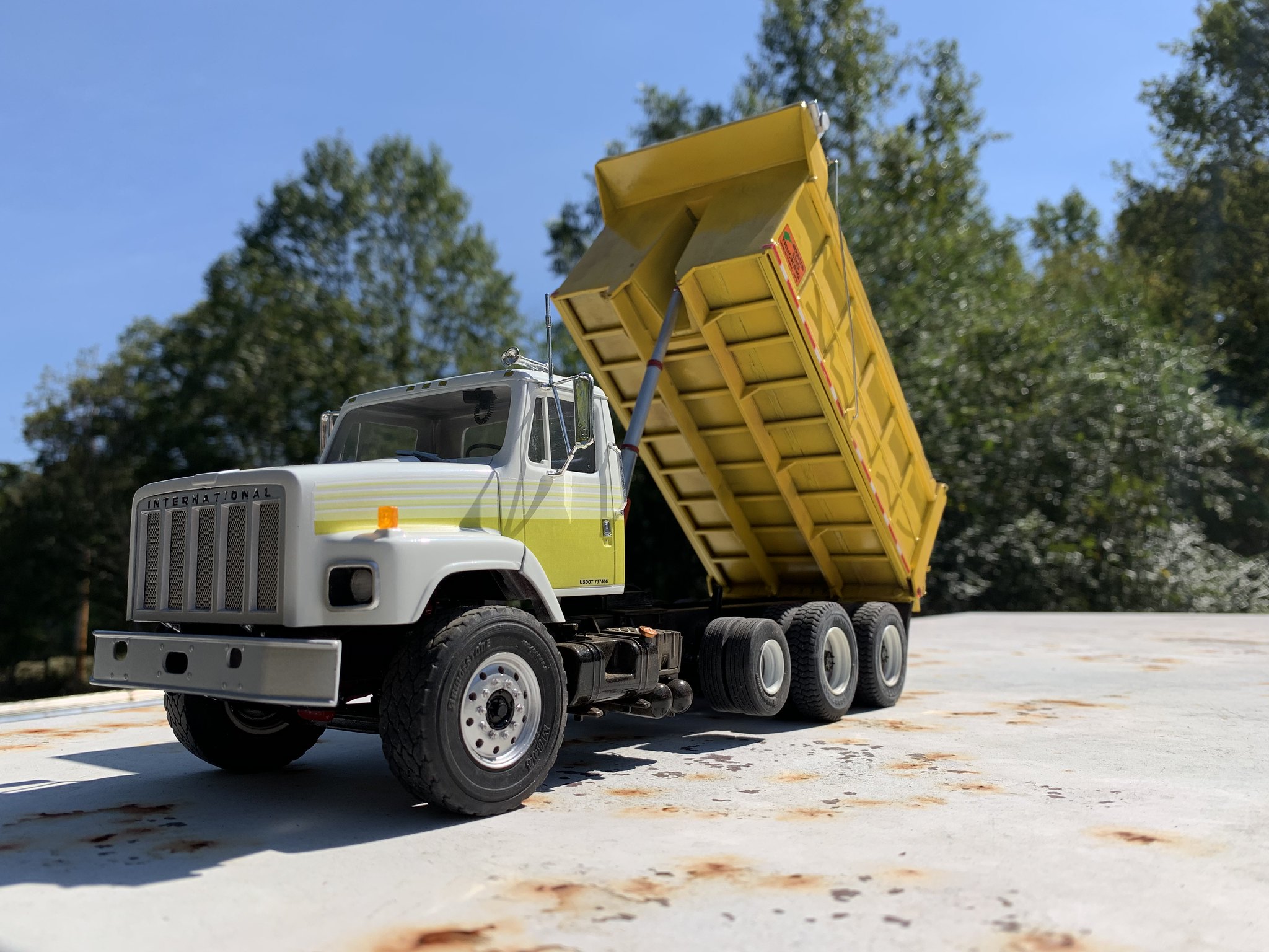

DRIPTROIT 71 Posted October 4, 2019 This one began with the Ertl kit. The engine is a 6v-92T Detroit diesel. The dump bed was modified. It is meant to look like a refurbished truck that has found new life from someone wanting to start out in the dump trucking business. IMG_4675 by Brian Smith, on Flickr IMG_4646 by Brian Smith, on Flickr IMG_4650 by Brian Smith, on Flickr IMG_4639 by Brian Smith, on Flickr IMG_4641 by Brian Smith, on Flickr IMG_4625 by Brian Smith, on Flickr IMG_4666 by Brian Smith, on Flickr IMG_4676 by Brian Smith, on Flickr IMG_4685 by Brian Smith, on Flickr IMG_4693 by Brian Smith, on Flickr 3 Share this post Link to post Share on other sites

DRIPTROIT 71 Posted October 20, 2019 On 10/12/2019 at 3:20 PM, Sam I am said: Brian, before I saw what you did with this box, I just wanted to throw them away they looked so ugly. Now I want to know exactly how you modified it so I can copy it. 🙂 Sorry to take so long getting back to you. I've been out of town for a week for my wife and I's 20th anniversary. The first thing that I did was widen the bed close to 4 scale inches. This was to make it look right to me with the larger tires. I then lowered the sides. These beds always looked like coal beds to me and way too tall. I then took the backside of a hobby knife and cut a groove in the lower outside brace. This is for my aluminum sheeting to slide into. I sheeted both sides with thin dented aluminum. i sheet all of the inside with aluminum too. I cut the upper board off of the kit side boards. I shortened the rear tailgate frame. I made new outside posts from stryrene. I made a new cab guard with a scratch built roll tarp. The tailgate is framed in styrene and sheeted with aluminum. I made a new cylinder from the kit base and aluminum tubing. The mudflaps are rubber, made from an inner tube so that they will flex when the bed is up. Share this post Link to post Share on other sites

DRIPTROIT 71 Posted October 28, 2019 On 10/24/2019 at 12:04 PM, Darrell J said: Nice build. What is the length of the box that you built. Thanks!! I didn't change the length of the kit bed. It is real close to 15' in 1/25 scale or 180mm. Share this post Link to post Share on other sites
