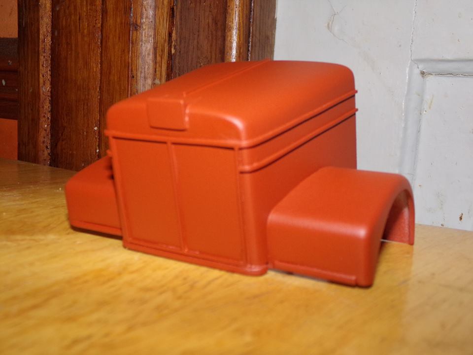

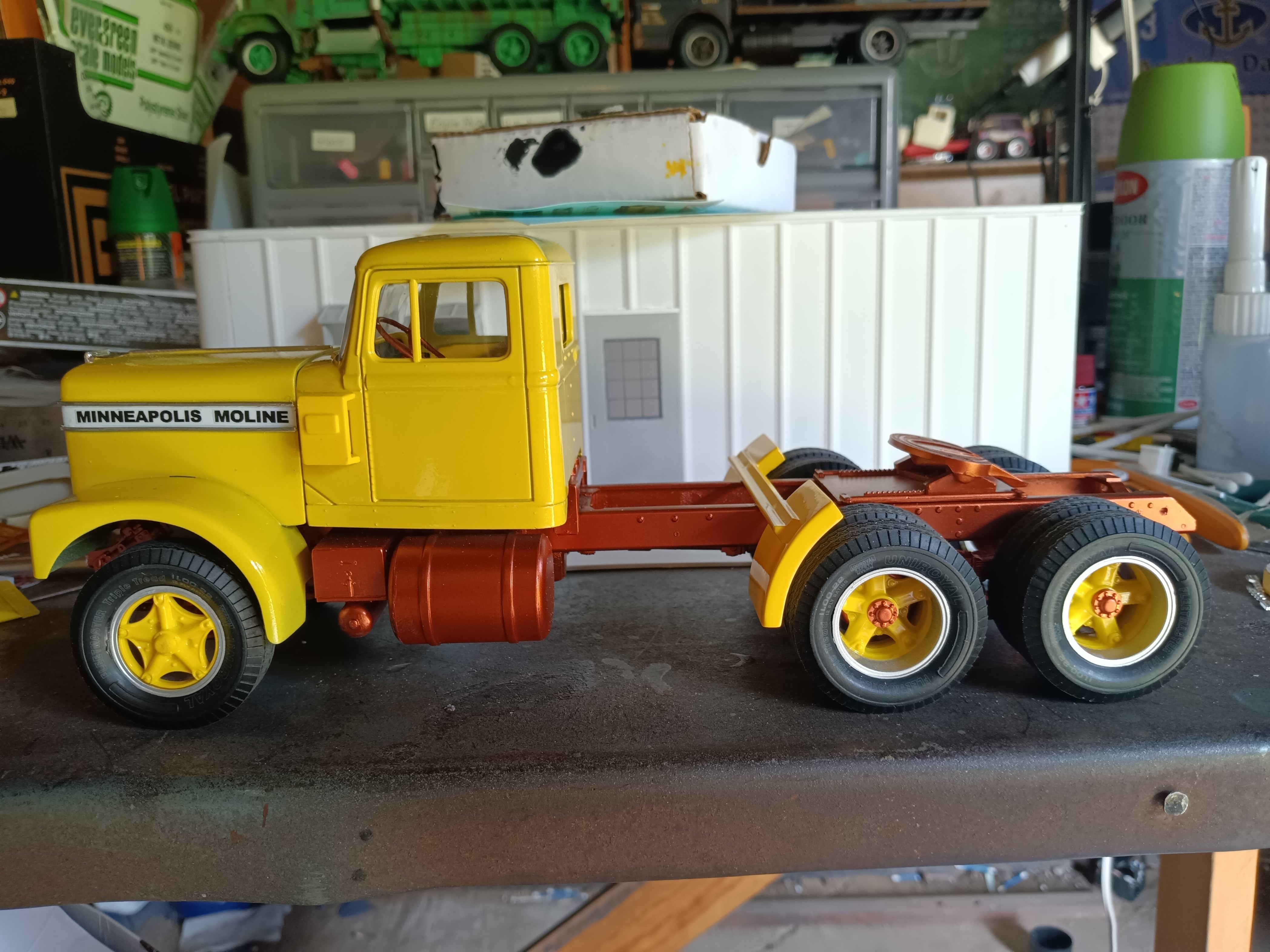

Chuck Most Posted November 15, 2017 This *should* be a fairly simple project. The idea here is to take the 1972-ish Diamond Reo kit and backdate it to a 1966 Reo GH. The main cosmetic difference is the hood. Though the shapes and basic cues are similar, the Reo does have a few unique features. Here's an example of a "late model" Reo, just before White Motor Co. merged them with the Diamond T division... REO, very late model by Dick Copello, on Flickr Here's an ad touting the benefits of Royalite with a similar hood but a slightly different grille insert. And here's where I stand with the project so far... The basic hood from the Diamond Reo kit was assembled as intended. I stripped the chrome from the grille and lower fender trim and added that as well- it'll be treated to Bare Metal foil later on. I filed the grille smooth and glued it into place, then created a new grille surround and trim from Evergreen strip. My big problem might be getting the tainty Reo V emblems right. 2 Share this post Link to post Share on other sites

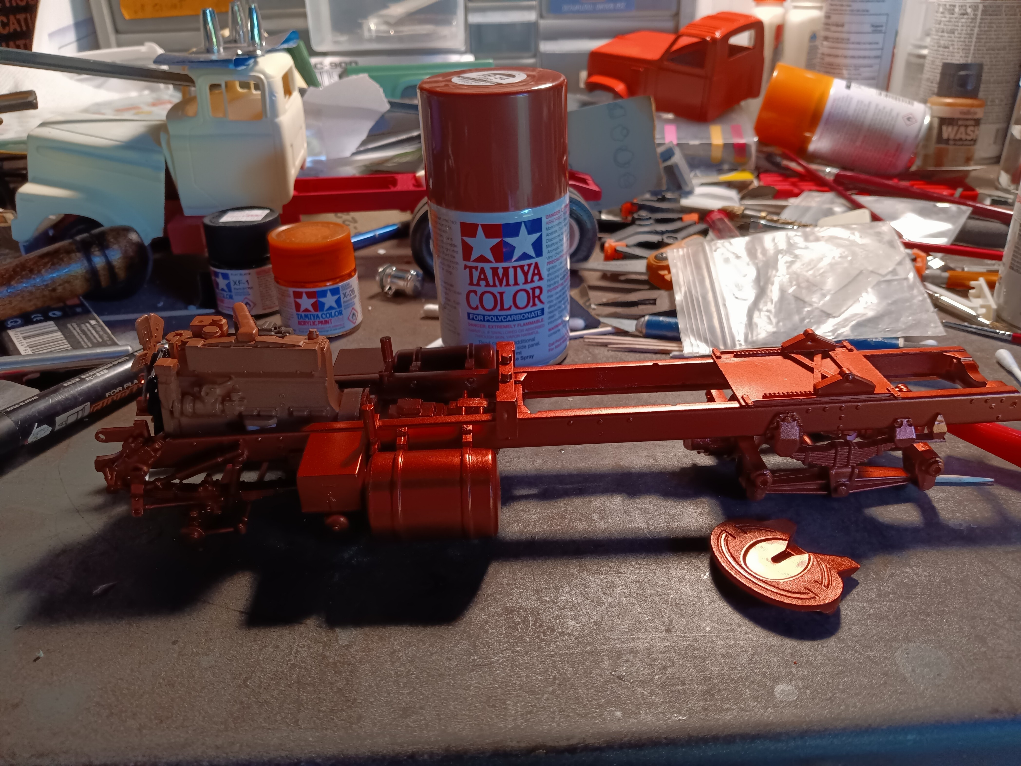

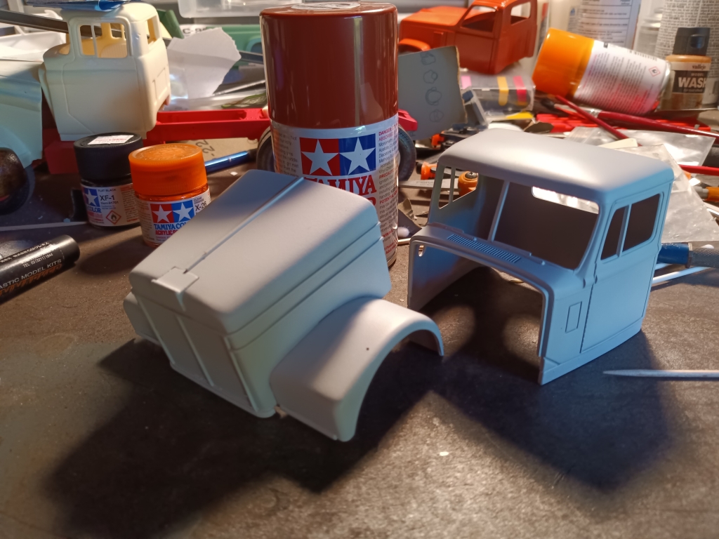

Chuck Most Posted May 31, 2024 Blast from the past! For many years, I've wanted to do a Minneapolis Moline dealer rig. Since White Motor Company owned both Minneapolis Moline and Reo, I thought why not make THIS that project? By the early 1960s, Minneapolis Moline tractors were painted in a combination of "Energy Yellow" and a rather unflattering (to me) bronze kinda color. I didn't want to find a color I wasn't fond of, so I opted for something similar but with a little more pop... Enter Tamiya Copper. The hood and cab are now slathered in Tamiya White Primer, in preparation of what will likely be Tamiya Camel Yellow. I bought these adhesive decals from Bossen Implement years ago. These will not only carry the theme, but enable me to work around the Reo letters and emblem problem... The larger MM letters will go on the hood sides. The White logo may end up on the radiator access panel. 1 Share this post Link to post Share on other sites

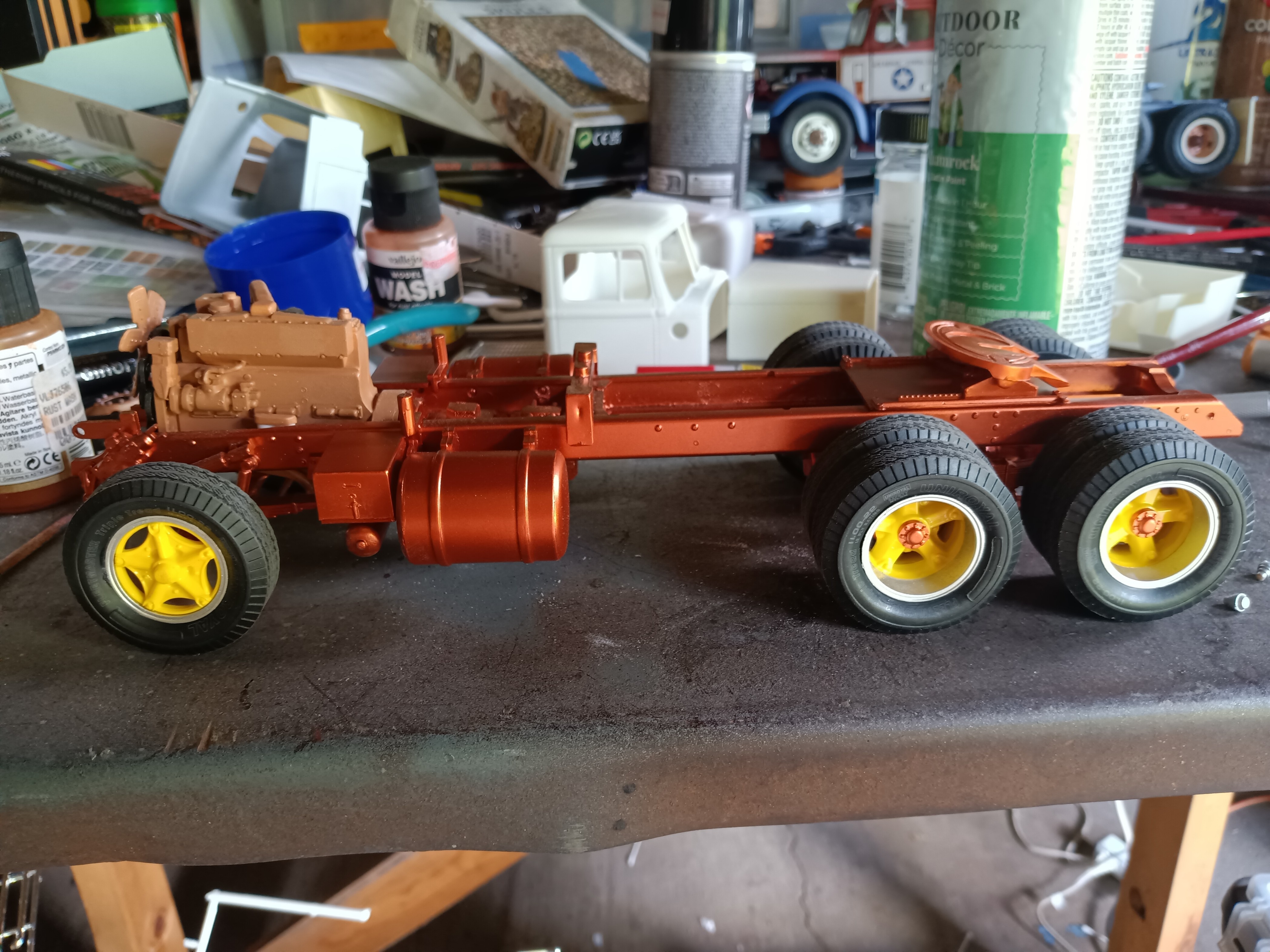

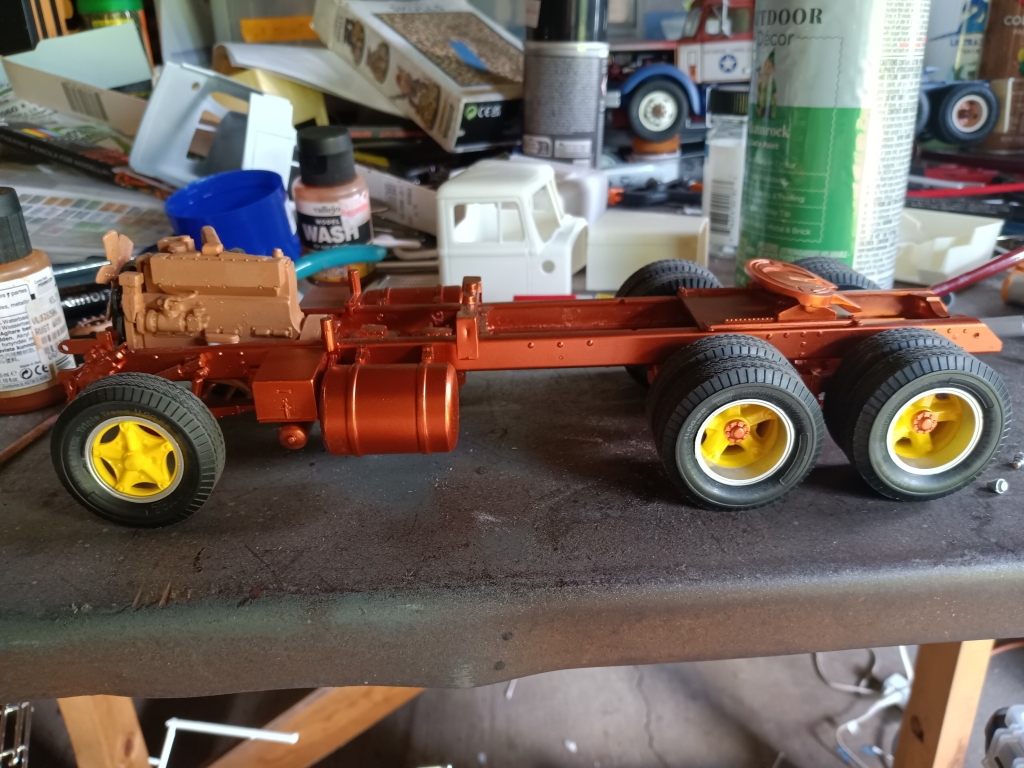

Chuck Most Posted June 13, 2024 Chassis has a few touches of yellow, and is now up on wheels. 2 Share this post Link to post Share on other sites

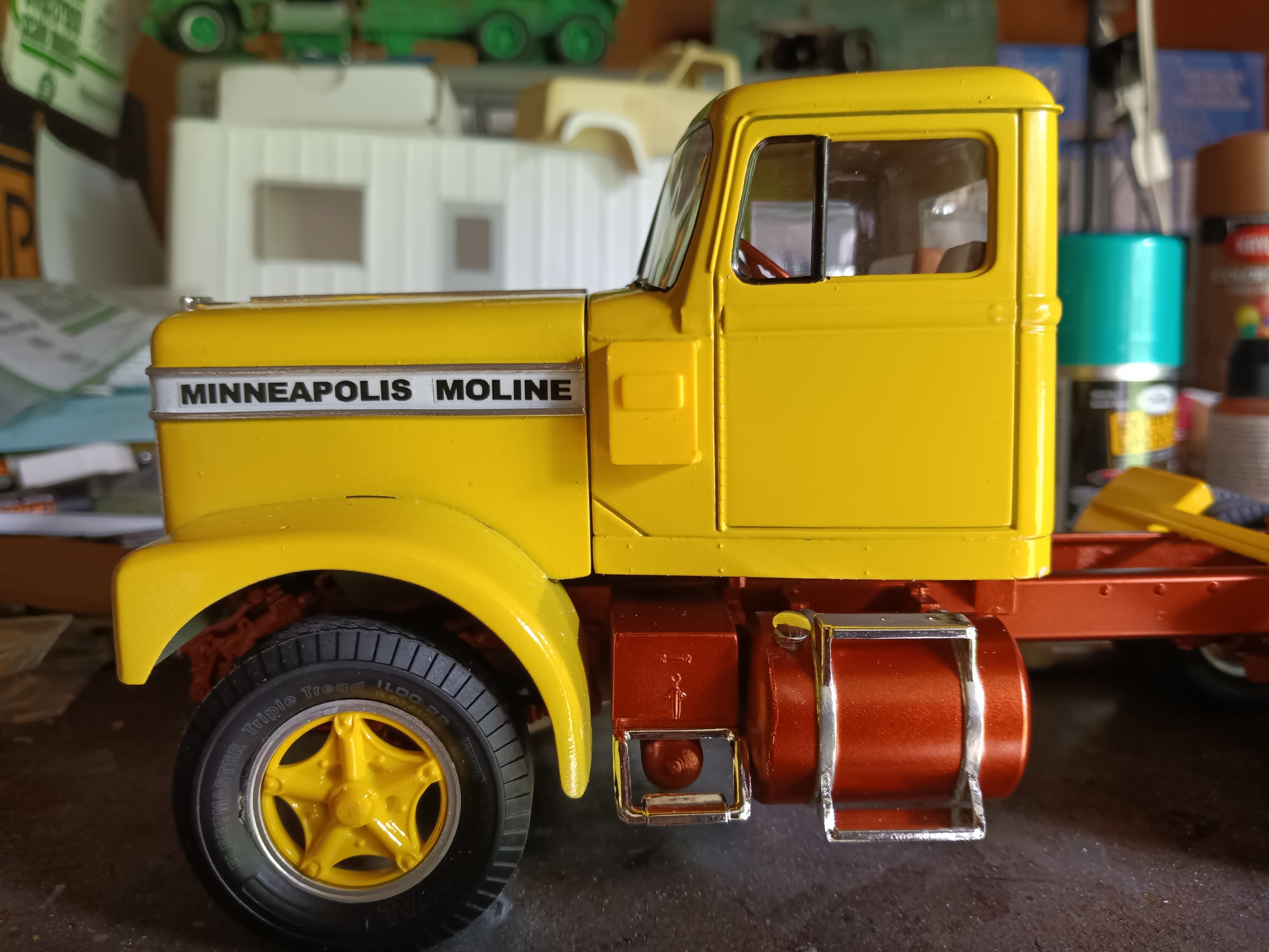

Chuck Most Posted June 16, 2024 Getting somewhere... 4 Share this post Link to post Share on other sites
Chuck Most Posted June 23, 2024 Straps and steps taken care of, and the cab is as aligned as it's going to get. 3 Share this post Link to post Share on other sites
